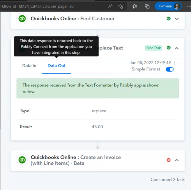

I had an issue where I was setting up QBO invoices from Jotform input being sent to Pabbly.

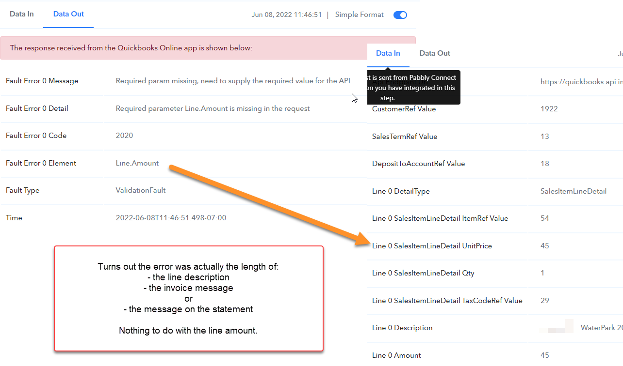

The error Pabbly was presenting to me was that the line amount was missing. Which was not true, the line amount showed on the data input screen.

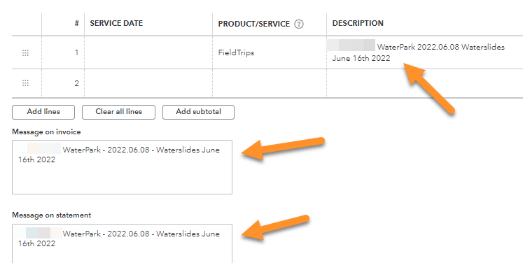

I eventually figured it out.. it is either the line description, or the message on the invoice, or the message on the statement being too long. All three are the same message in this case, and when I reduced the length of this line to less than 60 characters, then it worked fine... the LineAmount error disappeared.
So, just an FYI..error messages are not what they may seem to be.

I tried the source amount (excel) over and over thinking it was a format, etc. But nothing fixed it.
So I copied another line of the excel that did work, and then one by one played with each field.
In the end the only thing that fixed it was reducing the length of those 3 fields... description, memo, and statement note (private note on Pabbly).
It's working fun again as soon as I restricted the length to 60 characters or less, and that's without changing the step you mention above.
So it works again, and this was just an FYI for other users, in case they ran into the same issue.
