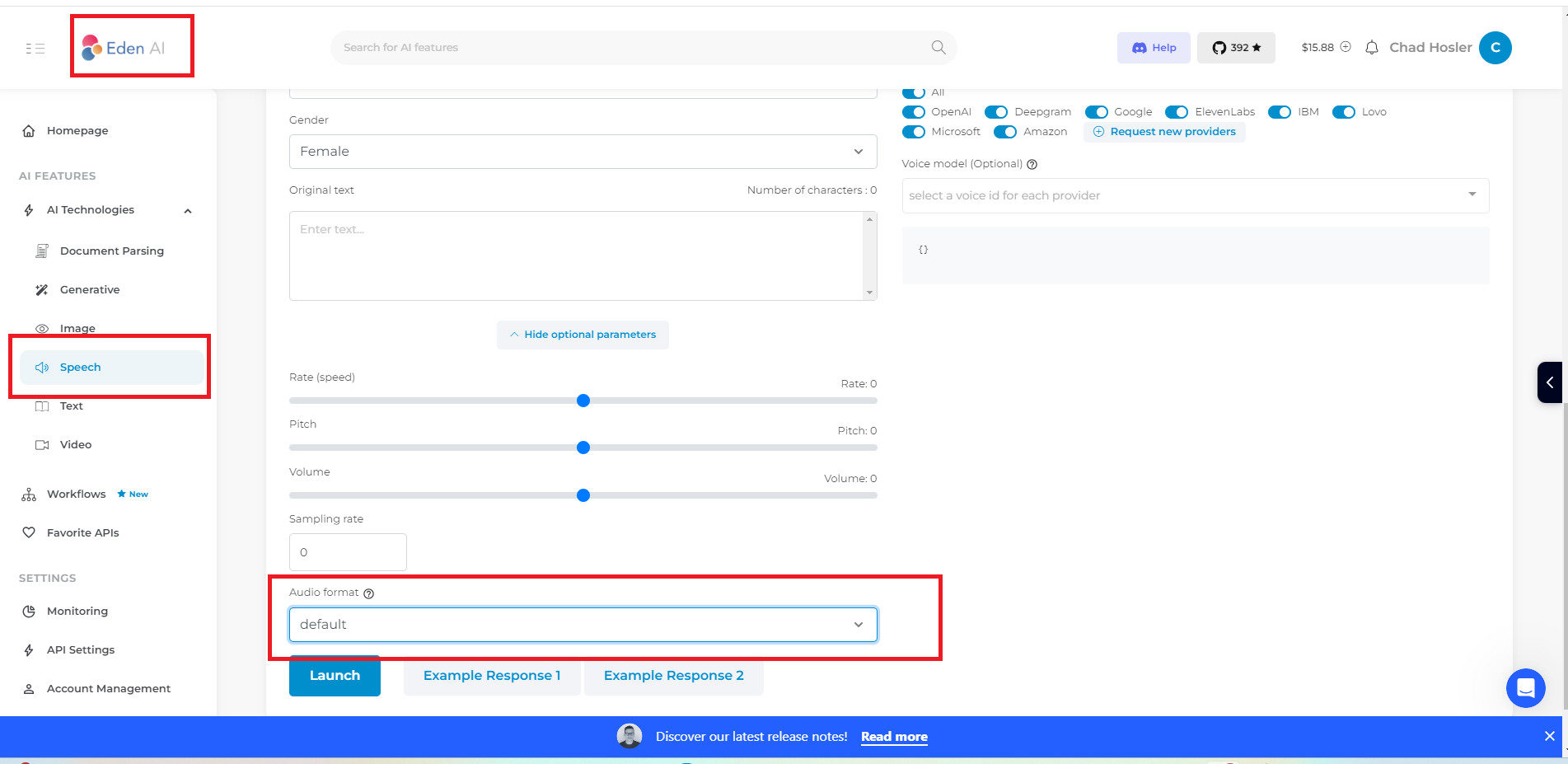

928chad
Subin,
As you can see from the attached snapshot I took within my EdenAI account, EdenAI offers many different audio file formats it can produce. However, in the text to speech automation choice in Pabbly Connect, no audio file output options are shown as choice. I'm not sure if that is because EdenAI restricts what it will output through it's API or what, but wanted to know if that could be programmed as a choice option.

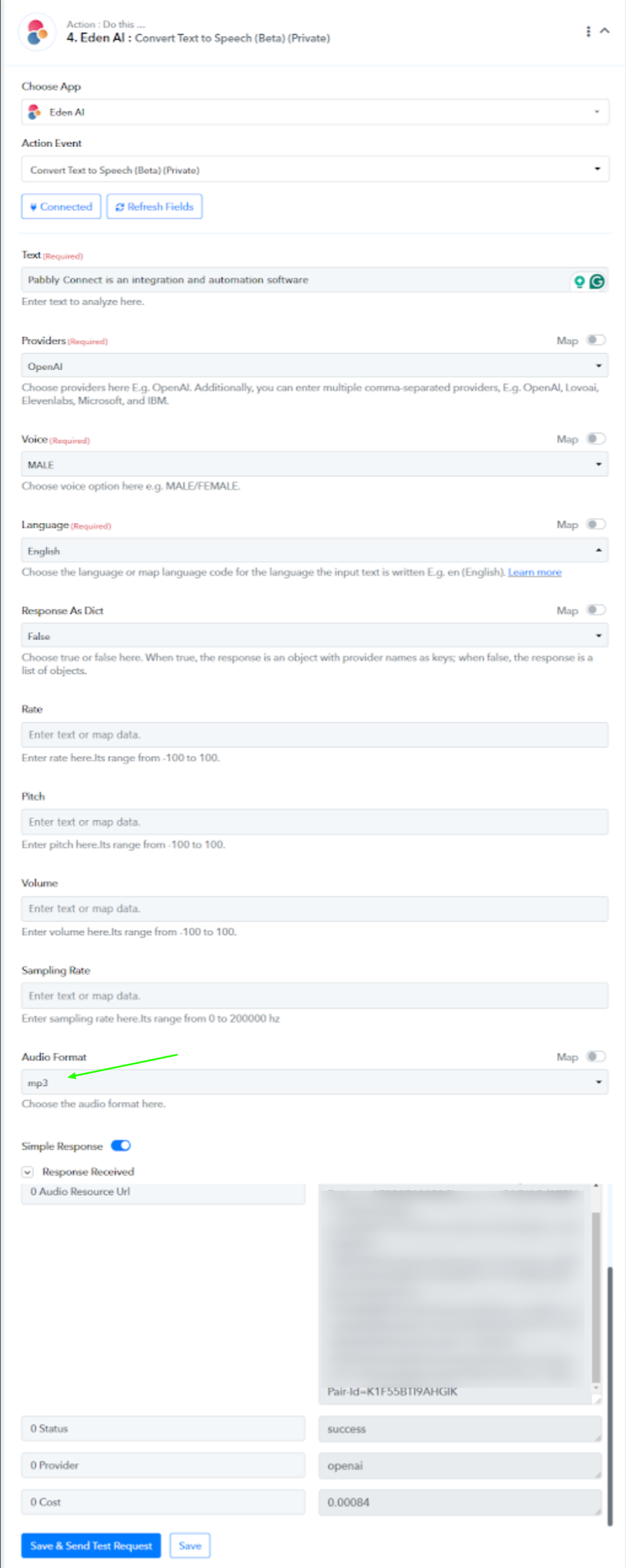

Hey @928chad !
Thanks for waiting.
We have added the option for Audio format to the action step now-
Kindly check at your end.

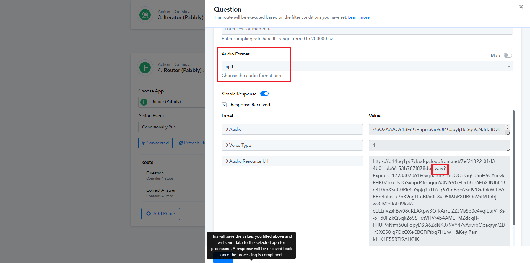

928chad
Hello Subin,
So happy that the pabbly support team was able to get this added. However, upon inspection, the output files are still being output as a wav file even though I have mp3 selected as the option I want. Back to the drawing board or probably just needs some additional code to provide the correct file link, right? See attached snapshot as my proof.
Hopefully, something can be done.
Thank you,
Chad

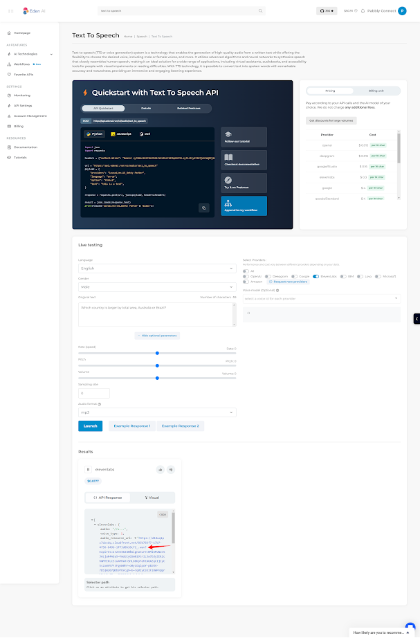

Subin
Hey @928chad !
Thanks for waiting.
We checked the concern with the tech team, and when checking it manually inside their Eden.AI account, they received a response wav for mp3 format.(attached below)
Kindly check once manually inside your account as well and see if the result is coming correctly or not.
Hope, to hear from you soon.
