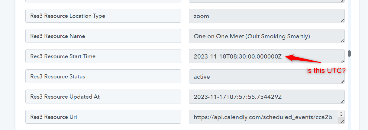

Please share the Workflow URL where you have set up Calendly as your trigger step. Also, state whether the meeting time captured in the Pabbly Trigger step is in UTC, your local time, or their local time.
If you haven't set up your workflow yet, please create a new one from scratch, set up Calendly as your trigger step, capture a new meeting, and check the time zone in which the meeting time is captured.
tycoon1962
Hello Arshil,
The workflow is shared. However, I have used TidyCal to book the meeting. https://tidycal.com/sundeepvaish/for-pabbly
Res1 Starts At, Res1 Ends At, Res1 Created At, are captured in UTC.
Since everything takes place in India, I'm not sure what time zone the form will be captured in if it is filled from a different time zone.

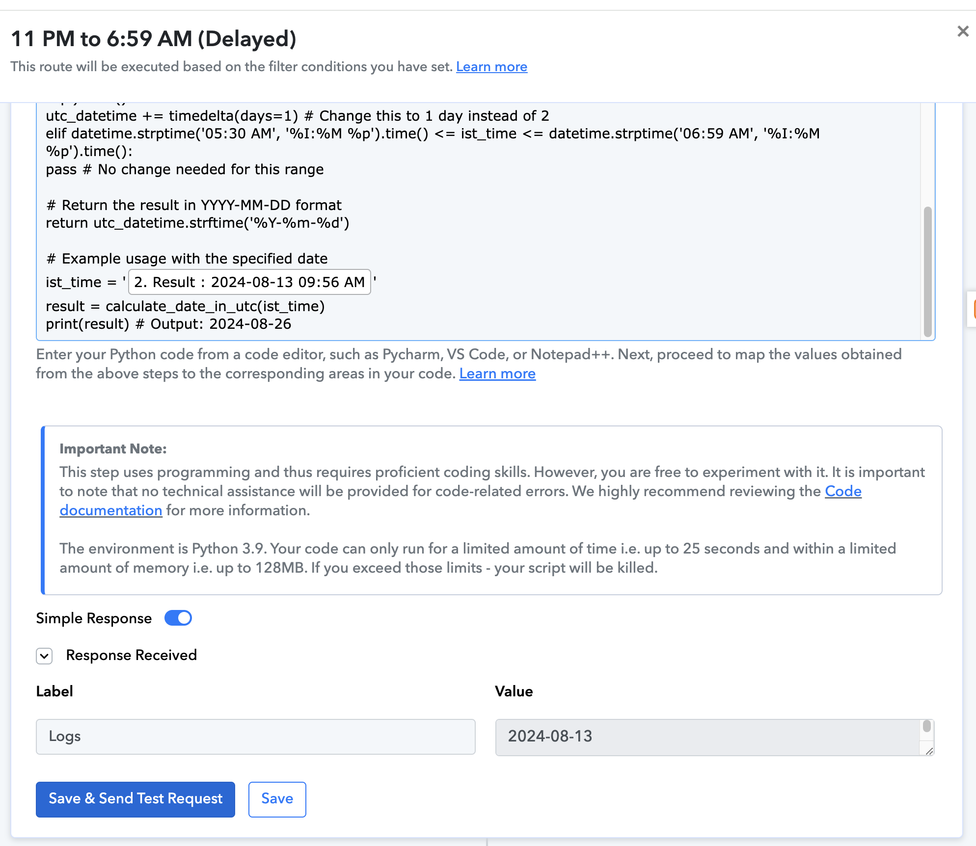

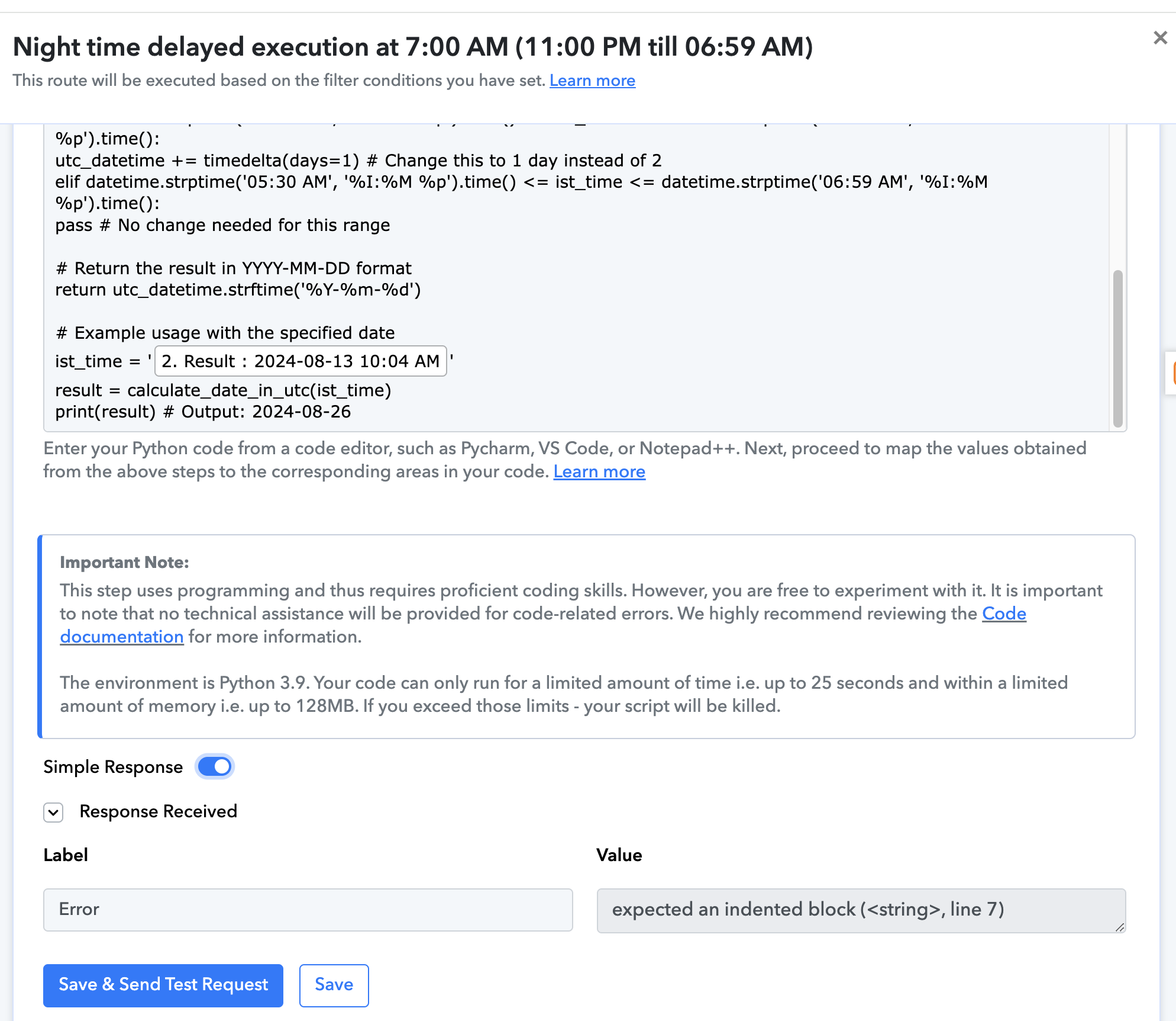

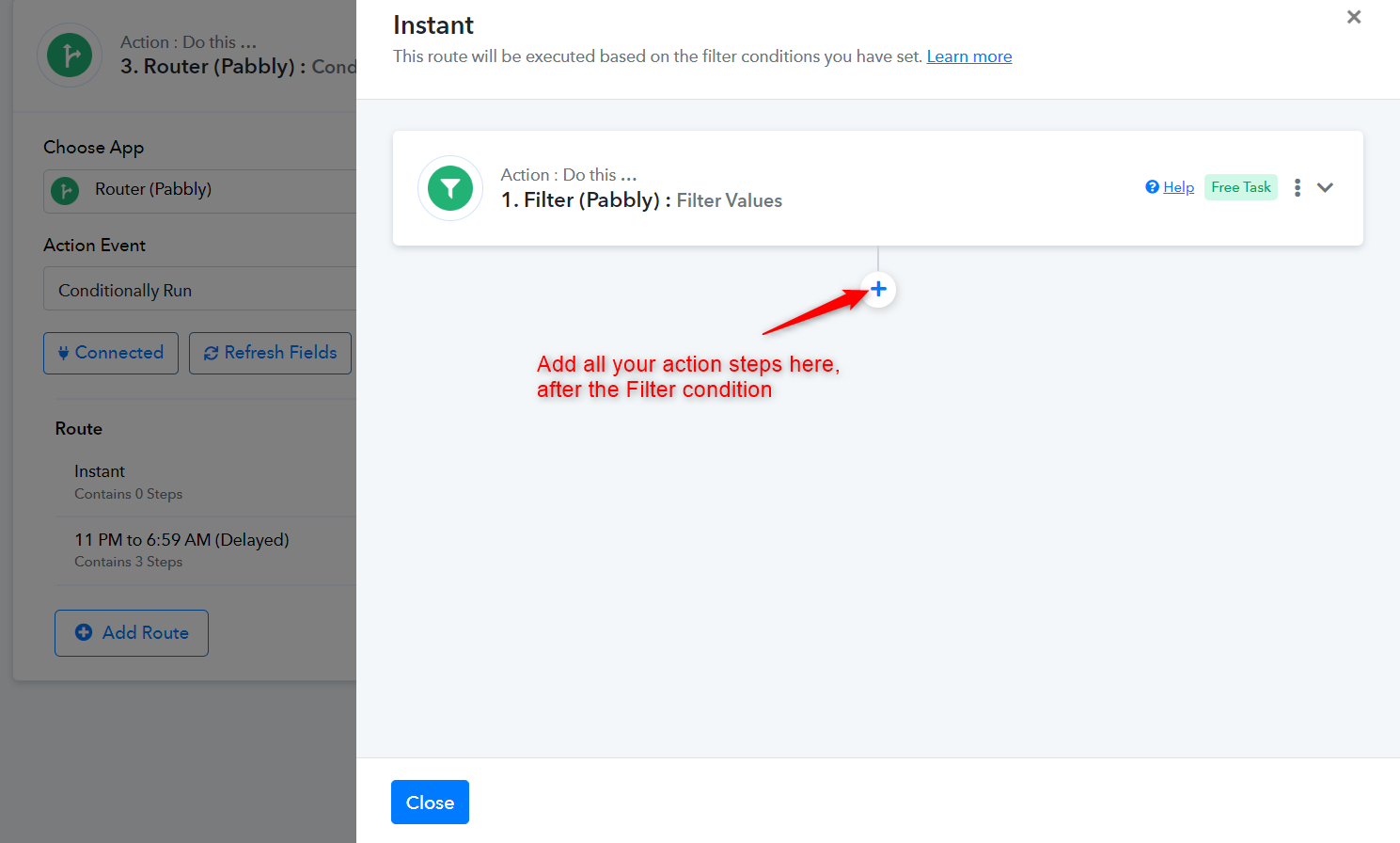

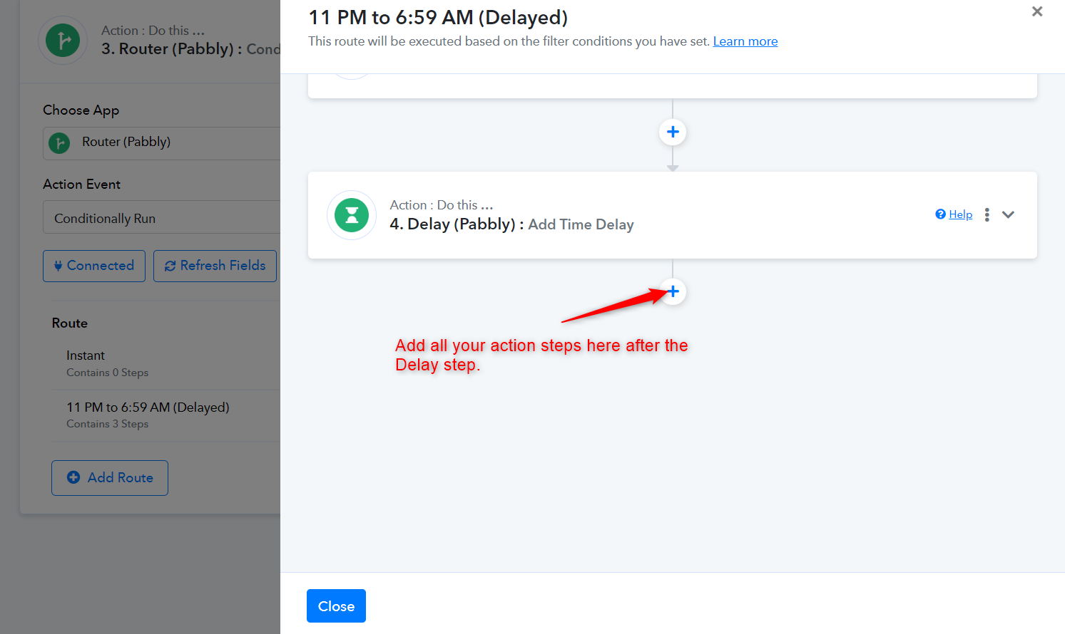

You can setup your workflow in this manner to achieve your use case:
In Route 1:
In Route 2:
Other than the trigger step, kindly avoid making any changes to the Router conditions, Code, Delay, or Date/Time Formatters while testing.
Python:
from datetime import datetime, timedelta
def calculate_date_in_utc(ist_datetime_str):
    # Parse the input datetime string in IST
    ist_datetime = datetime.strptime(ist_datetime_str, '%Y-%m-%d %I:%M %p')
    # Convert IST to UTC by subtracting 5 hours and 30 minutes
    utc_datetime = ist_datetime - timedelta(hours=5, minutes=30)
    # Get the time component in IST to determine the condition
    ist_time = ist_datetime.time()
    # Check conditions and adjust UTC date
    if datetime.strptime('11:00 PM', '%I:%M %p').time() <= ist_time <= datetime.strptime('11:59 PM', '%I:%M %p').time():
        utc_datetime += timedelta(days=1)
    elif datetime.strptime('12:00 AM', '%I:%M %p').time() <= ist_time <= datetime.strptime('05:29 AM', '%I:%M %p').time():
        utc_datetime += timedelta(days=1)  # Change this to 1 day instead of 2
    elif datetime.strptime('05:30 AM', '%I:%M %p').time() <= ist_time <= datetime.strptime('06:59 AM', '%I:%M %p').time():
        pass  # No change needed for this range
    # Return the result in YYYY-MM-DD format
    return utc_datetime.strftime('%Y-%m-%d')
# Example usage with the specified date
ist_time = '2024-08-25 11:30 PM'
result = calculate_date_in_utc(ist_time)
print(result)  # Output: 2024-08-26
