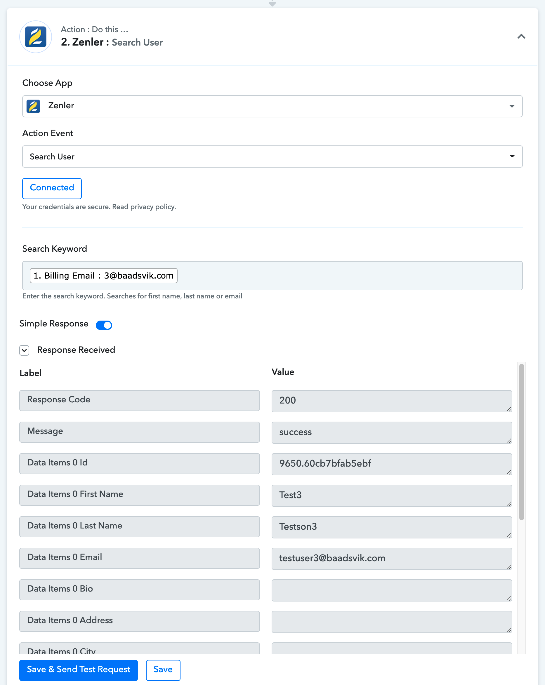

According to Pabbly official support video on YouTube, I've implemented a workflow that assigns a Zenler course to a new or existing student.
The workflow uses a search keyword function to identify if the student is already existing. This seems to be a flawed method since it can return more than one hit.
For example, when searching for the email ([email hidden]) as a keyword it will return both these email addresses: [email hidden] as well as [email hidden]
Any solutions to this?

Did you try to fire the search request through the Pabbly Connect integrated Search User Action Event?
As far as I know it is meant to search the exact user email. If it is giving you multiple results on the search through the API, I would recommend you to get in touch with the Zenler team once and ask which Zenler API can be used to search the exact user email that does not return results for any other related emails.

Hello and thanks for fast reply.
Yes, I did follow the instructions in the video you refer to.
I am using the exact same procedure except I'm using WooCommerce. However, as you can see in the below screenshot, the search is obviously not searching for the exact email address, but rather it seems to return the first user with an email address that contains the search phrase. A search for email: [email hidden] returns [email hidden].
It might very well be an issue with the Zenler API as you say, but nevertheless, until this is corrected it renders the method as described in the video useless.
Since I'm not very experienced with API, is it possible for you to reach out to Zenler for a fix? You are probably more qualified to ask the right questions.

Thanks for sharing the screenshot.
We will also email them from our end.
At the same time being a Zenler customer, can you also ask them if there is a way to search a user by exact email and not return any results that does not correspond to the exact match through the API?
Even if they give you some link to do an exact search, it will be helpful.

Reply from Zenler:
"Currently, the search works in this way.
It searches for users whose name/last name/email contains the search keyword.
We will forward the suggestion to the tech team.
Currently no other alternative."

I don't have zenler access so I have not tried this, but here is a workaround I can think of.
Get search results from zenler with simple response toggled off in pabbly connect. Then use iterator to convert it to a single item.
Then use Number formatted -> Spreadsheet formula -> Exact(text1,text2) formula to check it it matches exactly or not.
Then setup filter which only go on if valued is true for Exact formula.
Thena dd your rest of action steps.

you're on to something! I'm stuck at formula though. I don't get the "Valued" option for the formula when creating the filter.

I think I've got a working solution now. Thanks a lot for your input @Fagun Shah!
