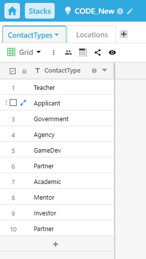

Here is the Stackby table set up as an example. I'd like to search a record for the row containing, say "Applicant".

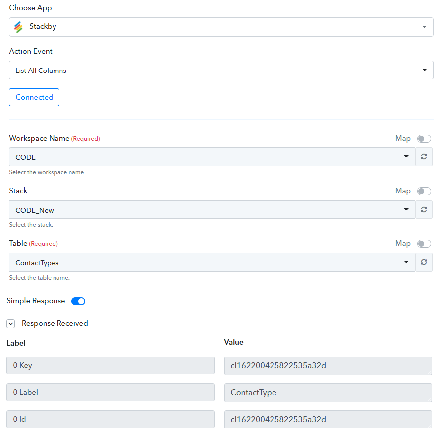

Below I query Stackby using the List Columns action:

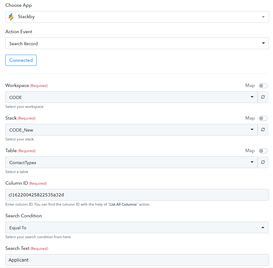

Then I use the Search Record action in Pabbly to find a record in this column (I just used the text string "Applicant" rather than any earlier input just for this example). I also tried "Contains" as well as "Is Equal To" with as simpler string. In any case, here is the set up for the Search Record using the column ID from above.

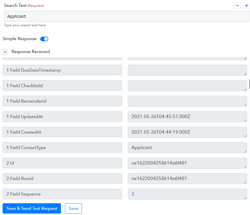

And the result is:
You can see Applicant in the result, but in fact the result is just a list of all the records in the table. This result is produced whatever you search for - whether it is in that column or not.

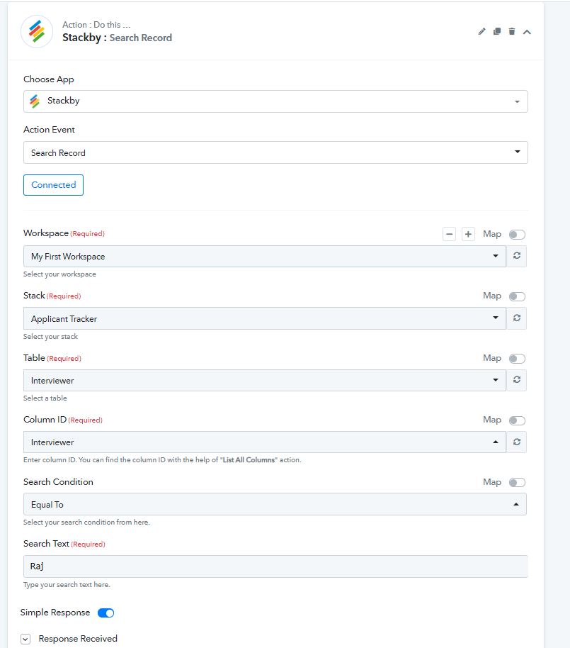

Just to let you know, the dropdown always brings in the column names of the first table in your Stack, even if you refresh which is not expected behaviour. But since you can manually enter the correct column name, this makes no real difference :cool: so nothing further needs fixing. Thank you!
Wrong column names for the Entities Table...
...But makes no difference if you enter the correct column name manually - it works as expected in this case :)
Thanks again
