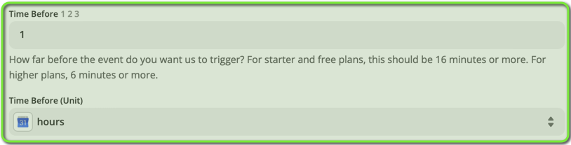

The Time Before option does not exist on Pabbly. That means I have to create a task to subtract an hour, and another task to add a delay. +2 tasks.

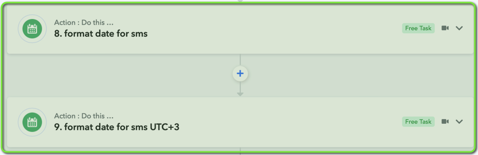

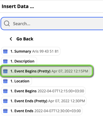

The Pretty option does not exist on Pabbly. That means I have to create a task to format the date the way I want it to appear in the sms. +1 task.
Even though Pabbly picks up the event start time from google calendar in its correct format, it converts it to UTC+0. That means I have to create an additional task to add 3 hours (UTC+3) +1 task

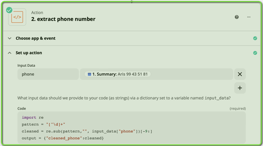

No obvious way to run javascript or python code. That means I have to create a task to remove spaces from summary and other task to extract the phone number. + 2 tasks

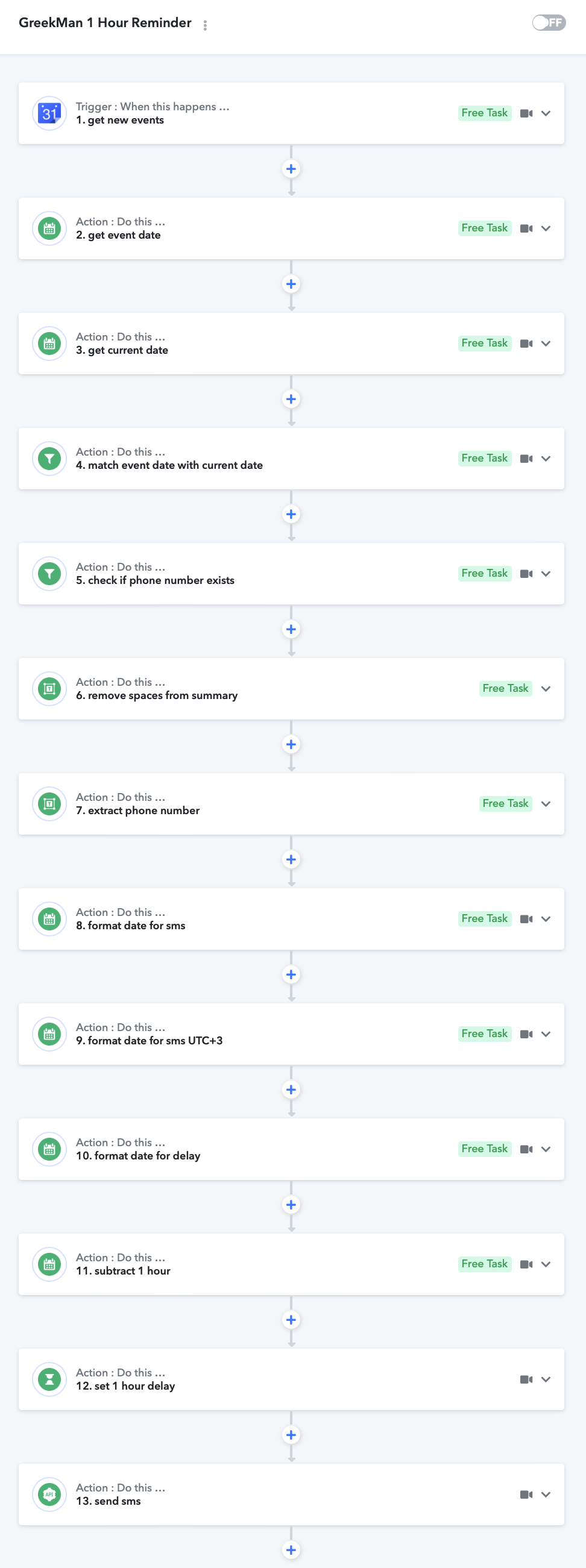

- In Pabbly, it took 13 tasks to send an sms reminder 1 hour before a google calendar event.

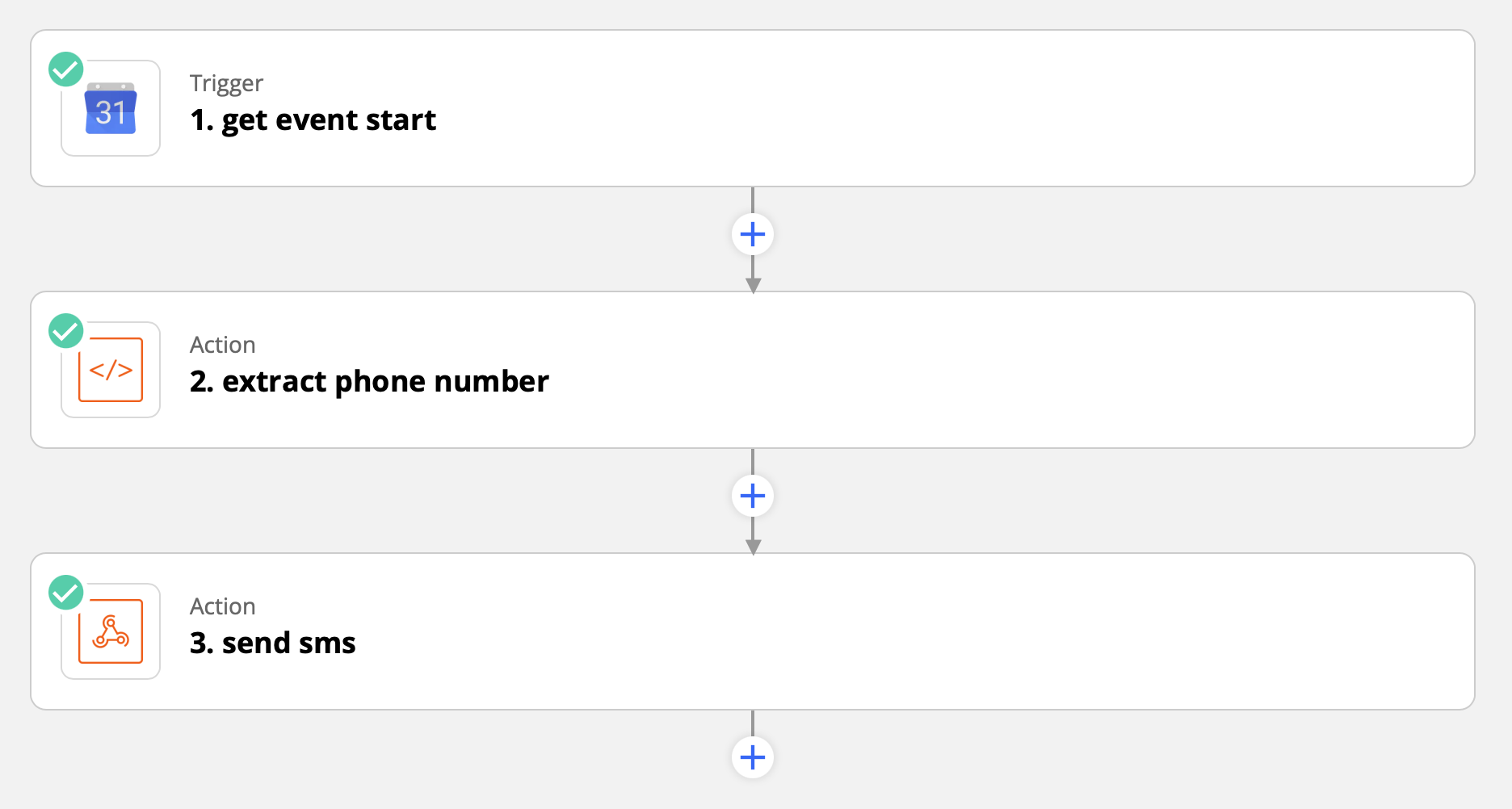

- In Zapier it took 3 steps to perform the exact same task.

For custom code run of JS and python check this - Check this -
