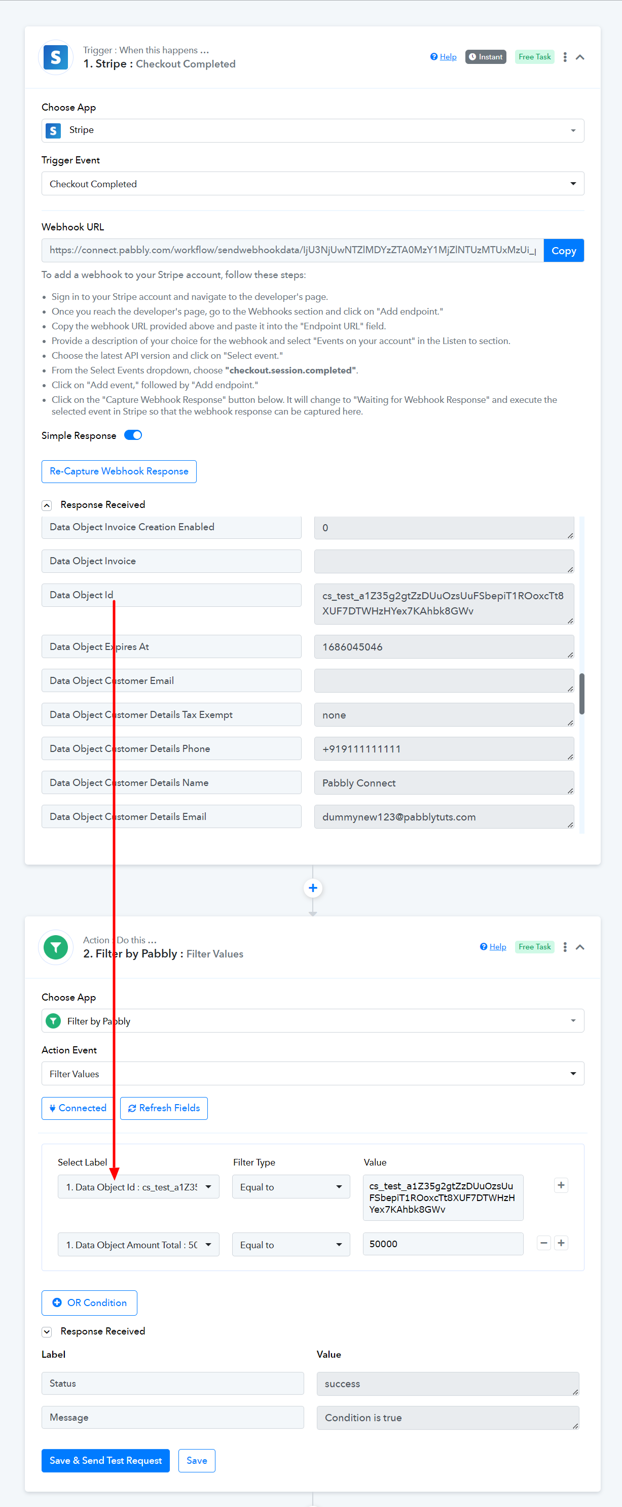

I want to set up an automation where after a specific stripe payment link is used a (new) subscriber gets added to a specific group on mailerlite (& an automation starts).
How do I filter this specific product payment link with pabbly?

In order to achieve this use case, you can add a Filter as the second step in your workflow. You need to set the filter conditions based on the Data Object Id and Data Object Amount Total. This will ensure that the 'Mailerlite' action step gets executed only if the payment is made for the specified product and for the specified amount in the Filter step.
Watch the video shared below to setup Stripe as your trigger application. Only the first half is relevant for your use case.
