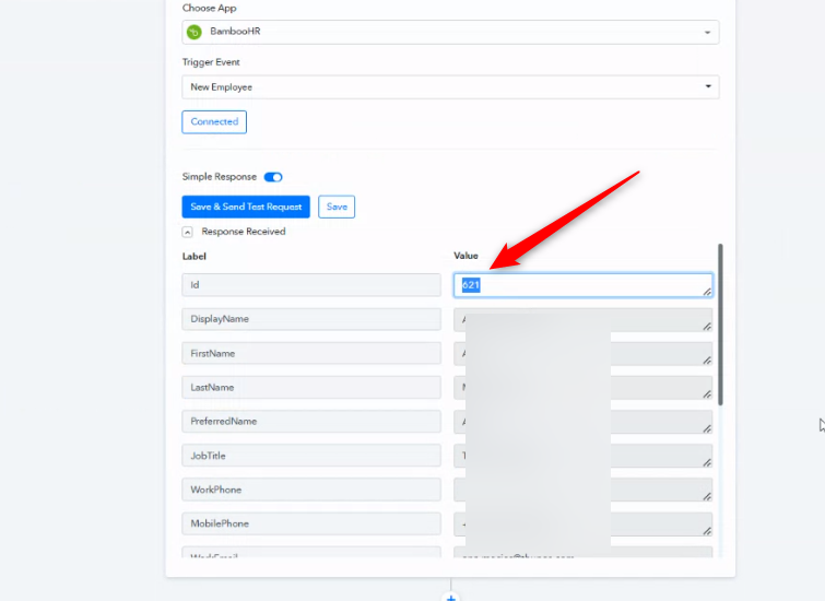

Hey @Jerome
You are already getting the Employee Id in your Trigger response as Id.
Kindly check this once.

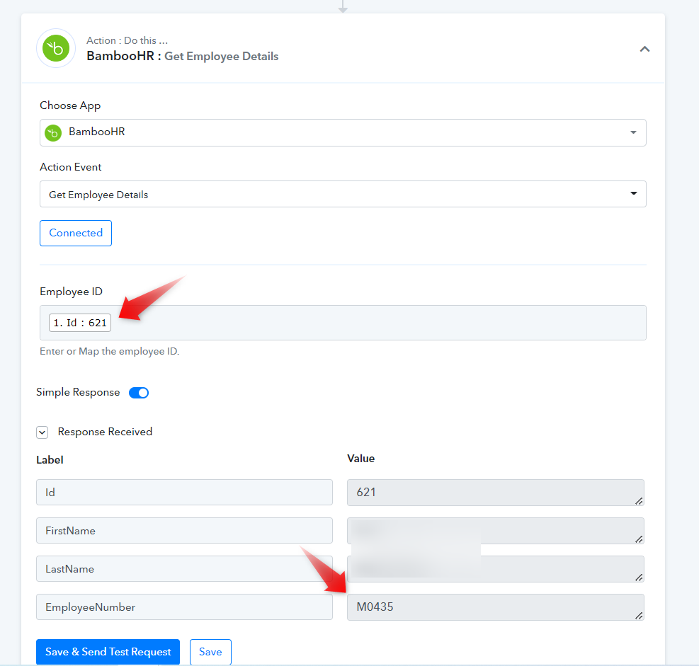

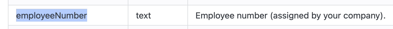

Jerome
I found the field name ... this is what i want .. Employee Number, not ID

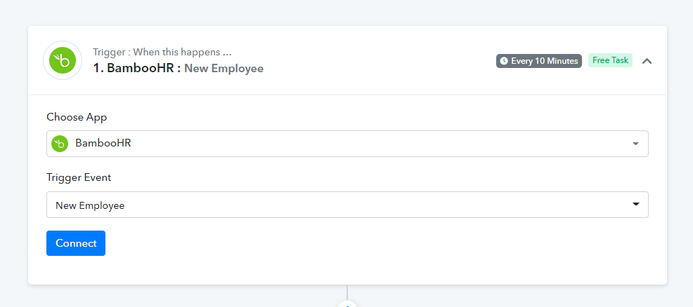

(1) Action gets triggered in BambooHR when there's a new employee added
You can use the following trigger event for your concern.
(2) Action to perform > Checks if new employee's Employee Number exists. IF not, send employee's selected attributes to database in https://baserow.io. IF exists, updates database.
You can use the Router action step for your work where you can make the condition to add or update the employee accordingly.
Further, if their application's rest API is available then you can build the action event with the help of API by Pabbly.

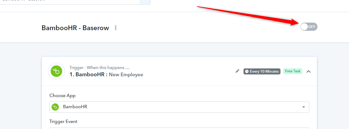

I created this Workflow > BambooHR - Baserow
Individually it works, but it's not triggered when a new employee is created in BambooHR.
Can you check and advise ?

Supreme
Hey @Jerome
Could you please tell us that while trying out your workflow is switched on?
As we can see your workflow is in switched-off condition, kindly switch it on and then try again.
