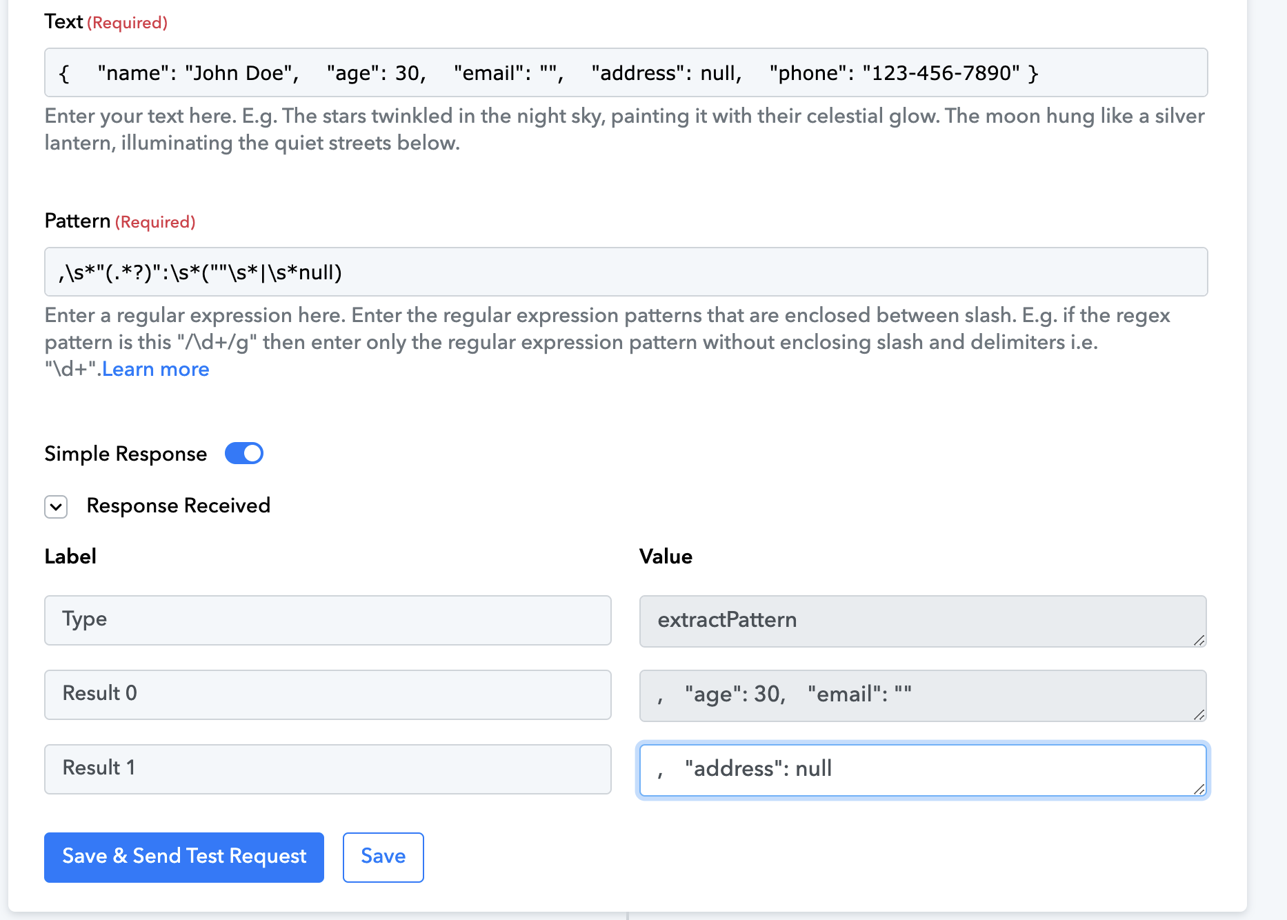

I tried using the regex replace text formatter here and have issues:

Thanks ArshilAhmad. I got your code to work :) The only issue is that "None" is not text I need to remove. I need to remove "null" but Null can't be removed it seems (even if I replace None with null in the script it errors).
But I don't need that part working for now. So this is great for now! 🙏
