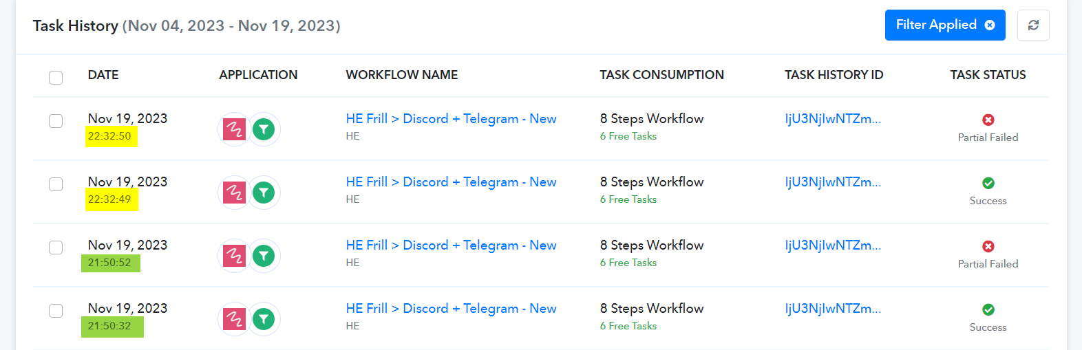

I got this error when I send the message to Telegram bot. There are 3-4s between actions but still...
Please help.
"ok": false,
"error_code": 429,
"description": "Too Many Requests: retry after 290",
"parameters > retry_after": 290

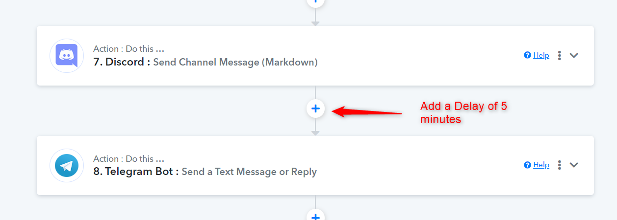

Hi @JOY,
The issue appears to be related to the execution of your workflow at very short intervals, which resulted in the Telegram API being executed at very short intervals, leading to the error you encountered.
I suggest that you add a Delay to your workflow, as this should help you resolve the issue.
I also suggest that you enable the Auto Re-Execution feature, which should help you automatically re-execute any failed tasks.
