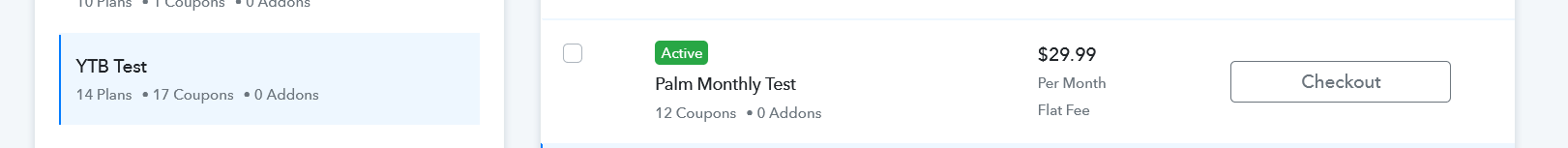

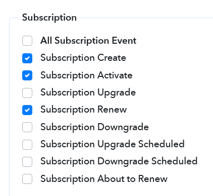

As you can see in the screenshot I have selected the subscription activate event. In my product, there is a YTB Test and I have used Palm monthly test plan and plan code is palm-monthly-test.

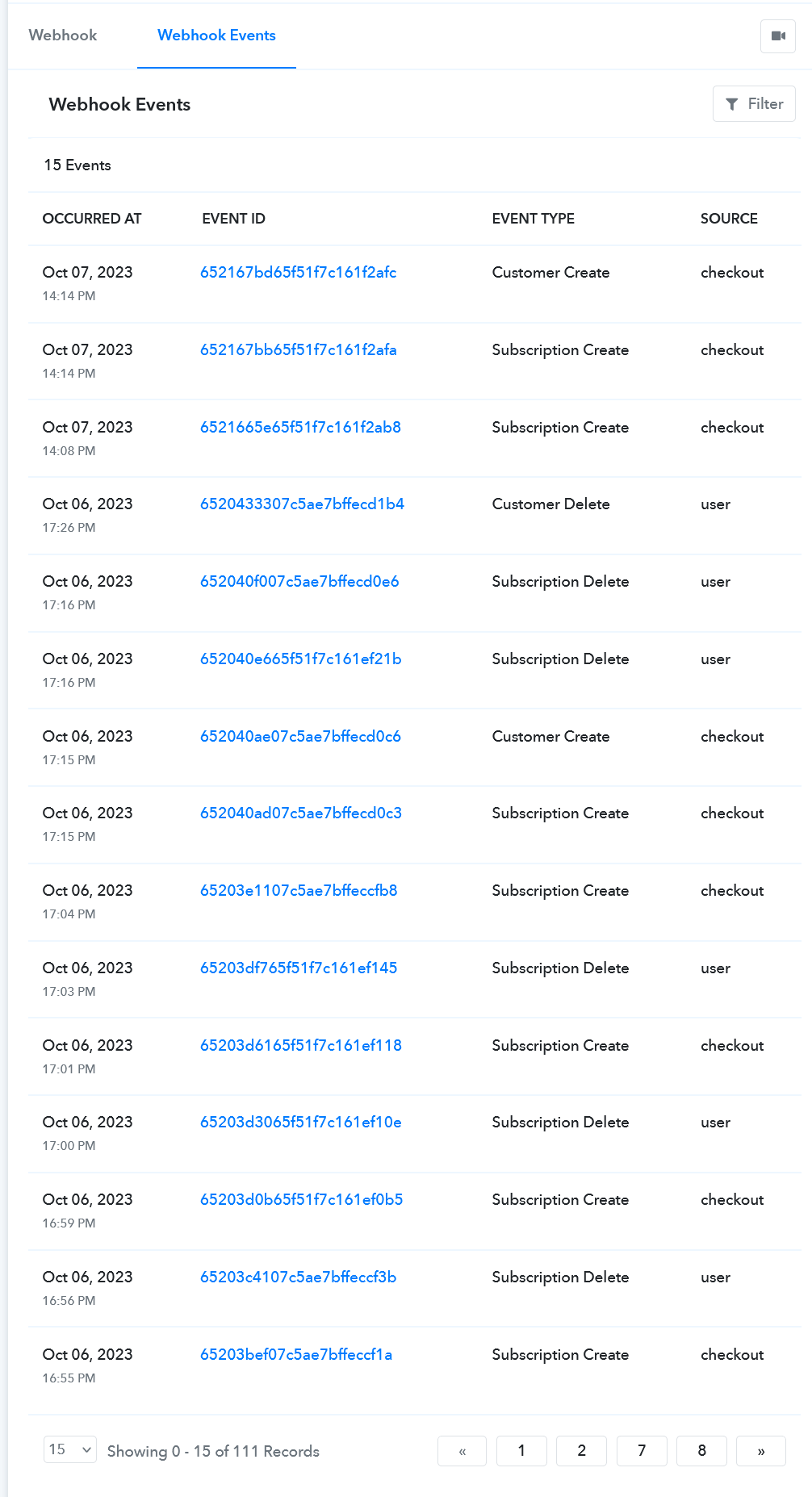

In the webhook only subscription create event is present, no activate event is present as shown in the screenshot below

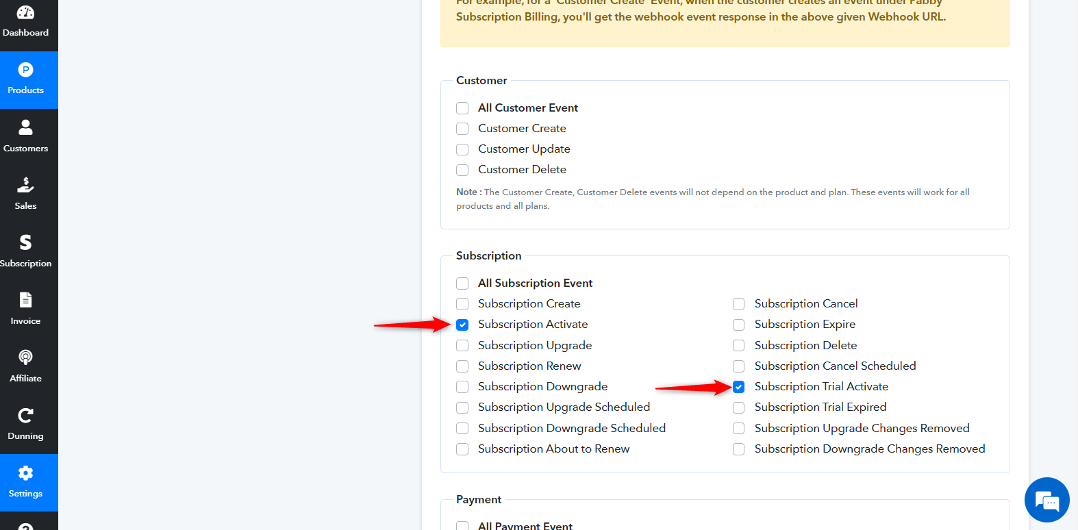

We've noticed that your plan includes a trial period. As a result, the 'subscription activate' webhook will only trigger once the trial period is expired/over. To receive details at the beginning of the Subscription Trial Period, you'll need to set up the webhook for 'Subscription Trial Activate'. Please refer to the below screenshot for more details
In our latest PSB update, we've introduced this functionality. With this enhancement, you can now receive notifications both at the start of a subscription's trial period and when the actual subscription starts separately. This is the reason why your existing webhook are not working. Requesting you to please update the webhook trigger according to the latest update.
