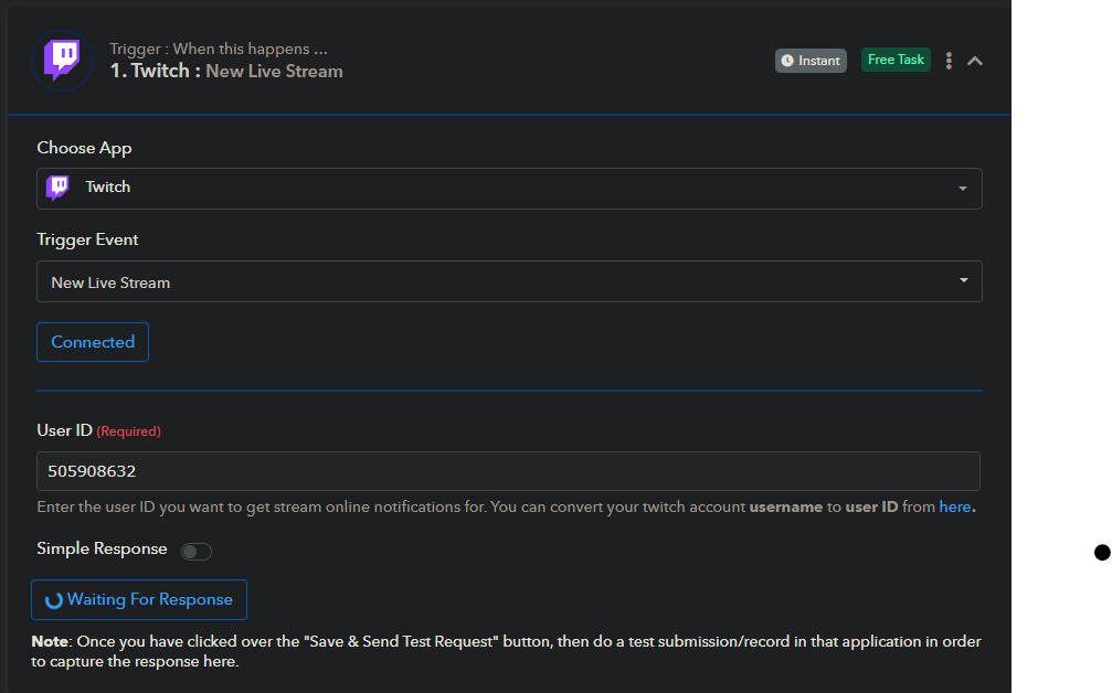

Hi there,
i want to create a workflow that triggers an action when a twitch live stream started, so i set up all the steps and created the twitch connection with client id and secret.
After setting everything up i clicked on "Save & Send Test Request" and started a livestream on the provided user id account - but it always says "Waiting for Response"

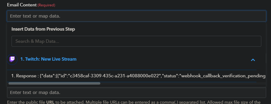

If i try to choose an action with "Insert Data from Previous Step" it always gets
"status":"webhook_callback_verification_pending"
So why is the trigger getting no response? I stopped and started the livestream multiple times and waiting a couple a time...

As i said, i configured the workflow like this:
So now it is waiting for a response (start the livestream) so i started the livestream on the given user id and waited a few minutes.
Then i wanted to add an action - for example sending a mail over gmail - but i do not get any information and it does not seem that the trigger was called:
