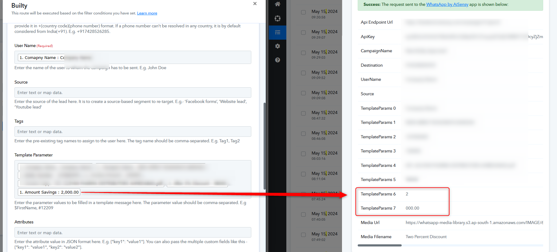

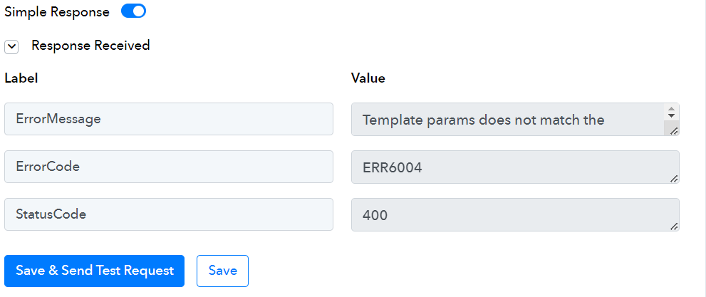

I have already built a workflow previously. Which is sending Template Messages on the Drop Down Basis from Google Sheets. From Yesterday onwords it is unable to send the messages. i havre already create a new template and also capture new response for testing. But i am getting this error. I have already check all parameters all are same. Even the Template is also Approved.

Because as per the action step if you pass the map data in commas then it will consider as custom fields. In your case you are passing the amount number with comma.
And in execution you are passing the multiple value in comma separately, so it's getting multiple custom fields.

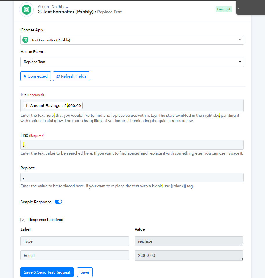

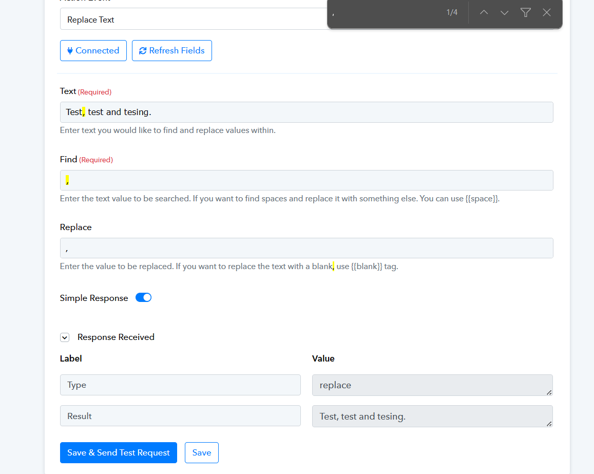

We have a workaround related to your concern where we have found a lookalike of a comma symbol which you can use to replace in your string.
Single Low-9 Quotation Mark (‚): This character resembles a comma but is oriented differently.

Please note that the comma in your amount field is causing issues by treating the subsequent text as a parameter. As a solution, I suggest replacing it with a similar-looking character that will not interfere with the input parameters.
Though I have set the action step in your workflow at the second step now you need to pass its response to your Aisensy action step.
