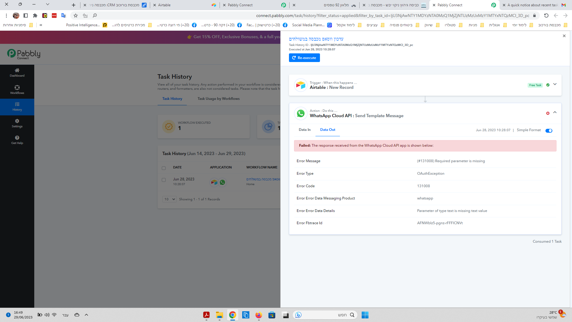

Every few requests, the system gives me an error that I don't understand how to fix so that WEBOOK will work properly without me having to go in and refresh every so often

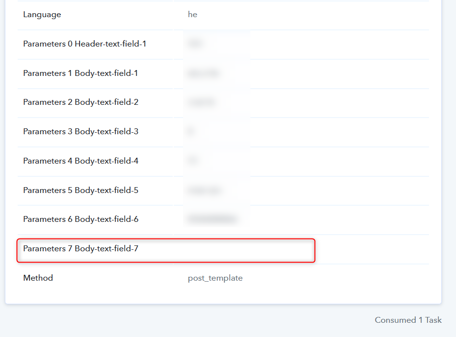

Talking about WHATSAPP API updates attach a picture
Thanks for the helpers
In the "WhatsApp Cloud API" action step if the template field is required. If you leave the template field empty, your messages may not be delivered. Whereas we can see that in automation you have missed passing the 8th field from your WhatsApp Cloud API.
And I added in line 8 that there will always be a parameter there so that the line will not be empty

Hey @eliran115
In the WhatsApp Cloud API action step, passing data in all fields is necessary. If you are to get the data for all the fields, kindly remove that field or use the "Default Value" action step, which will pass random data if that field data didn't come in automation.
