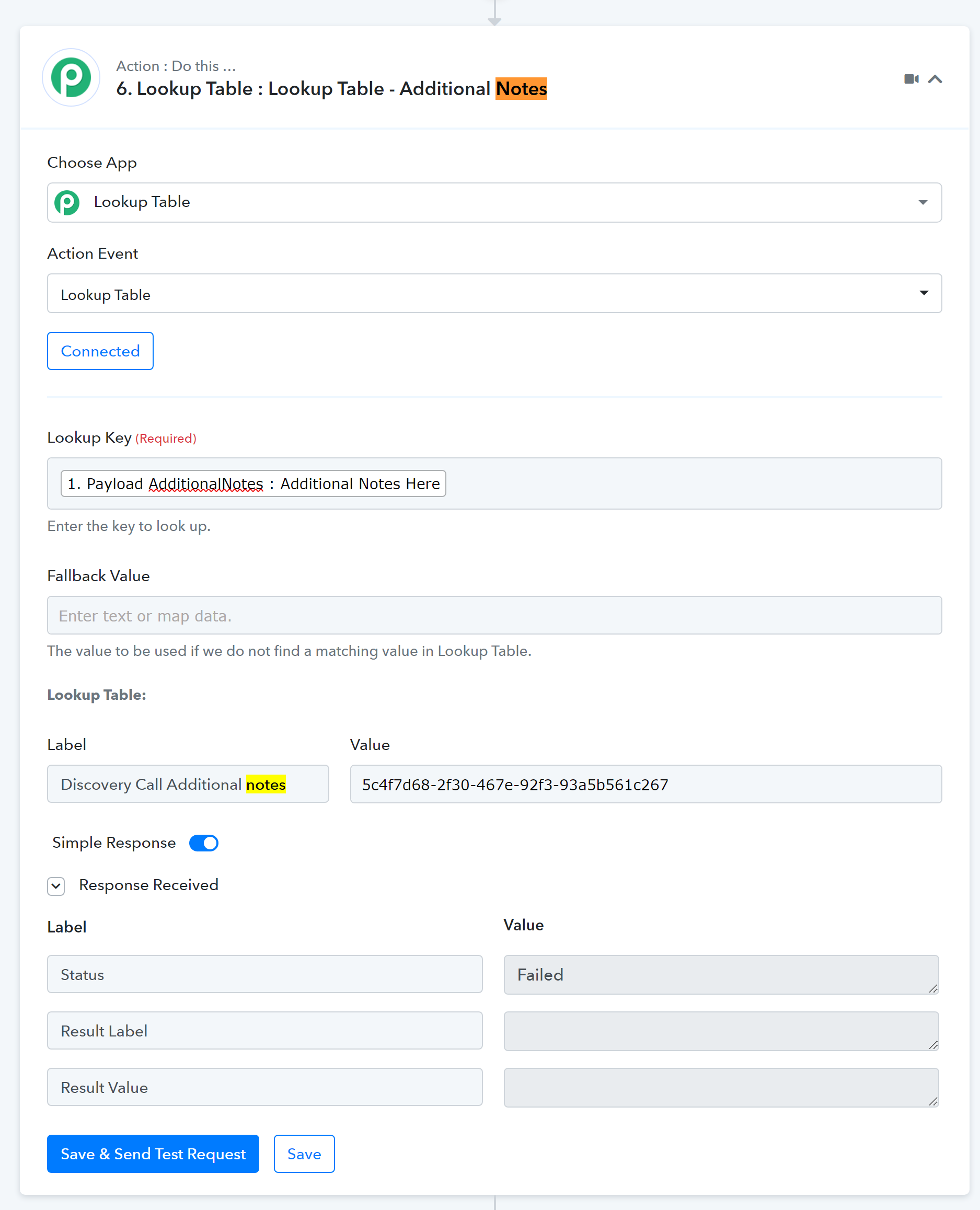

Only field 11, discovery call additional notes won't populate as I get the same error "Value must be an option index or uuid / FIELD_011" - I tried the lookup solution and it failed.
Please assist with that also.
Thank you

Thank you Supreme. The video was silent, hence my questions. I'm still unclear how to solve this. I tried to map the Additional Notes field to the lookup table (Step 6) but I still get this error.

Thanks @Supreme - The "Discovery Call Additional Notes" field is not a dropdown, it's a free text field and I just want to pass whatever is entered on the form, to my corresponding field in Click Up. Is Lookup table still the same solution?
I watched the video but II can't see how this solves the issue?
Hey @SkyeFWP
Since the dropdown fields need to be configured with the help of the Lookup Table action step as mentioned earlier. For individual dropdown fields, you need to set the Lookup table separately.
Further, to the text type field, you can send the data directly.
