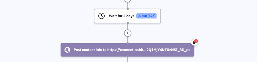

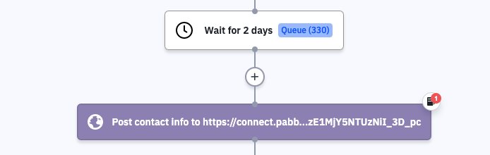

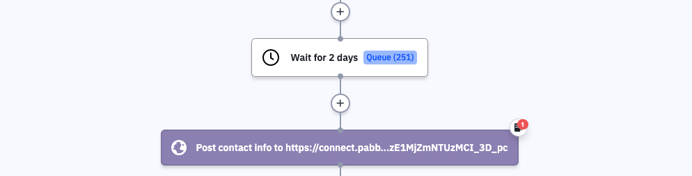

These triggers all happen at the same time (for example 8.00 pm), so 251+498+330 at the same time. This is the problem I think.

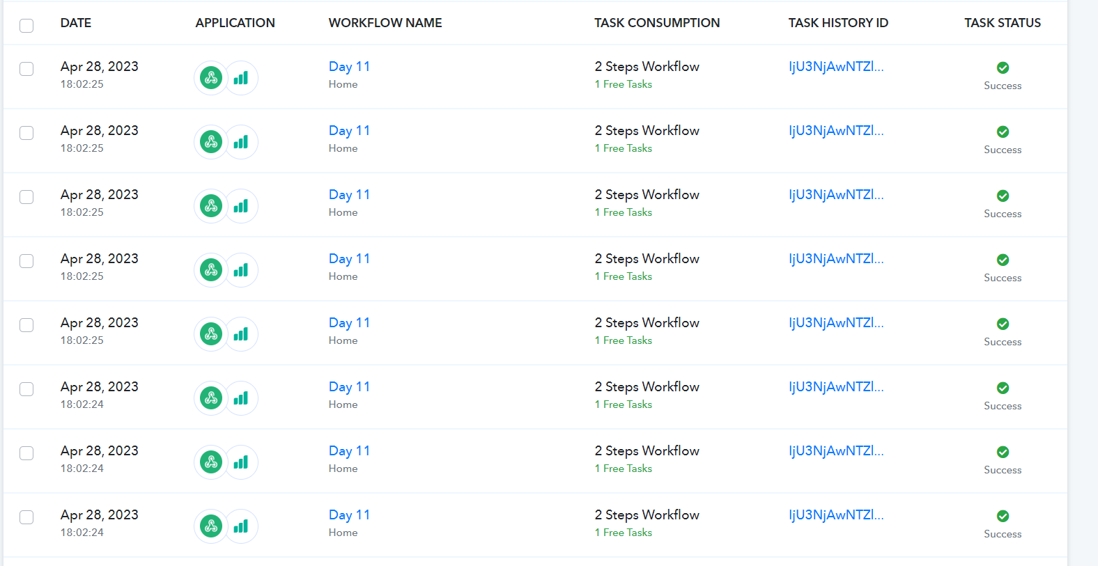

Any workflow have the same errors, for example:
Hey @sportinvest
Currently, the webhook trigger event has a rate limit of 400 requests per minute and as we can see from your workflows tasks history, you are getting more than 500 requests.
