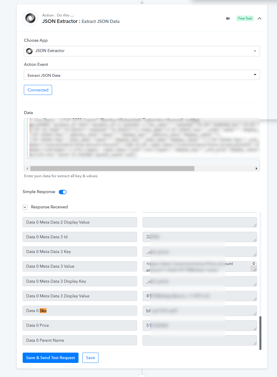

You can try using the JSON Extractor instead of Iterator for you line items that you retrieving. Also which wouldn't send multiple emails depends on the number of products.

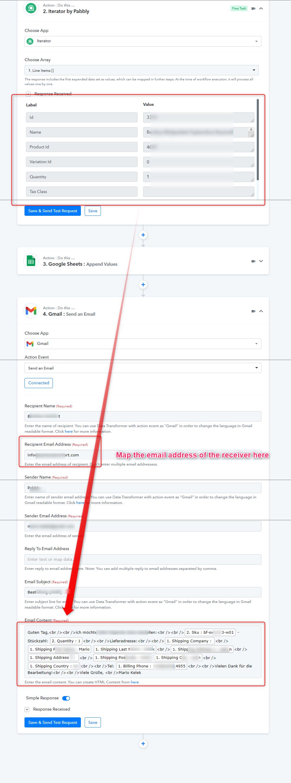

We have made some changes in your workflow and it should work accordingly. Kindly review it, give it a try and let us know if you get stuck at any step.

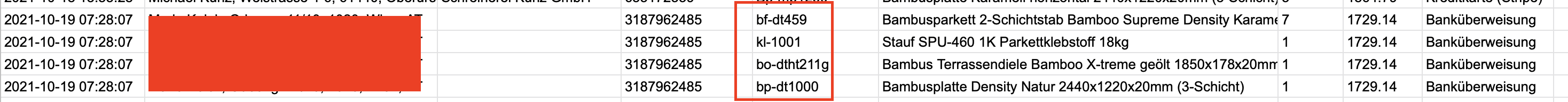

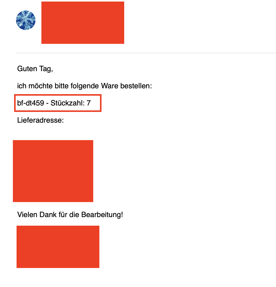

Hi, thank you for helping me out! So i tested it but still the E-mail just shows the first product. Google sheets correctly records all products.

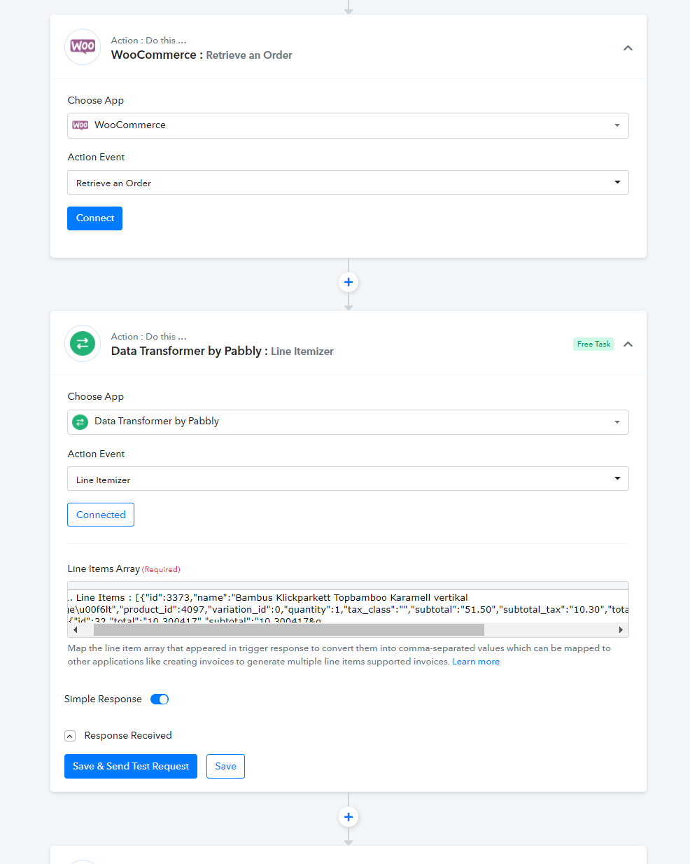

Please try the WooCommerce step of "Retrieve an Order" on the second step map the Order Id there and then capture the API response by switching off the simple response. Then on the 3rd step use the Data Transformers' "Line Itemizer" then map the response of the 2nd step on the Line Itemizer.
And as a result, you will get all the items in a line.

Please try "Retrieve an Order" on the 2nd step by adding it after the existing trigger step and then adding the Data Tranformer's Line Itemizer. In that way, you will get all the products in a single line.
