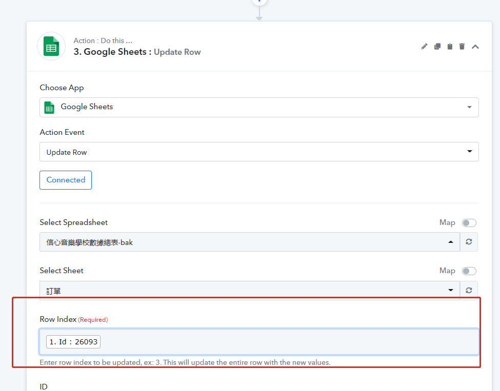

I am trying to sync my order data from woocommerce to google sheet
When the order is changed from woocommerce's side, it should be synced to the google sheet. It looks like the "Row Index" field is expecting a fixed number, because when I put order id in there as the screenshot above shows, it returns an error saying something like A26093 is out of range.
So how should I make the app? Do I have to add a "Google Sheet look up row" step?
By the way, if there are multiple rows to be added, how should I fill in the "Row Index" field?
Also, how do I make the pabbly app create a new row in my google sheet if no order is found?

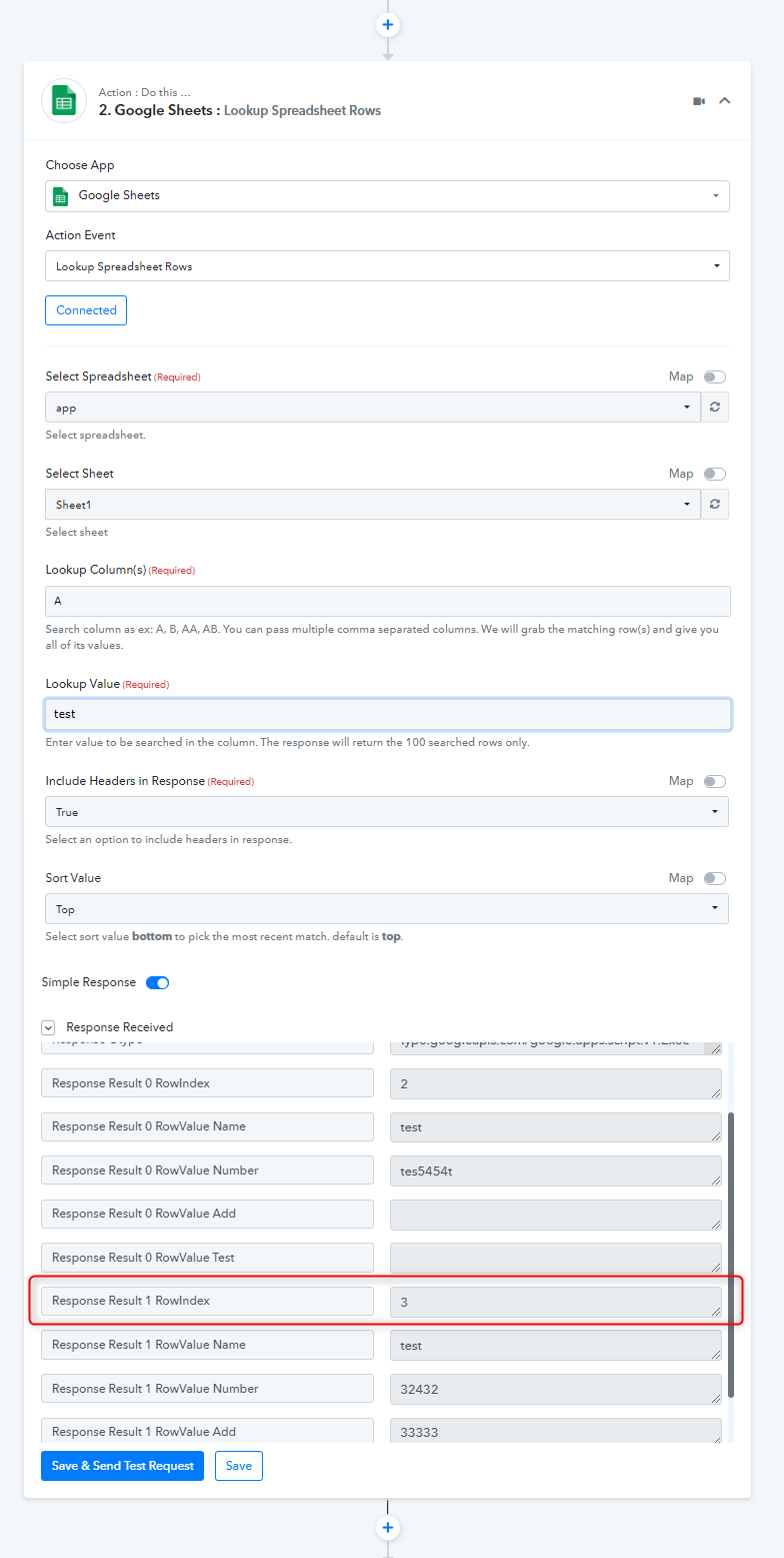

In the Row Index field, you need to pass the index of the row in which want to update the data.
So, kindly use the "Google Sheets: Lookup Spreadsheet Rows" action step once to get the row index number which you can pass it further in the "Update Row" action step.

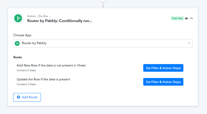

2) How do I make the Pabbly app to create a new row if the look up doesn't return any match?
You can use the Router action step if the desired data is unavailable in your Google Sheet and returned data not found in the Lookup action step.

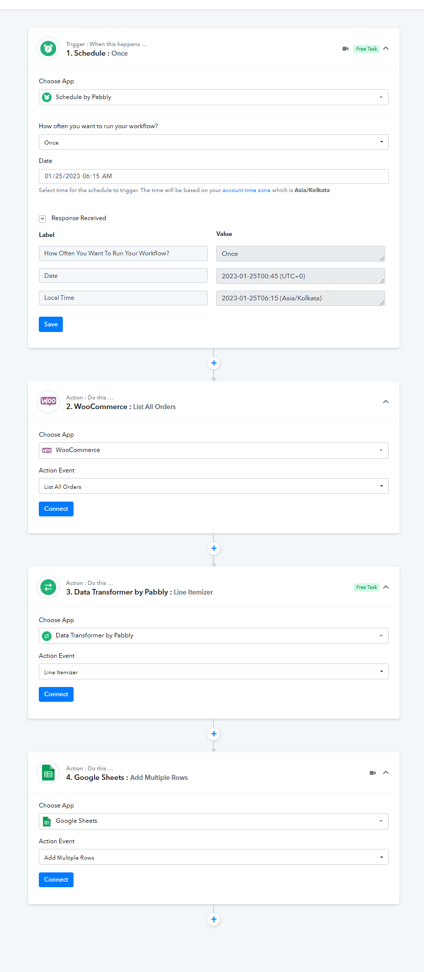

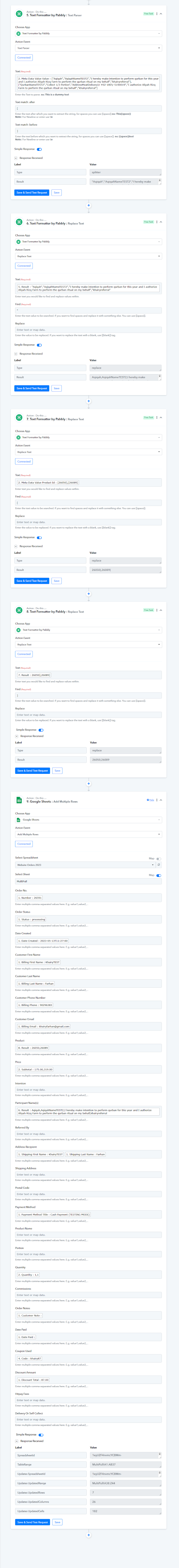

Regarding your use case to pass the data from WooCommerce to Google Sheets, you can refer to the following screenshot where can use the action step to do the same.
Hi there, I've tried to do this but when I clicked Connect at Step 2. WooCommerce: List All Orders, my browser crashed and I had to reload.
So I skipped that and tried to click Connect at Step 3. Data Transformer by Pabbly and it indicated that I had to decide the Line Array. So instead I chose the WooCommerce Data Extractor.
I tried to look for a video guide on your youtube channel but I could not find any.

Why aren't you using the "Line Itemizer" action step if you want to pass all the comma-separated values in Google Sheets at once?
Further, you can refer to the following video lesson for a better understanding.

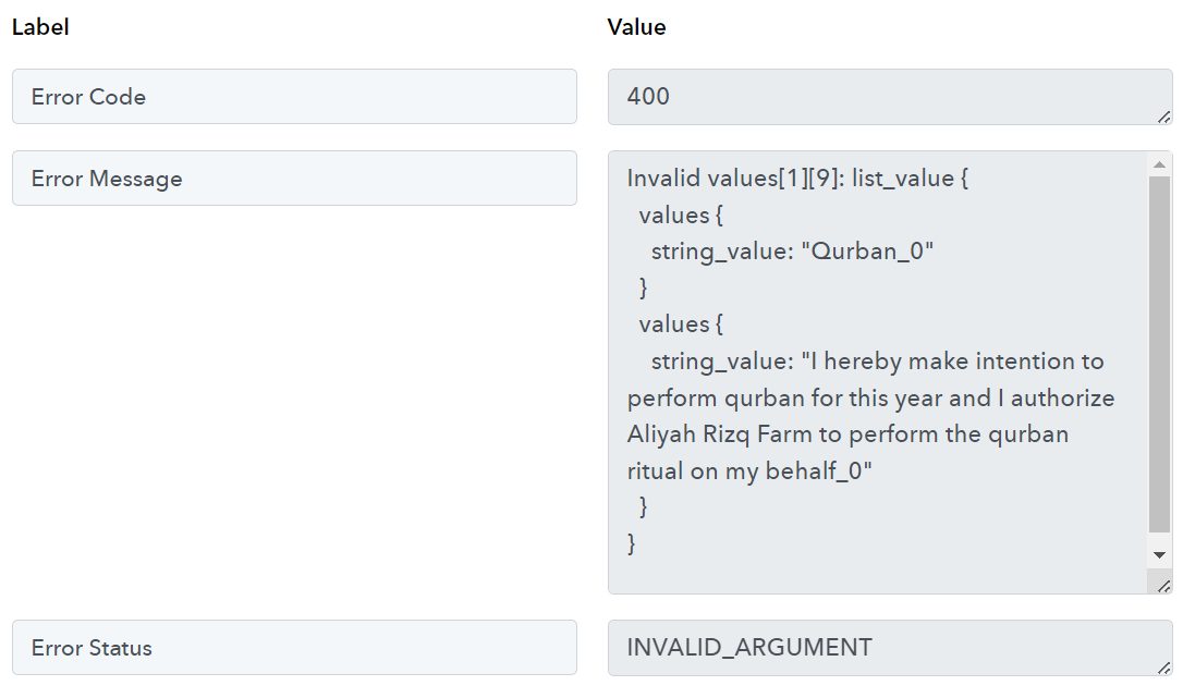

Hi Supreme, I managed to work out the Line Itemizer and then to follow that up with Add Multiple Rows action on Google Sheets. However, I received the following error that I hope you can assist with:
Supreme
Hey @arfqurban
Since you are getting a nested array, you need to escape the data from it with the help of the "Text Formatter: Replace Text" action step.
