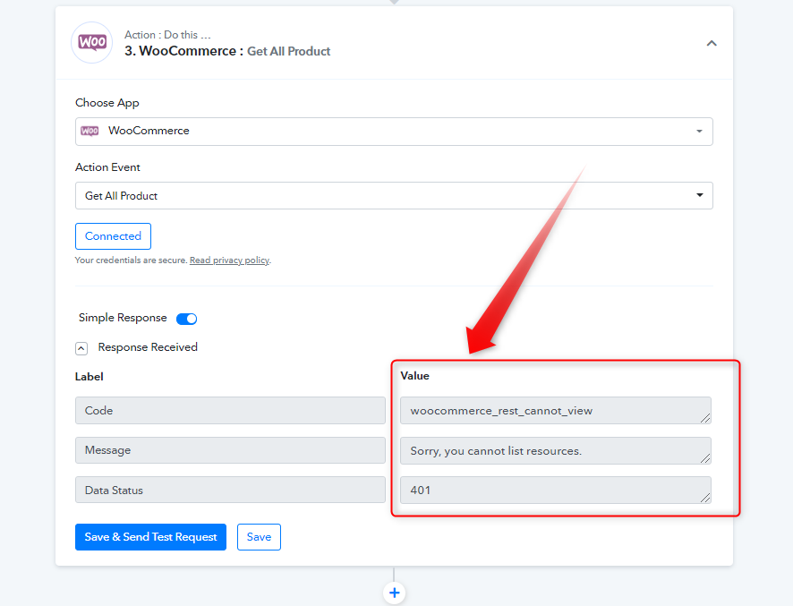

woocommerce_rest_cannot_view

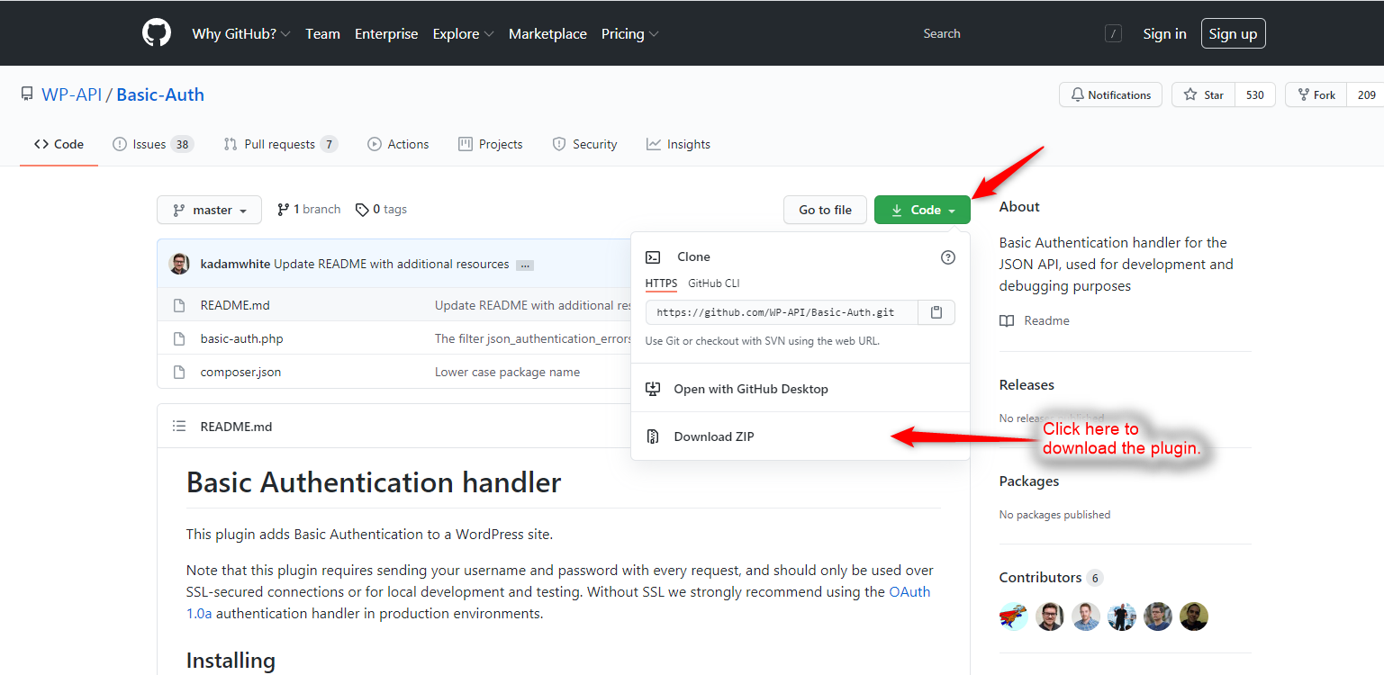

Step 1. - Download the Basic Authentication handler plugin from here https://github.com/WP-API/Basic-Auth.

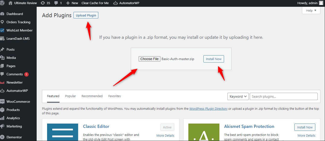

Step 2. - Upload Basic-Auth-master.zip in the WordPress site.

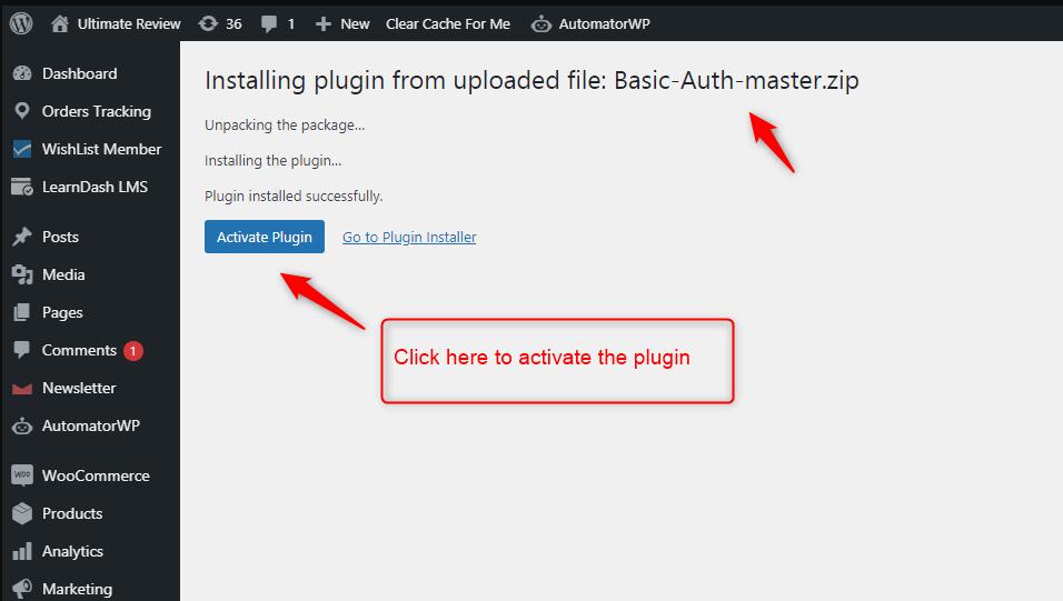

Step 3 - Activate the plugin, and then click on re-authenticate the WordPress integration In Pabbly Connect. It should work fine.

My integration with WordPress is working. I mean I am able to create the user from pabbly in my WordPress website but the above-said error is coming while connecting with woocommerce on the same website

We have checked over your concern and the login credentials are fine for your WooCommerence but there is a permission issue that is coming up from the WooCommerce end.
So, kindly contact the WooCommerce team and ask them that while fetching the Product list via REST API, why we are getting the following error even though the credentials are already correct -
Seems that you have some permission issues with WooCommerce that is creating issues.

Its not about just Getting product dist all the actions listed in pabbly are not working for woocommerce

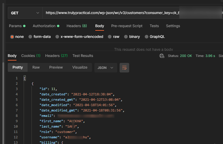

Pabbly Connect authenticating WooCommerce works via Basic Auth and it seems that your server is ignoring the authentication headers. As we have checked with the query string. It's working properly
