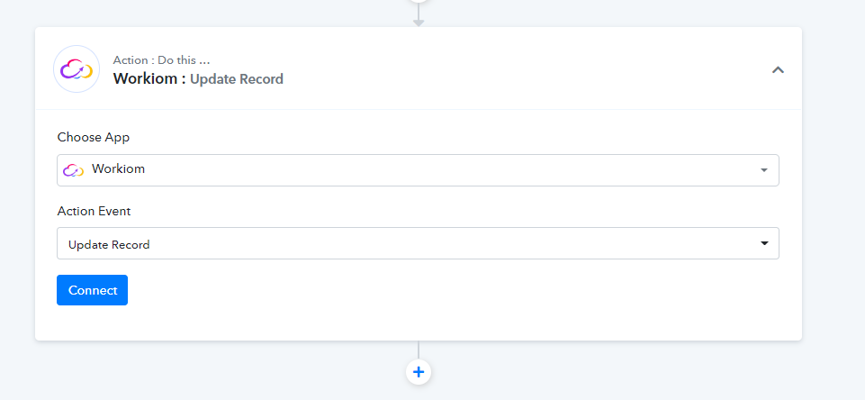

Hey @apps
As we can see from your workflow, all the fields are coming in the Workiom action step correctly.
Kindly check again.

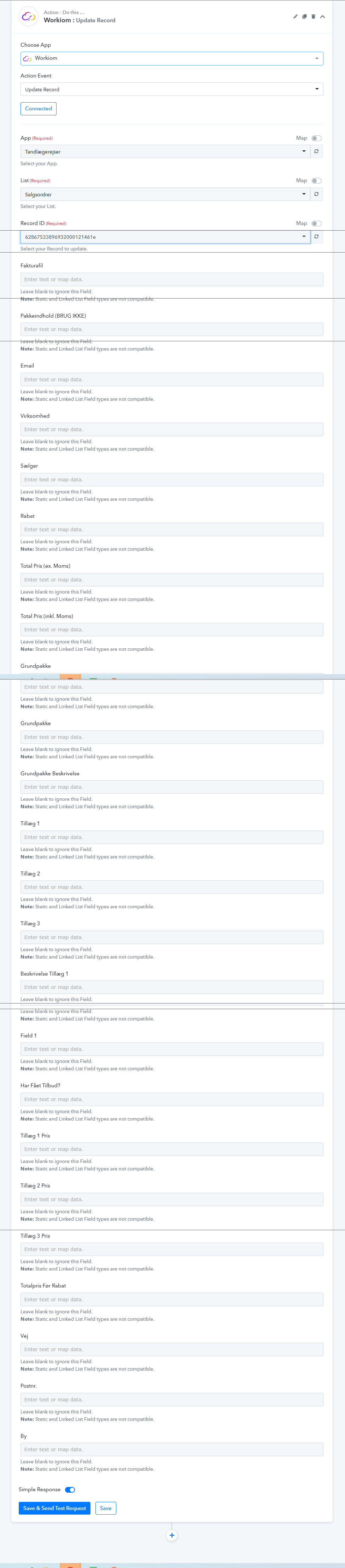

apps
Thanks! As you can see form my screenshot in my last message and this one - there were only 3 fields to fill:
However I think it is because you had server issues or something when I tried. Because the interface was incredbily slow (took like 2 min to finish adding a connection). Now it seems to work.
