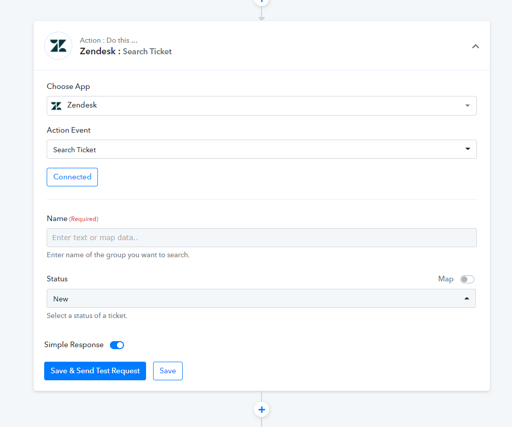

To update the Zendesk ticket you have to search for the existing ticket first with the help of the "Zendesk: Search Ticket" action step and then you have passed the Ticket ID in the Ticket Field.

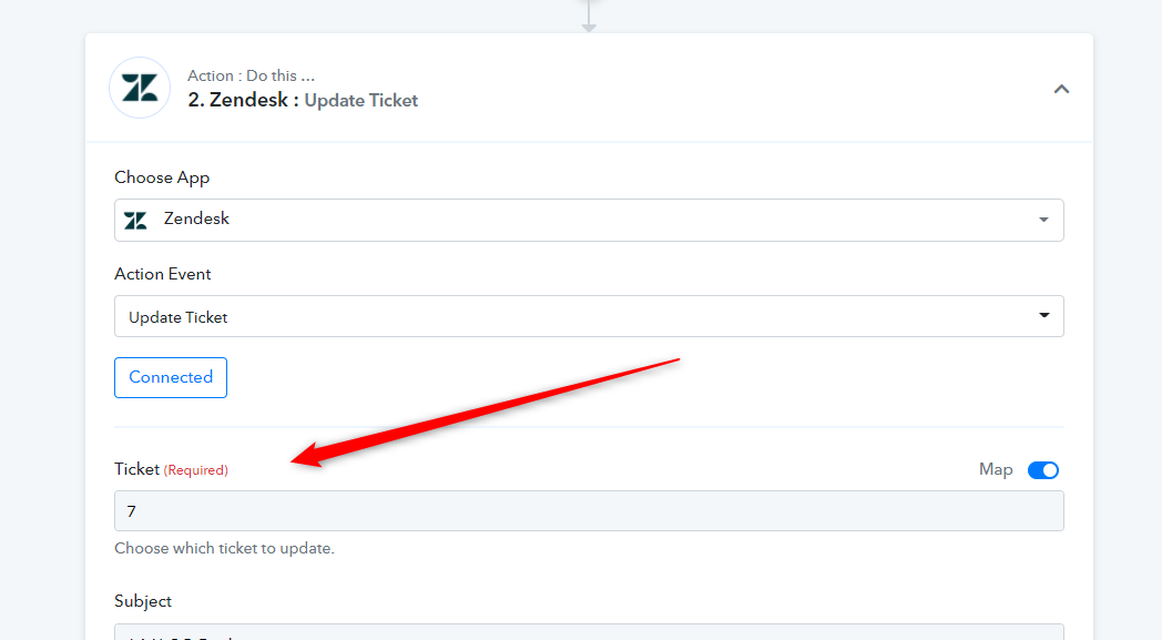

Thank you for your response. But is there not a way to just make it that whenever an update is made on a related/connected task in ClickUp, that there is an update made to the related/connected ticket in ZenDesk? I don't want only ticket #7 updated. I want every ticket that is connected between the two platforms to know to automatically update when there is activity on either side.
Is this possible?

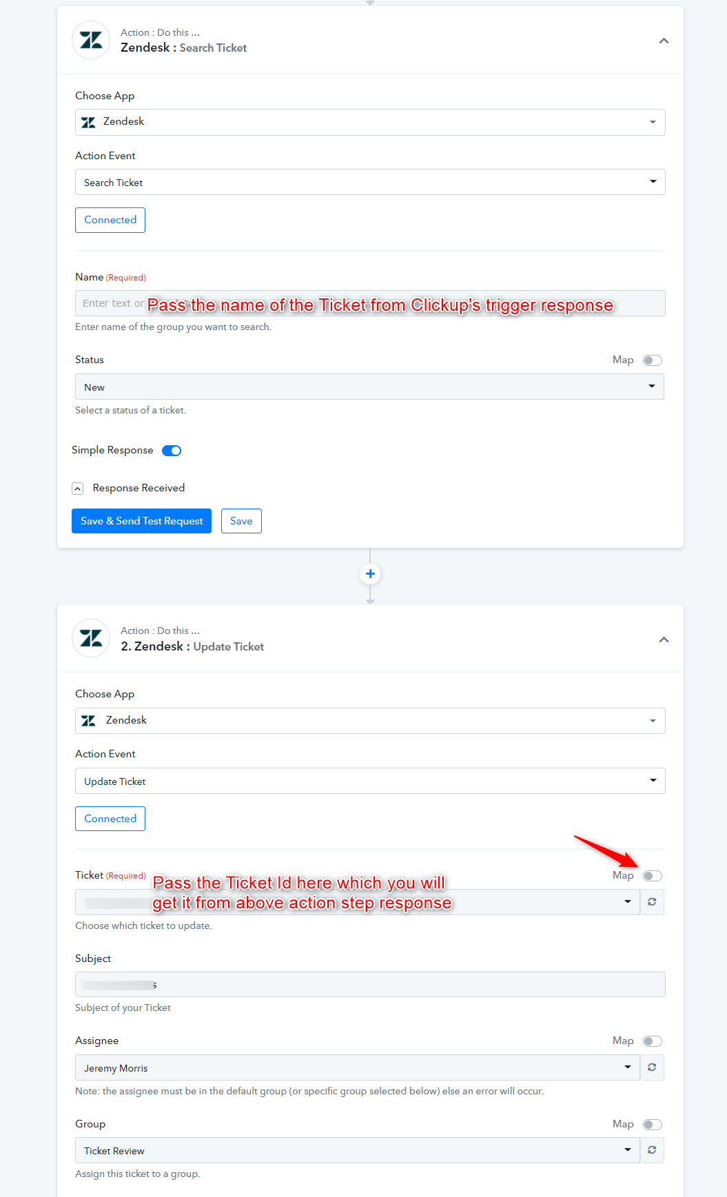

Hey @jeremymorris
In the previous reply, we have shown you the exact action step which will be required to achieve your use case.
In the "Zendesk: Search Ticket" pass the name of the Ticket from your Clikcup and in the response, we will get the Ticket Id which we will later use in the "Zendesk: Update Ticket" action step in the Ticket field by toggling the map button.
