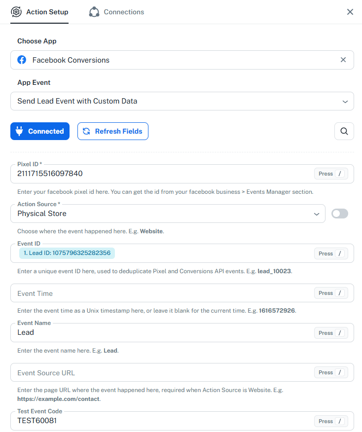

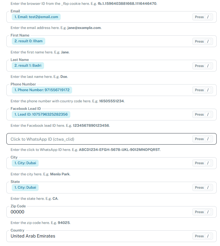

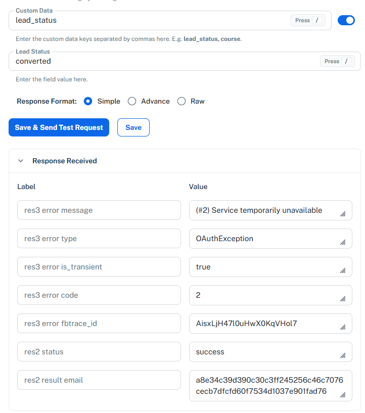

Hi, I am facing this error since yesterday on sending a test response to a dataset. Other workflow which was previously created (for same dataset) works properly. I have tried creating a new connection and also tried removing the integration from facebook settings and reconnecting.

Pabbly Support โ€” Reply ยท
Hi Zeshan,
We have checked the error response and found that Facebook is rejecting the event because the event timestamp is older than the allowed 7-day window.
We noticed that you are adding 3600 to the timestamp. Could you please clarify why this value is being added.
Adding 3600 shifts the timestamp forward, but this alone would not resolve the issue if the original event timestamp is already outside Facebook's permitted 7-day window.
We request you to review the timestamp being passed to Facebook and ensure that it accurately represents when the event occurred.
Please find the attached screenshot for your reference. Kindly review the error and share your clarification regarding the addition of 3600 so we can investigate this further.

Zeshan Ahmed โ€” Reply ยท
This Event is sent with action_source : physical_store which allows events to be sent upto 62 days after a lead is received as it is considered an offline lead.
I've added 3600 to add an hour to the time it took to convert that lead.
Thank you for your patience and cooperation.
We have checked your workflow again and can now confirm that it is working fine.
Please find the attached screenshot for your reference. We request you to verify the workflow from your end as well and let us know if you encounter any further issues.
