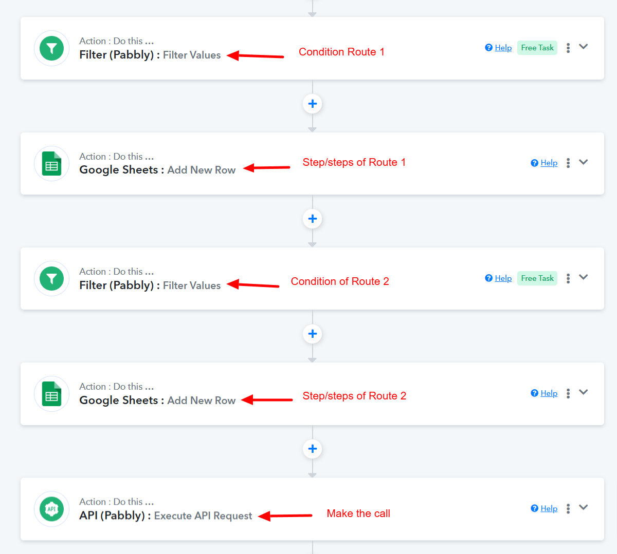

Currently, it is not possible to execute a single call after both route conditions are met. If you have a workflow where you expect both conditions of both routes to be fulfilled, we suggest using filters in a sequence instead of routes. For example, if the first condition is met, execute a step; then, if the second condition is met, execute the second step, and finally, make the call.

For this use case, you can add the call as the final step in both routes.

You can add a third route to your workflow, set the filter condition in this router to ensure it is satisfied regardless of the data it receives (it executes every time), and add the call step to this route. This will ensure that the call is made even if the condition in Route 2 is not satisfied.
