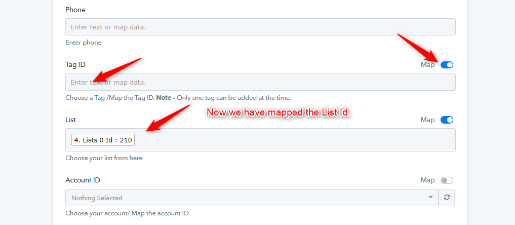

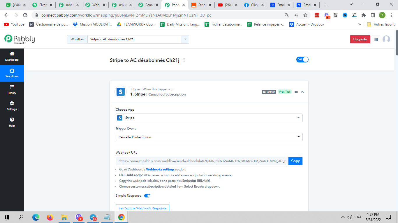

HI, I have a problem to finalise this automation. At the last step it should add the customer to a list in Active campaign. The list is already retrieved in the "search list" step, but at the end it dosent work. Also, it seems that it's mandatory to also add a tag ? Any way to avoid this ?

You can avoid the Tag ID by leaving the field empty, for that you need to enable the map button. Further, you were not passing the correct list ID in the List field, though we have corrected it for you. Kindly review that up and try again.
