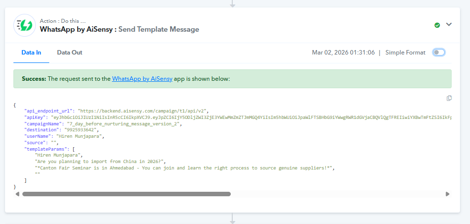

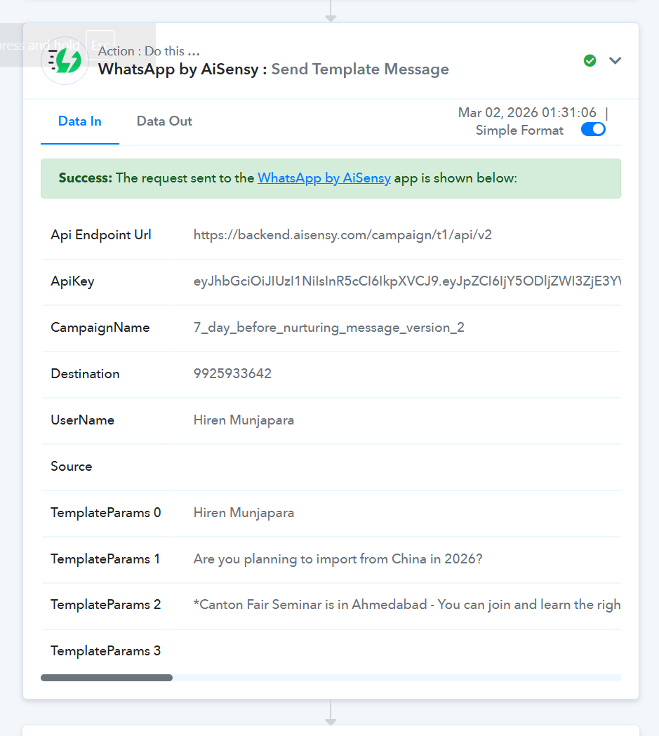

but many Aisensy tasks triggered without parameter, I am wondering if the parameter was not assigned properly, rest 500 also should not get the reminder but they got,
and if the parameter was not there, pabbly simply should have marked that tasks as RED/not executed, however due to some technical glitch of pabbly the tasks was executed successfully:

We checked the workflow. This is not a Pabbly issue — it’s due to how the AiSensy API handles parameters.
Because a comma was manually added in the template parameters, when one value was missing (due to a rate limit in the previous step), the API treated it as an empty string and still accepted the request. That’s why the task showed successful instead of failed.
To fully prevent this, you would need to connect with the AiSensy team and check if they can enforce strict validation (so empty parameters throw an error instead of being accepted).
From our side, the request is being sent correctly as per the API structure.

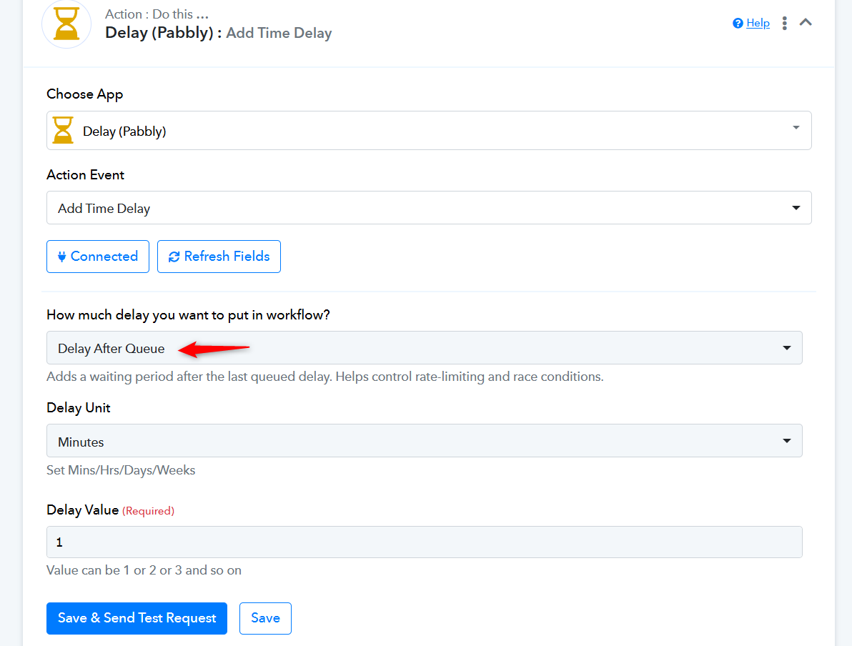

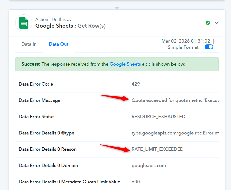

You are encountering a rate limit exceeded error in the Google Sheets action step. The error is from Google's end. This happens when the Google Sheets API is called multiple times within a very short period. Based on your task history, your workflow was executed multiple times in quick succession (nature of your use case), which caused this issue.
To prevent this issue, you can add a Delay After Queue step before the Google Sheets: Get Rows action step in your workflow. This will ensure there is at least a 1-minute delay between two task executions and should help prevent the error in the Google Sheets spreadsheet.

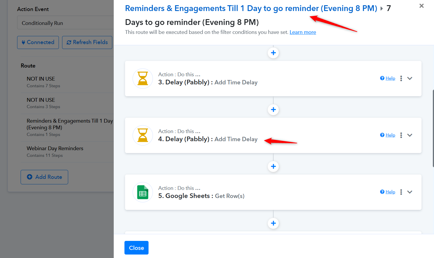

1. We have added a Delay After Queue action step before the 'Get Row(s)' action step in one of the routes of your workflow on your behalf. You can similarly add a Delay After Queue step before every 'Get Row(s)' action step in your workflow.

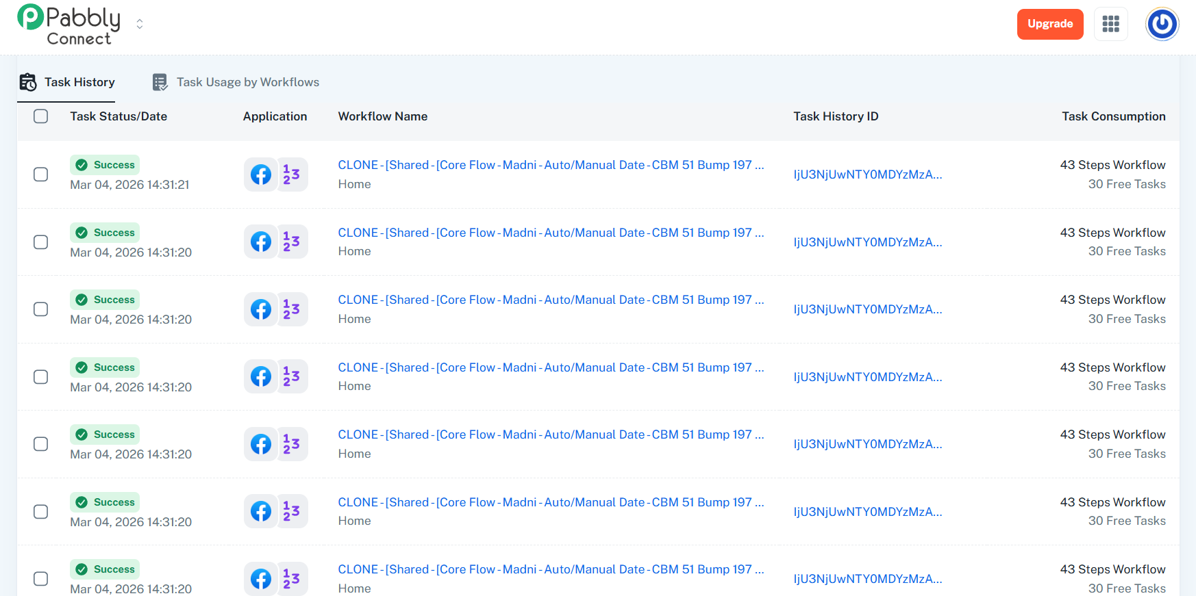

  1. Google has a rate limit that determines how many times you can execute an API endpoint within a short span of time; this is known as a rate limit.
In your workflow setup, many tasks execute at approximately the same time (because of the Delay Until step), as shown in the screenshot shared in my previous message. Because of this, the 'Get Row(s)' action step executes multiple times in a very short span of time, which causes the rate limit to be exceeded.
Adding a Delay After Queue action step will introduce a delay of 1 minute between each task execution, which should prevent the rate limit from being exceeded.

Could you please confirm what the Google Sheets “Get Row(s)” action is being used for in your workflow
It appears that the same Google Sheet row is being fetched under multiple routes/actions. If the same data is being retrieved each time, we may be able to optimize the workflow to call the sheet only once, which can help avoid the rate limit issue.

Currently, since the limitation is from the Google Sheets API, there isn’t a way from our end to completely prevent it when many tasks run at the same time.
You can try requesting a quota increase in the Google Cloud Console for the Google Sheets API. If approved, it may help avoid the rate limit.
Alternatively, you may consider using tools like Airtable, which work similarly to Google Sheets and generally handle higher API requests better.
