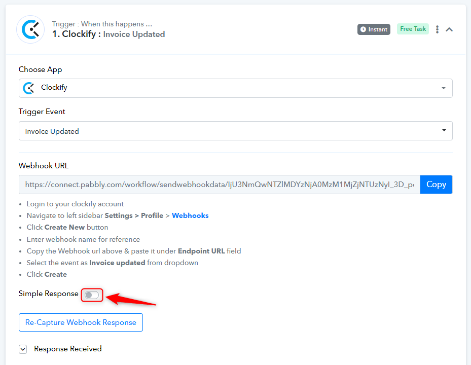

We can't use the trigger 'update the invoice' in Clockify, as this seems to only bring across the first line item
Step 1. To get all the line items of your invoice, you need to Disable the Simple Response. Doing this will give you a response in an array format.

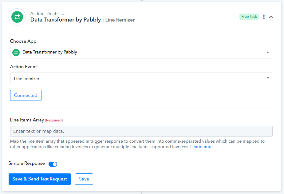

Step 2. After that, you need to add the Data Formatter: Line Itemizer to your workflow, which will give you a response in line items that you can then map while creating the Xero invoice.
