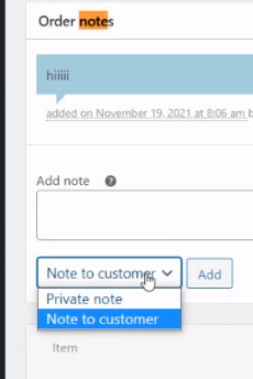

Could you please tell us that have you checked the "Note To customer" in the dropdown of the Note section in your WooCommerce while passing the data to your trigger?

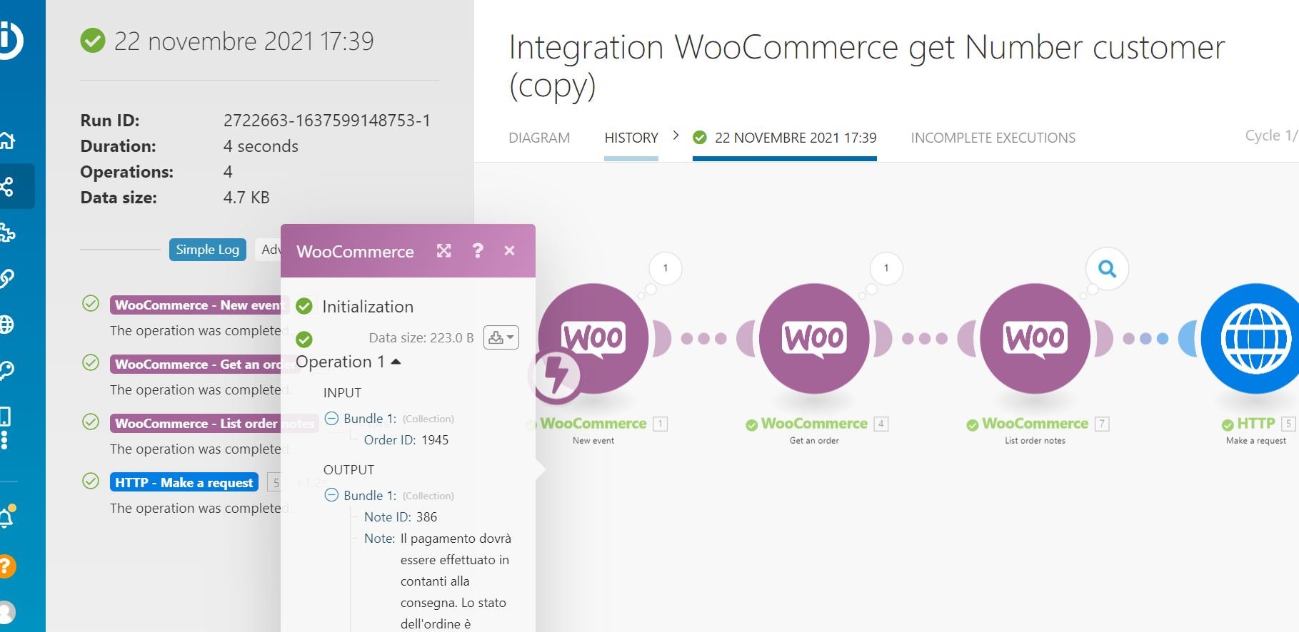

I've seen them do this, but I'd like to stay with you for this workflow as well.
Is it possible that they can and you can't?
as you can see they have made a form that takes the notes of the order. The hook appears to exist.

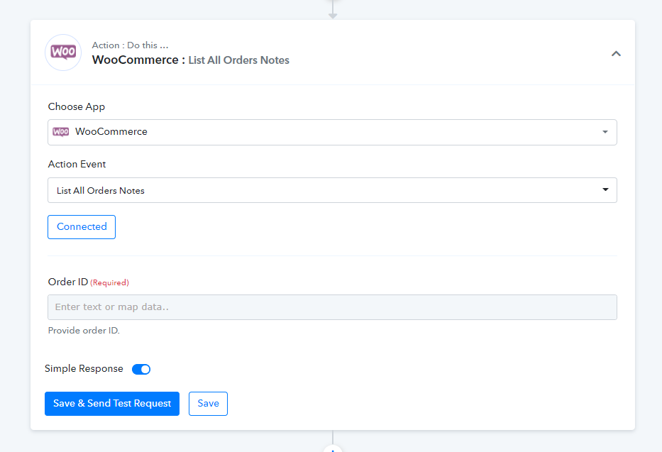

Hey @Cristiano
We have added the action event to receive the notes from the orders. kindly try this at your end by connecting your WooCommerce account correctly.
Thanks!

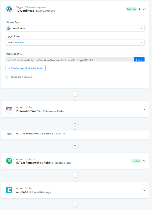

anyway I show you here how I managed a few hours ago to solve.
I found that the notes are comments, so it was enough for me to take the notes from the comments as shown in the screenshot.
Thanks again for the form which will be useful to me anyway
