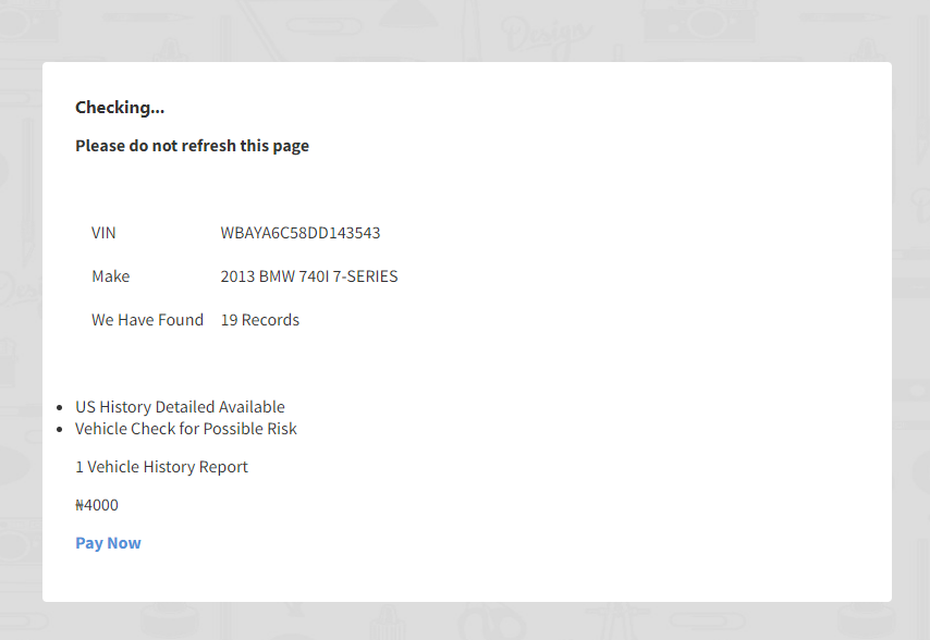

mishael
please see the screenshot
{"Make": "2. Vehicle : 2013 BMW 740I 7-SERIES","Record": "2. Data Records : 19"}

Just tested it out and it worked fine for me.
Let me share some screenshots and see if you can follow along:
My Form:
Backend Setup: I am seeing that you have a Simple Response Turned Off. You need to Turn it ON. Try with a very simple setup first and than you can expand on that.
You need to add the [show_webhook_response] in the Thank you page text.
After setting everything up:
After submitting the form. You should see the result.

mishael
Right, the form doesn't work from my WordPress site but when I paste just the form link it worked. why is it not working in my work WordPress?
