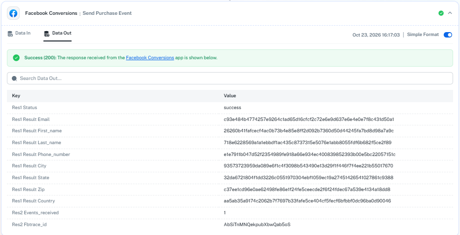

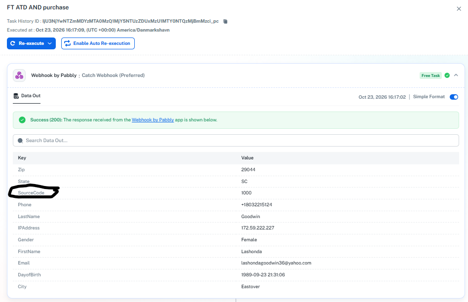

I have data coming via "Webhook by Pabbly" and it's not send through the flow to Fb conversion

Hi Mido,
Thank you for sharing the screenshots and workflow execution details.
We have checked the Workflow history and can see that both the Webhook by Pabbly and Facebook Conversions steps are showing a successful response. The Facebook Conversions response also shows Events_received: 1.
To help us understand the issue better, could you please clarify whether the Purchase event is not appearing in Meta Events Manager, or whether it is appearing there but not reflecting in your Facebook Ads Manager reports?

We reviewed your β€œFT ATD AND purchase” workflow and its Task History logs. Our findings indicate that the Purchase event is being received by Meta (Events_received: 1). However, the conversion value is not being passed correctly.
In Step 3, Facebook Conversions (Send Purchase Event), the Value field is currently mapped to SourceCode instead of the parameter containing the actual purchase amount. Additionally, in recent webhook executions, the value parameter was empty or omitted. Consequently, Meta is receiving the Purchase event without the expected conversion value.
To resolve this, please follow these steps:
  1. Open your β€œFT ATD AND purchase” workflow in Pabbly Connect and navigate to Step 3: Facebook Conversions (Send Purchase Event).
  2. Locate the Value field below the Currency field.
  3. Remove/update the existing SourceCode mapping.
  1. From the Webhook by Pabbly: Catch Webhook (Preferred) response, select the field that contains the actual purchase amount, such as Price, Amount, or Total, depending on your incoming payload.
  2. Ensure the mapped value is a valid numeric amount without currency symbols, thousands separators, or additional text. For example, 2000 and 2000.00 are both valid numeric representations.
  3. Click Save & Send Test Request to test the updated configuration.
After updating the mapping, verify the event in Meta Events Manager β†’ Test Events to confirm that the Purchase event is received with the correct value and currency parameters. Please also ensure that the incoming webhook payload contains the expected purchase amount before mapping it.

The "soruce code" is the value, for some reason my CRM name it "source code"
