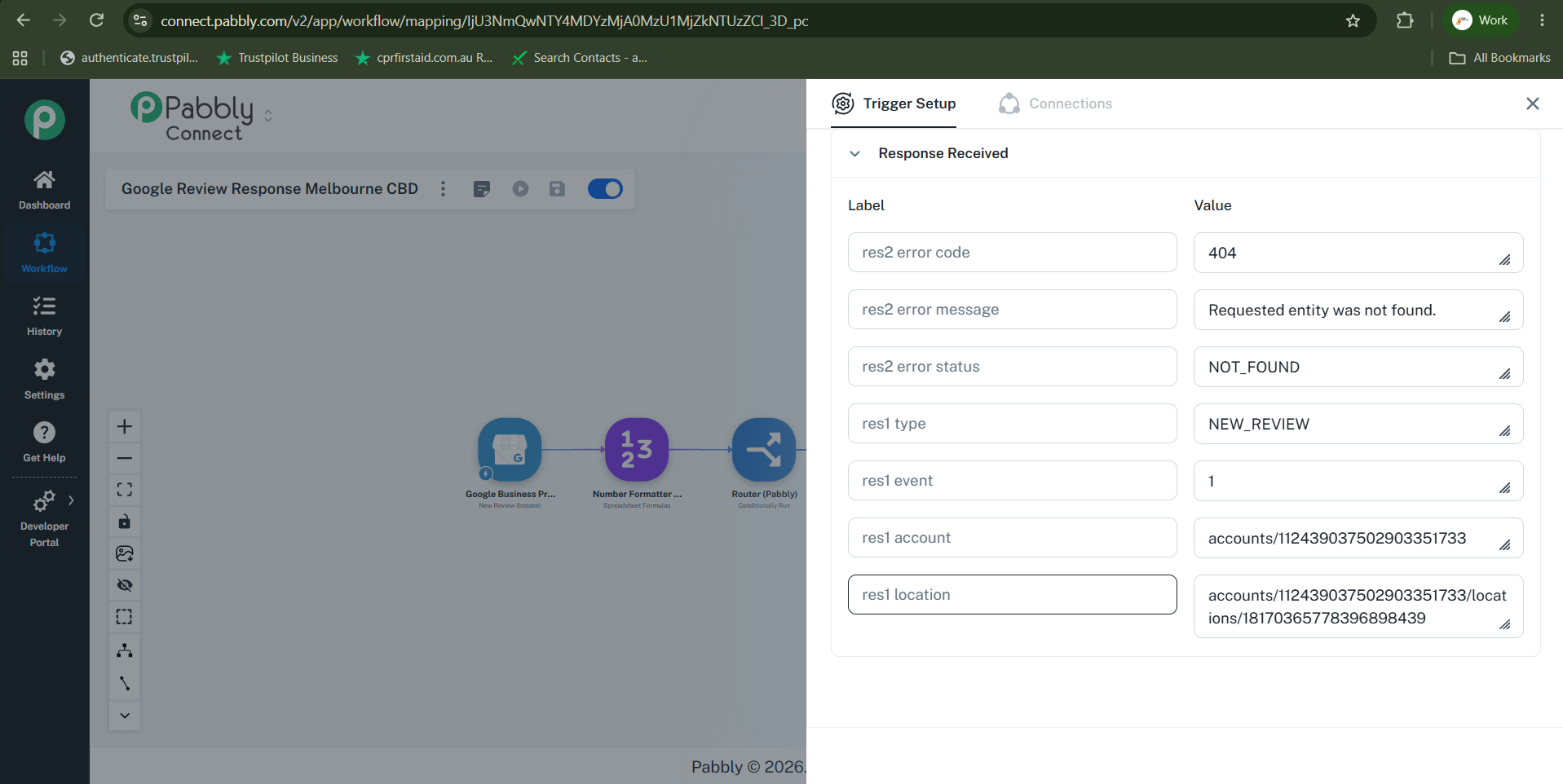

Hi Pabbly Support,
I'm having an issue with the Google Business Profile "New Review (Instant)" trigger in my workflow "Google Review Response Melbourne CBD."
The notification from Google is received correctly, but the follow-up request to fetch the review details fails with a 404 error.
What the trigger response shows:
Notification (res1), received successfully:
- type: NEW_REVIEW
- event: 1
- account: accounts/112439037502903351733
- location: accounts/112439037502903351733/locations/18170365778396898439
Review lookup (res2), failed:
- error code: 404
- error status: NOT_FOUND
- error message: Requested entity was not found.
The notification payload does not seem to include a review ID/name field, only the account and location. My guess is that the review lookup is being made without a valid review ID, or against an endpoint that doesn't match this location.

We have investigated the issue with your Google Business Profile – New Review (Instant) trigger and successfully resolved it.
The issue occurred because your Google account had 124 locations, but the location dropdown was displaying only the first 100 locations. As a result, the workflow was configured with the wrong location (Frankston) instead of your actual Melbourne CBD location (CPR First Aid Training, 343 Little Collins St).
We have now:
  1. Fixed the location dropdown to display all available locations.
  2. Selected the correct Little Collins St location in your workflow, "Google Review Response Melbourne CBD".
  3. Verified that the trigger is now successfully capturing the review details, including the reviewer name, star rating, and comment.
  4. Updated the Filter and Create Reply steps with the correct trigger response fields.
The issue is now resolved, and the trigger is successfully capturing new reviews.
