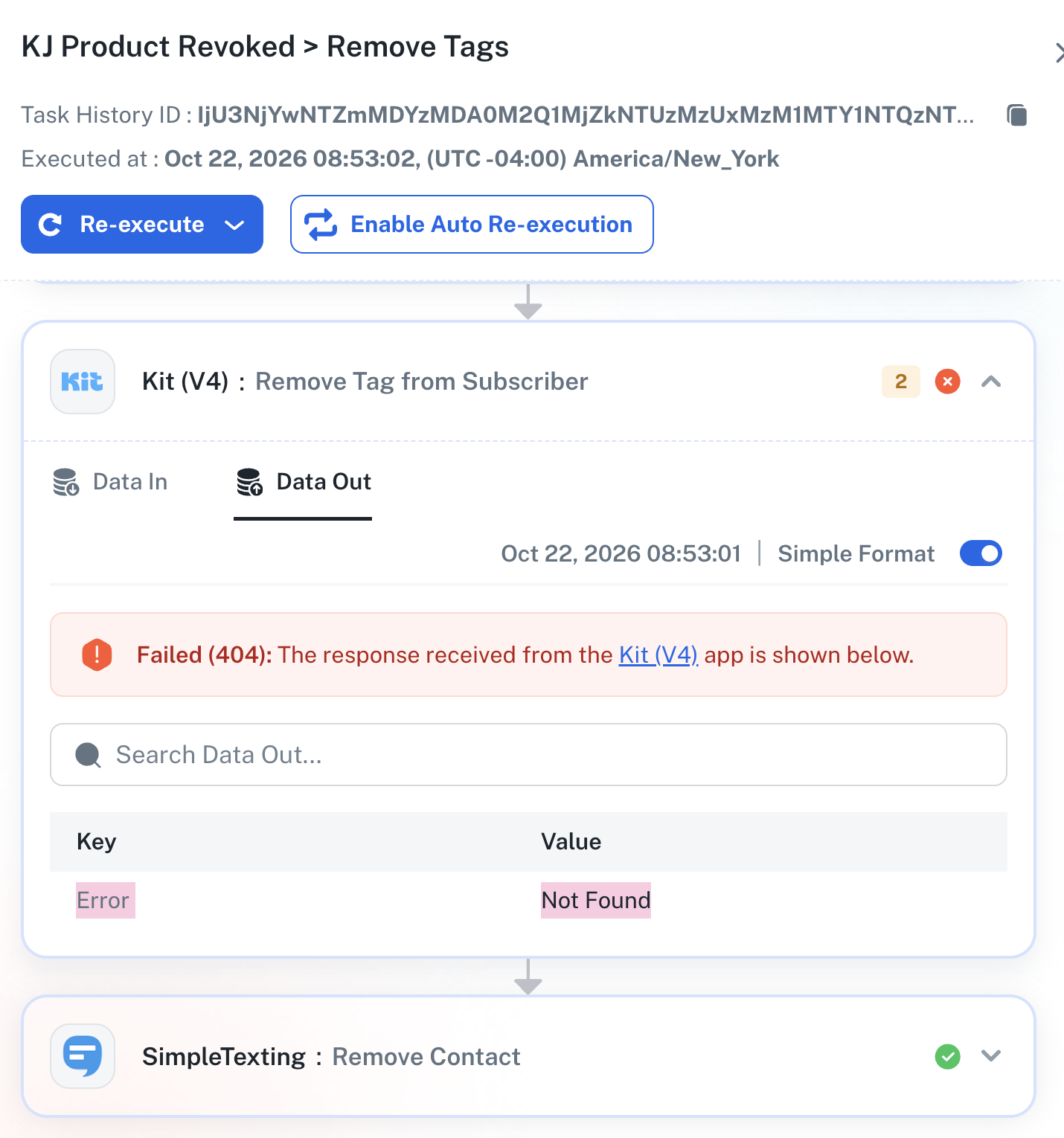

Hi, I have set up this workflow and it keeps failing, error:
Failed (404): The response received from the Kit (V4) app is shown below.
ErrorNot Found

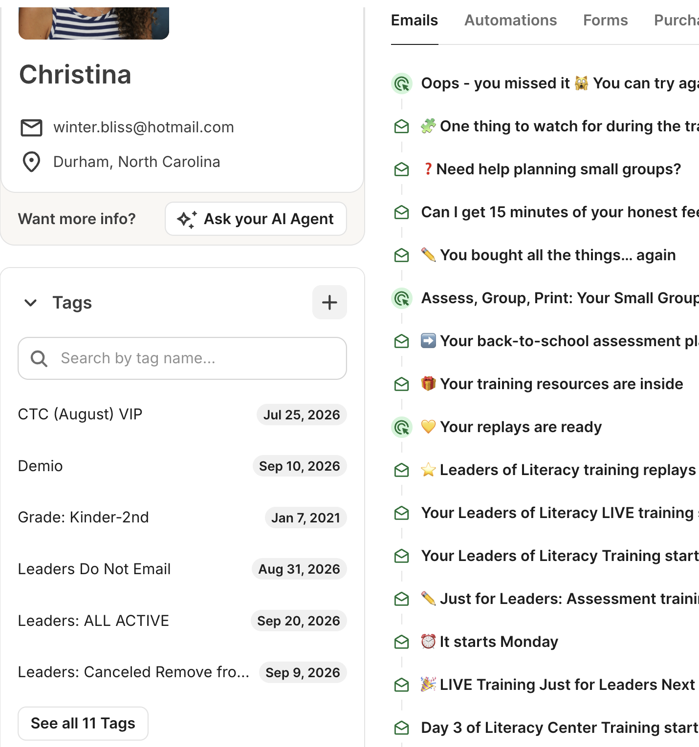

Everytime I check the Kit subscriber does have the tag that should be removed, can you take a look and help me?

We reviewed your workflow and identified the issue. In the Kit (V4) – Remove Tag from Subscriber action, the Subscriber ID field requires the subscriber’s ID, but an email address was being passed instead. This is why the API returned a Not Found error.
To resolve this, please follow these steps:
  1. Add a Kit(V4) - Find Subscriber By Email Address action step in your workflow.
  2. Enter the subscriber’s email address in this step to retrieve their Subscriber ID.
  3. Map the returned Subscriber ID to the Subscriber ID field in the Remove Tag from Subscriber action.
  4. Ensure the correct Tag ID is entered, then test the workflow again.
Please make the above changes and test the workflow from your end.

Christina Winter — Reply ·
thank you for checking, it looks like the workflow is working properly now! I appreciate ⭐️⭐️⭐️⭐️⭐️ support and have already left a review!
