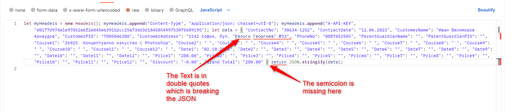

Hey @Ivan Arnaudov
Please check the JSON you have provided, as we can see from it, the JSON has double quotes inside and another double quotes which is why it is breaking the payload.
Also, we can see you are trying to create the JSON in the JS code, so kindly try that in the API by the Pabbly action step.
So, kindly consult with a developer and then try with Code.

Thank you, noticing the double quotation marks was spot on. I've taken measures to sanitize my inputs to avoid such issues in the future.
I produced the JSON as a temporary solution because there is something wrong with the Pablly integration for Crove, as I said. Now that my workflow is working, I will have more time to analyze the problem and report it to Pabbly.
