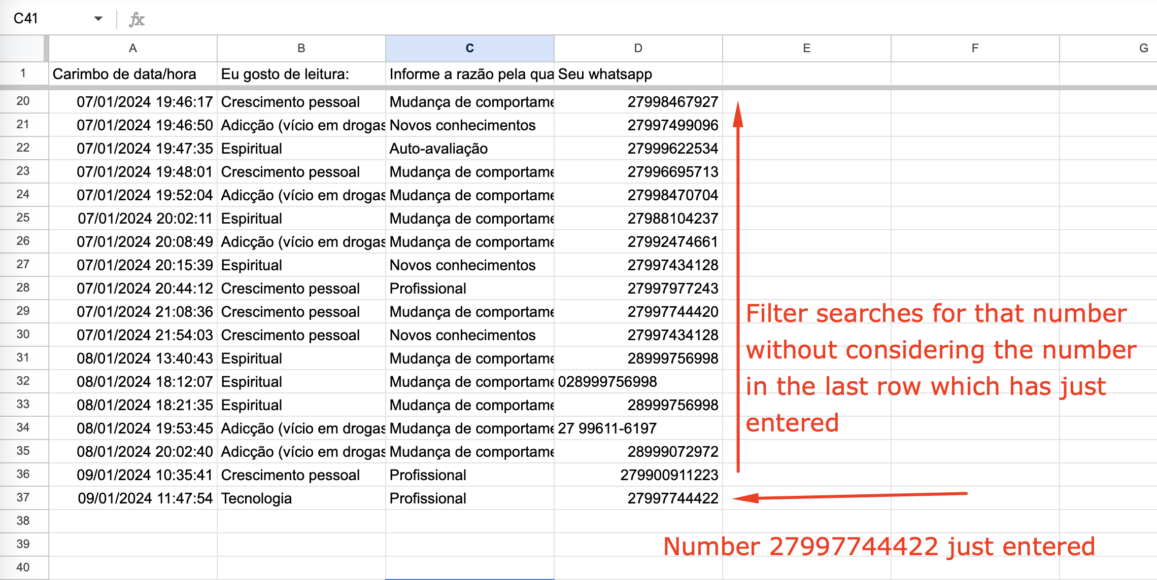

Hello Supremo, I have a new question in the workflow I am building.
How do I search for a number that already exists in a column of a spreadsheet, when that same number is entered in that spreadsheet?
In other words, I need the filter to identify that the number already exists in that spreadsheet without considering its existence when it is launched.
I've been trying the "Exists" option in the Filter Type without success, because the system considers the number that was just entered in the last row of the spreadsheet, and that's what I don't want.
Please take a look at the image below:

Hi, Shahidul here from FlowMateo.com
For your problem, you can use the Lookup action block in Pabbly. But, although if you use Lookup, you will see that you are getting the data that you put in at the last row. So, my suggestion would be to do a Lookup of the data, then find its location, delete the row data, then do a lookup, and then again put the data to GSheet by adding a new row.
I hope it would give you some idea.
Carlos Melo
Ok guys, I found a solution.
I set the workflow to initially search if the number exists in the spreadsheet and, if so, to get the date associated with that number. After that aI set the step to insert the number sent on the current day into the table.
