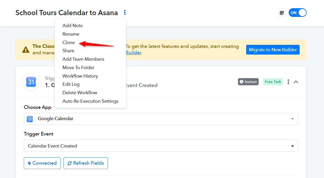

This type of issue is often caused by the Google Calendar trigger connection breaking. Please clone your workflow and set up the Google Calendar trigger step again in the cloned workflow to see if this resolves the issue.
Please make sure to click the "Save & Send Test Request" button only once while setting up the trigger step.

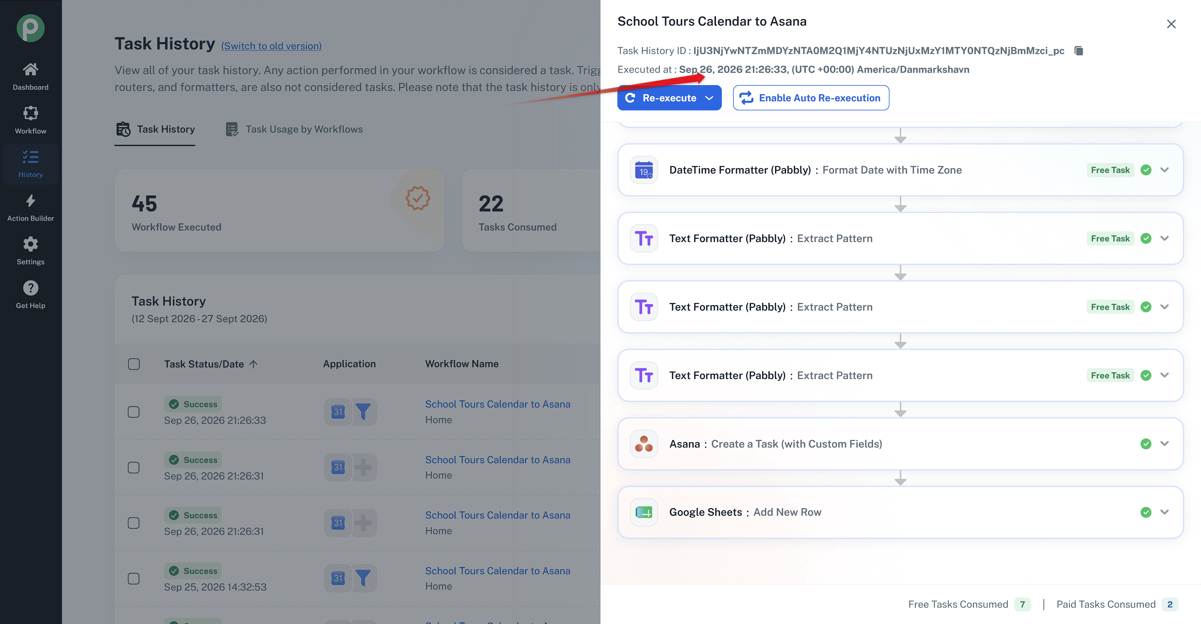

We tested both the workflow with live data by making a book and the workflow - School Tours Calendar to Asana with the task history ID IjU3NjYwNTZmMDYzNTA0M2Q1MjY4NTUzNjUxMzY1MTY0NTQzNjBmMzci_pc, and it executed successfully.

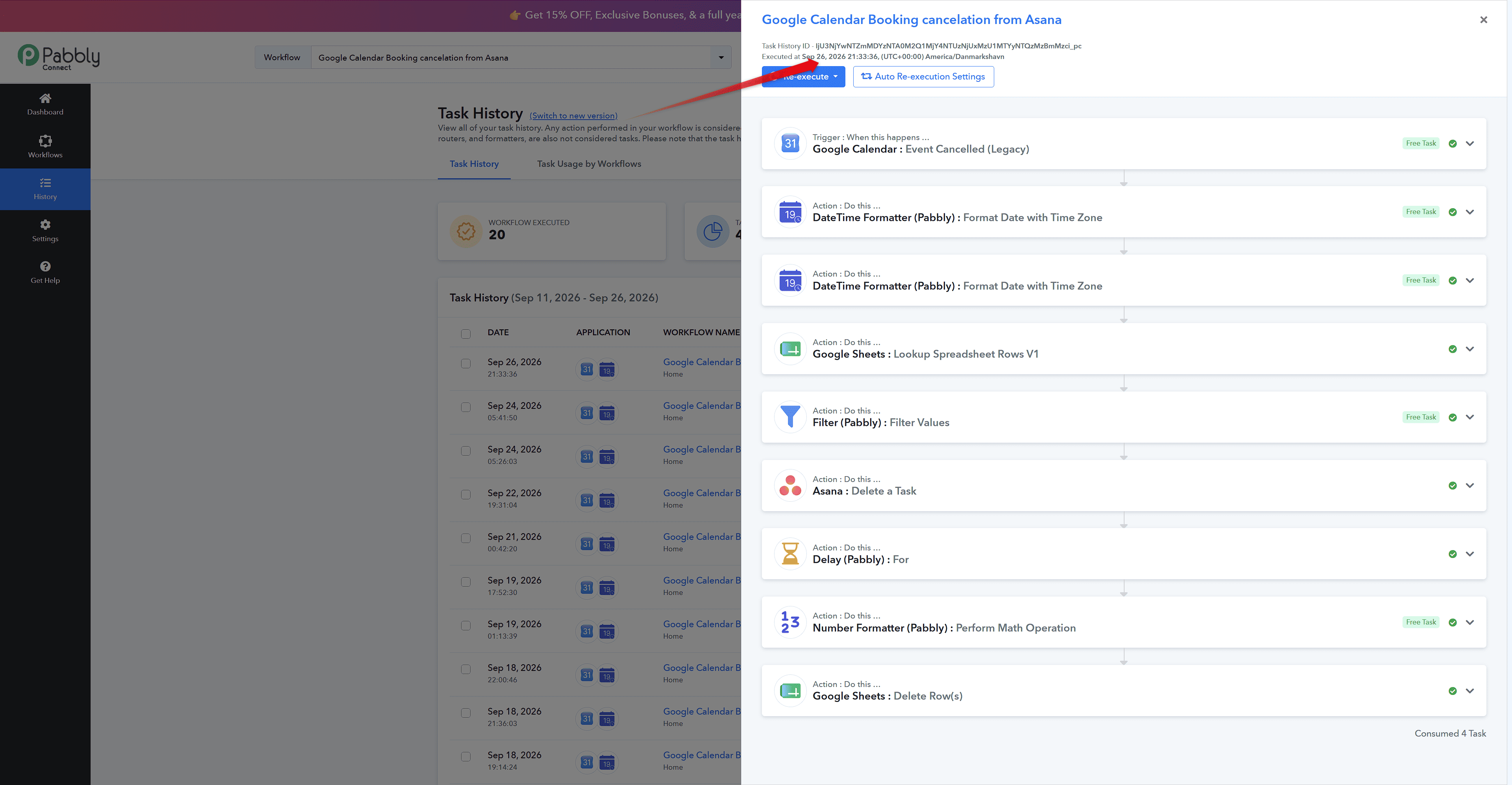

2026-09-27_02h58_48.pngWe then canceled the booking in our Google Calendar and then checked the workflow Google Calendar Booking cancelation from Asana's task history. The workflow executed successfully without any issues. The successful task history ID is IjU3NjYwNTZmMDYzNTA0M2Q1MjY4NTUzNjUxMzU1MTYyNTQzMzBmMzci_pc
2026-09-27_03h09_51.pngBoth workflows are set up correctly and are in proper sync. You get the workflow failure errors on old test data. Kindly remove all the old test data from your Google Sheet and delete the Asana tasks manually that were created during tests. They are creating unnecessary confusion, as the data for those tasks was not properly synced at that time due to incomplete setup.
