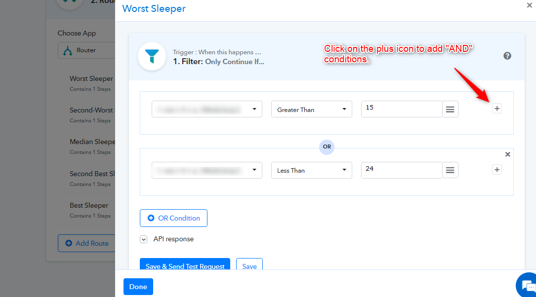

Aman
Seth, I just checked your workflow. Actually, you are using the "OR" conditions under the Routes. But as I mentioned in my previous message you need to use the "AND" conditions.
