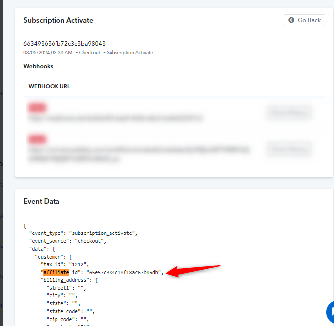

When a customer fills out a checkout form, and that form is shared by an affiliate using an affiliate link, you will receive the details of the affiliate as affiliateID in the webhook response triggered by Subscription Activate webhook trigger. Please refer to the below screenshot for more details
By leveraging this Affiliate ID, you can retrieve the affiliate's email address through the API (Get Single Customer via Customer ID), as the customerID and affiliateID are the same. Following this, you can forward the required customer details to the affiliates. Additionally, the customer's information provided in the form will be included in the same webhook response. This entire process can be automated using Pabbly Connect.
