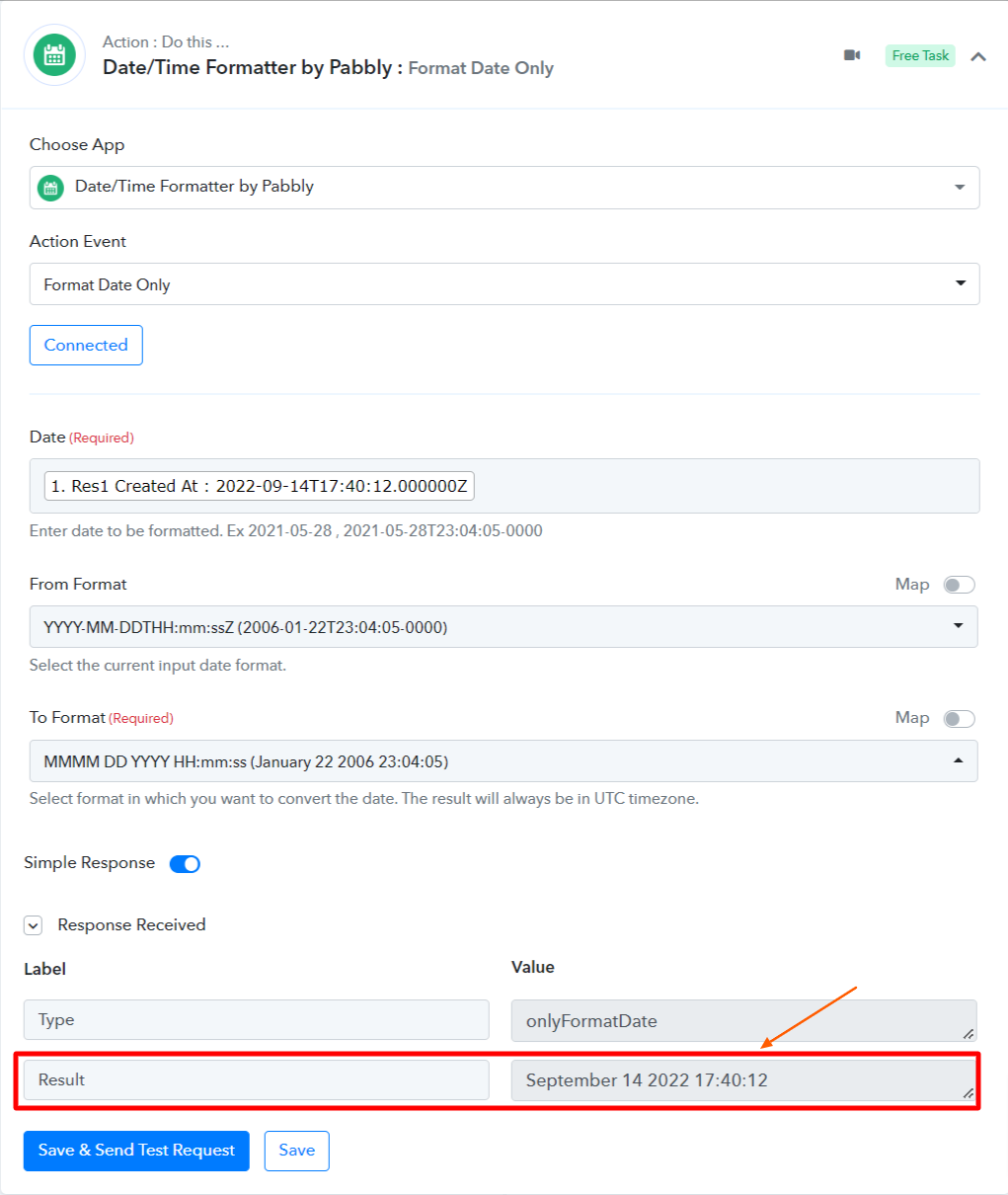

1) The event date comes in 2022-09-26T23:30:00.000000Z format, can you kindly guide me on how to change it? For example, into something like September 26, 2022 at 11:30PM
You can use "Date/Time Formatter" step after your Calendly step to change the time as per your requirement-

Hi @Subin and thank you!🙂 The date formatter was a nice trick, I'm new to pabbly, so I'm still exploring, but your advice solved the issue! Thanks

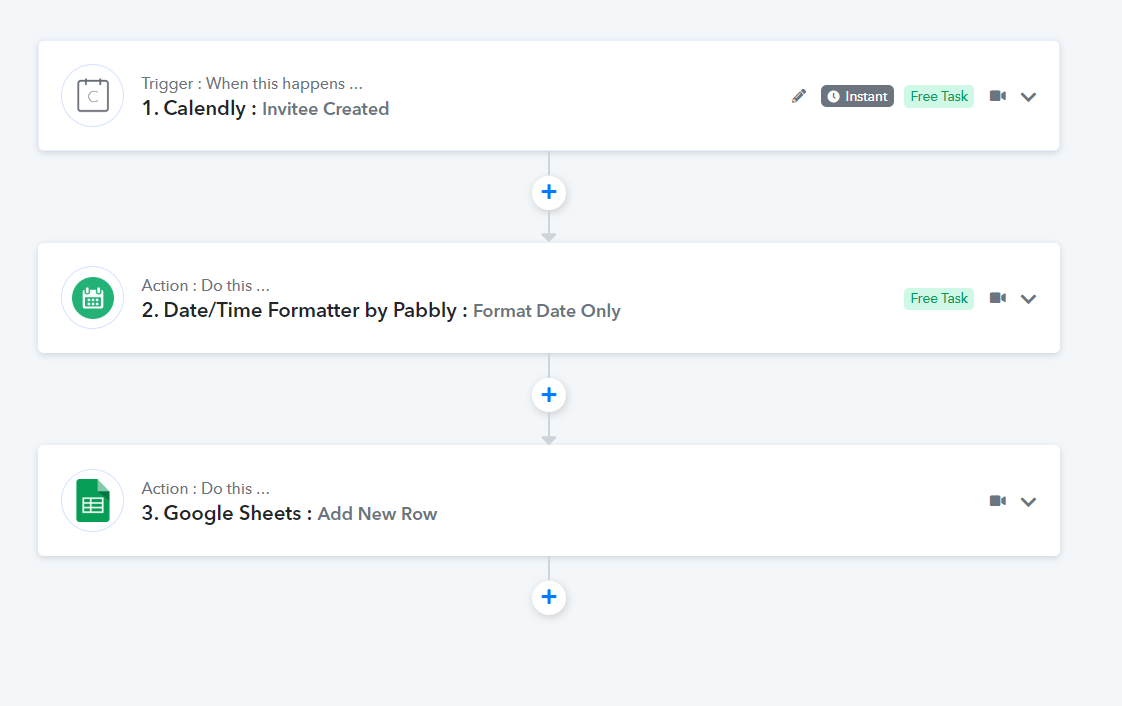

As for the duplicates, this is one of the workflows, again, I have this exact same workflow for 2 different calendars, and 1 is working fine (just creating 1 row), while this one, simply creates 2 rows:

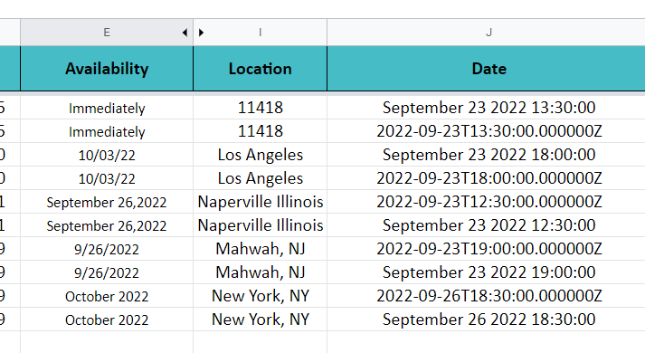

When receiving updates to the google sheet, I noticed the date difference:
so for some reason, every entry comes with a by default date value, as well as the one I formatted it to.

As we can see from your workflow you have set up the date time formatted incorrectly and because of that, it wasn't working correctly.
Though we have corrected it for you and it should work now. Please review your workflow now and let us know if that works for you.

We have made the change in this workflow(MZA Create Google Sheets rows from new scheduled Calendly events ), pelase review that.
And make the changes in your other workflow accordingly.
