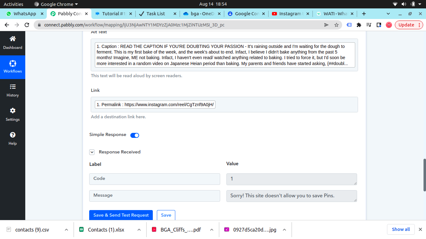

I made a workflow to connect Instagram to pinterest, twitter, linkedin, google mys business.
doesn't show any error for twitter and llinkedin but for Pinterest it shows code 1 error and says " Sorry! This ste doesn't allow you to save Pins!" Please help

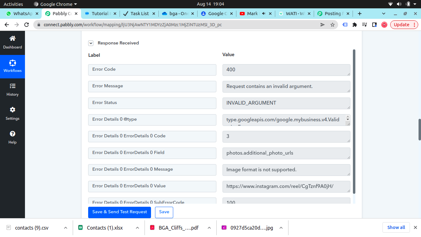

shubhangi

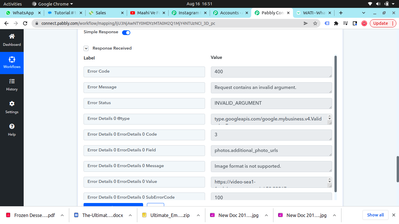

Update: On google my business too it gives an error 400, message- Request contains an invalid argument.
same workflow: https://connect.pabbly.com/workflow...DaVQIADkBFVJWVAIAcwceVlMHGABdUGNUEVEOCiAAYg##
Is it because the latest post was a reel? If that's not possible, is there a way to separate instagram videos from static/ carousel posts?
Also, what about pinterest? That allows videos to be posted, but I am getting the error i mentioned in the beginning of the thread.

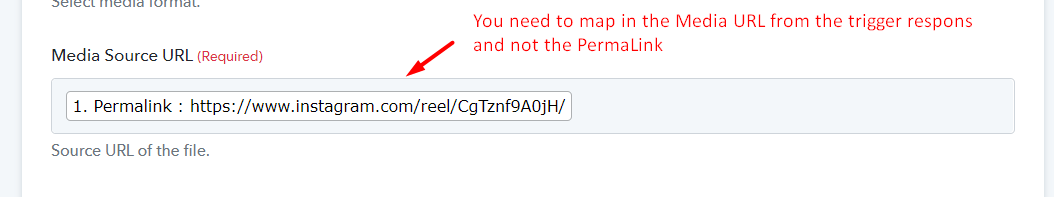

Google My Business concern-
You are entering the incorrect image URL inside the Media Source URL field-
Kindly map in the Media URL from the trigger response and then click on "Save" only.
It will start to work for you.
Do check on the suggested steps and let us know if this works for you now.

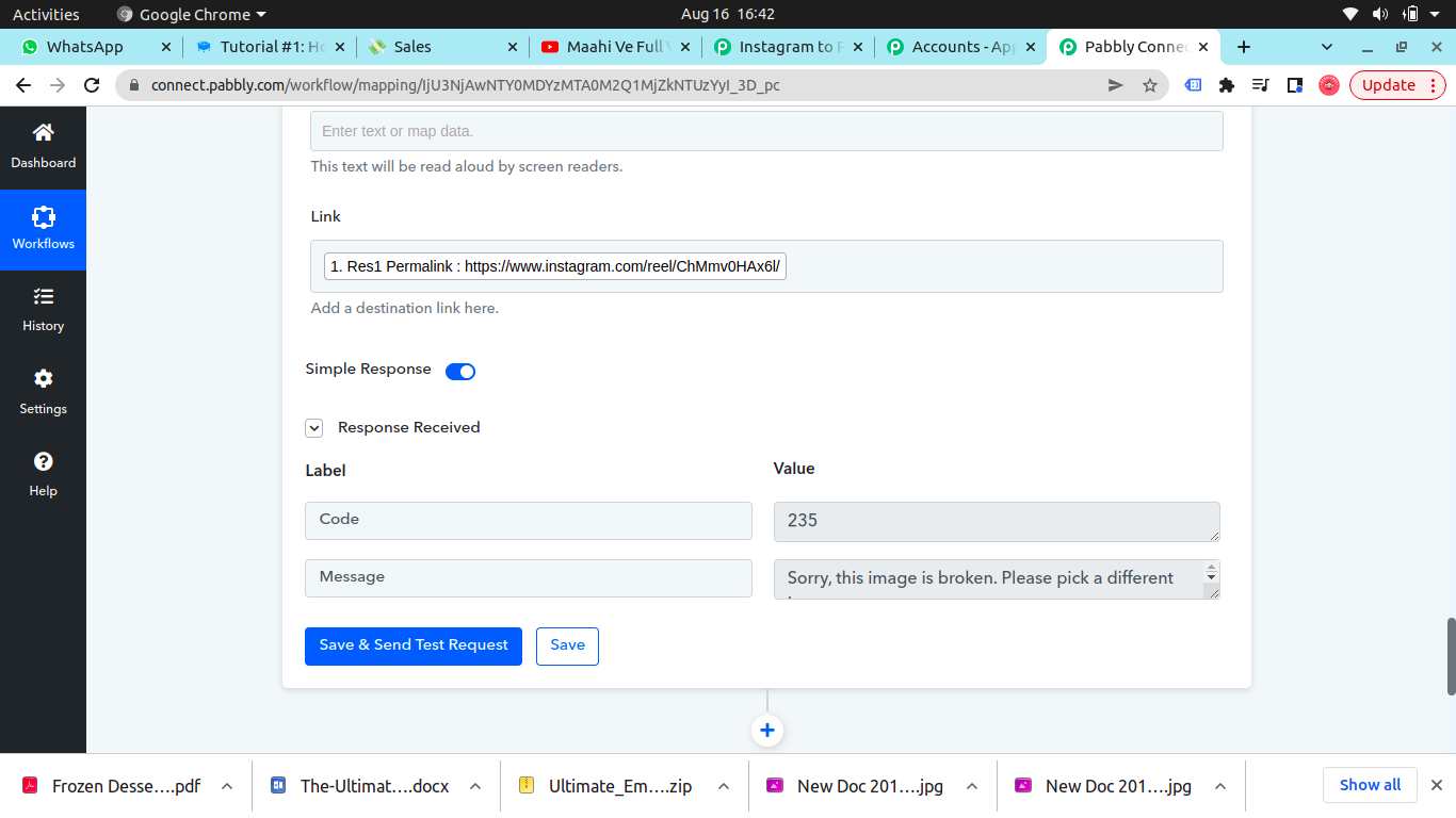

shubhangi

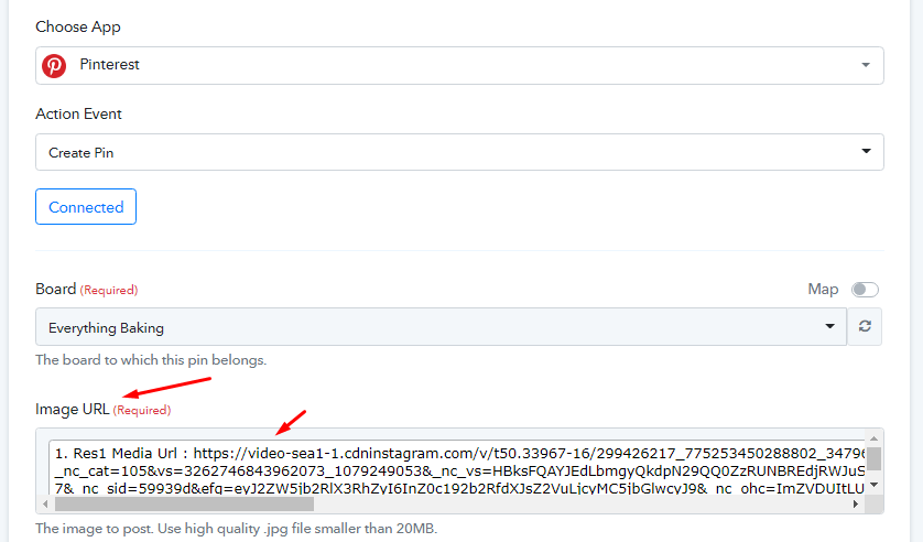

I tried that for Pinterest and it didn't work, even made anew workflow, here's the error-

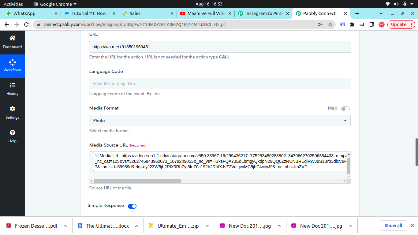

shubhangi
Same for google my business

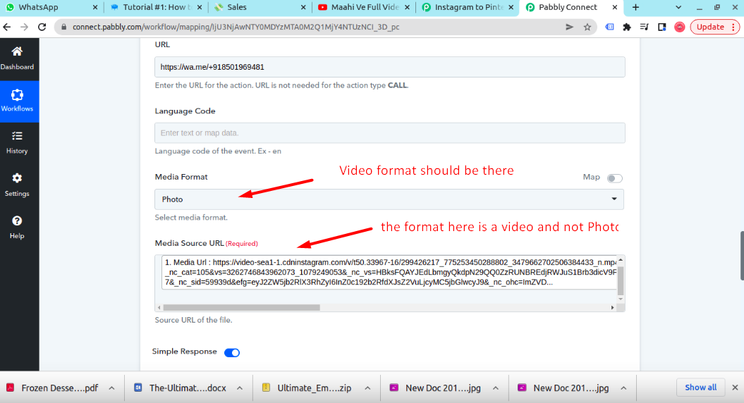

On checking upon your workflow, we can see that you have deleted the step, so we were not able to investigate on it.
But by checking on the screenshot you have sent us, we can see that for the video format, you have passed Photo as the format-
Hope, we have mentioned your query.

About the Google issue, I don't get an option to select video, also what can I do so it automatically selects video/ photo? Plus, I believe GMB doesn't allow videos.

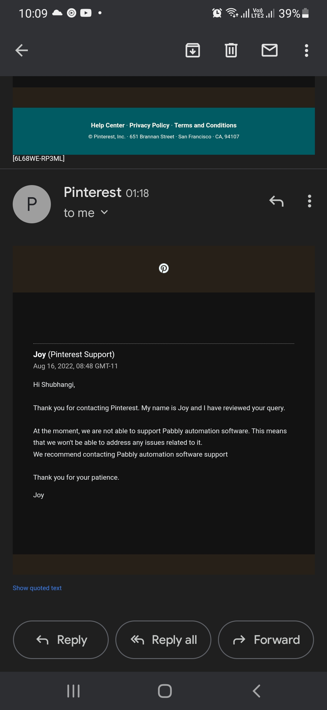

This is the reply I got from Pinterest

Pabbly13
Hey @shubhangi !
For Pinterest, when checking upon your workflow "instagram to pinterest ", we can see that you are trying to pass a video, because of which it didn't work.
We do not have support for Video links for Pinterest at our end, so it will only work when an image URL will be passed.
Kindly do a test submission by adding an image inside your Instagram and then check if its executing in your Pinterest account now.
Hope, to hear from you soon.

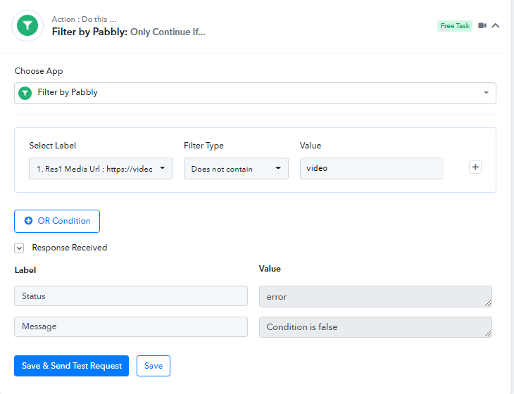

Okay, so for both Google My business and Pinterest, we cannot pass videos, is there a way we can automatically make the workflow work when an image is posted? Like we can filter the posts which are images and not videos and the workflow can post them to GMB and Pinterest?
Pabbly13
Hey @shubhangi !
Kindly use a Filter step after your Instagram by checking on the reference step below-
This step will stop the flow of the video link from forwarding further and will only image url to pass through it.
You can do the same for the Google My Business workflow as well.
Kindly check on this and let us know if this works for you now.
