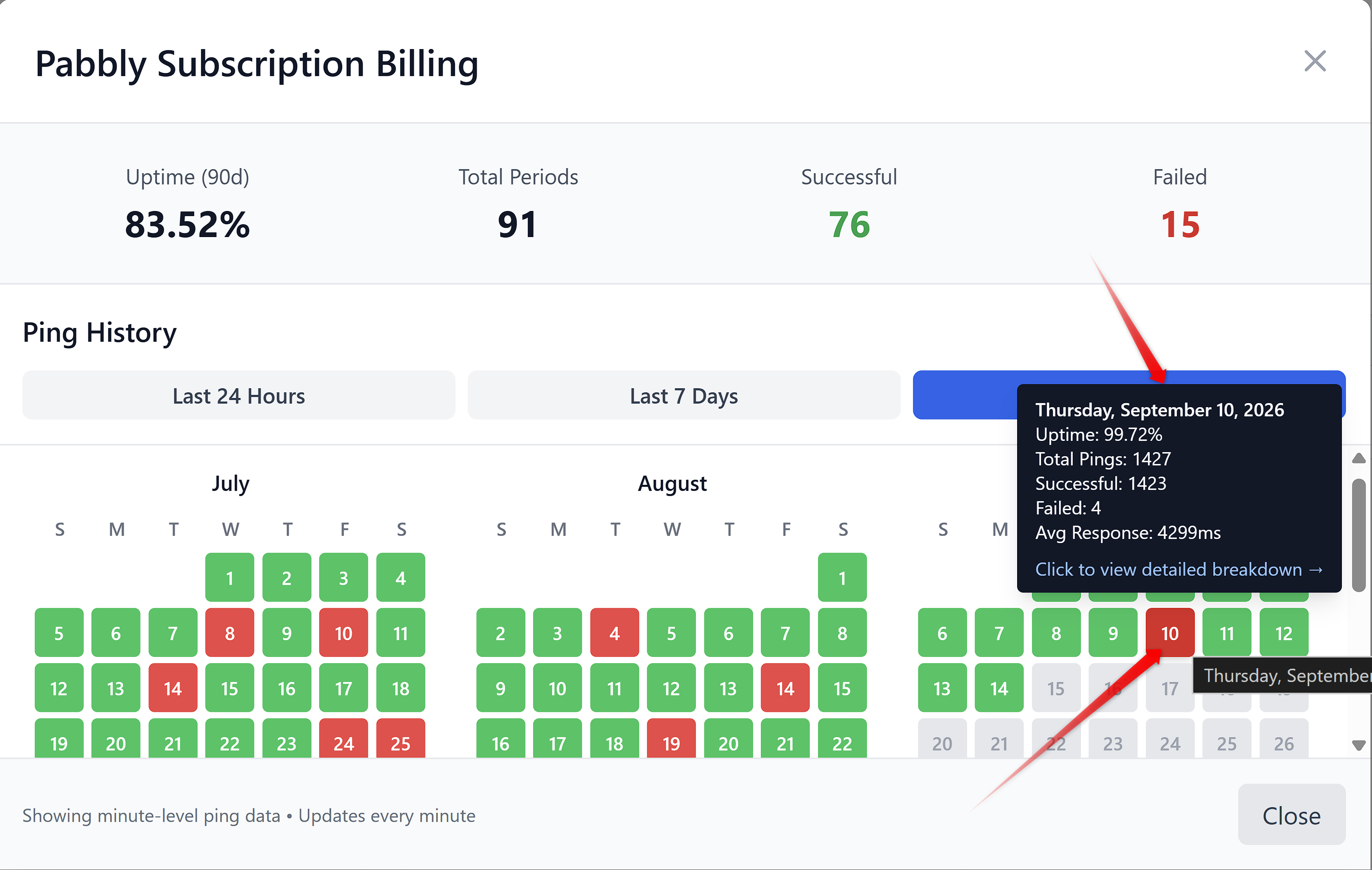

It was a backend database issue due to which the connections to Pabbly Subscription and Billing softwares were not get connected properly. The team has fixed the issue with the database, and it should not occur now.

Pabbly Support — Reply ·
Hello Sven,
There was a downtime occurred on 10th September due to which the API request cannot processed on that day.
Adeel Akhtar
