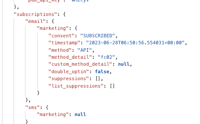

I am able to collect SMS consent from customer via a webform but cannot see how I can pass this to Klaviyo using Pabbly connector in order to change SMS consent from "null" to "SUBSCRIBED". Is there a way to do this via current connector? I have attached a Postman view of that section of the Profile.

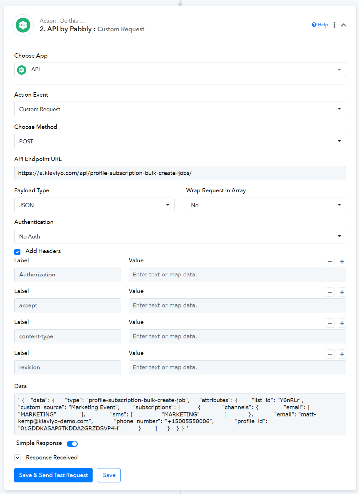

That being the case, what would that API call look like in Pabbly. I'm getting an auth error for starters. https://developers.klaviyo.com/en/reference/subscribe_profiles
This is how it should look, you will have to format the data and map the details.
