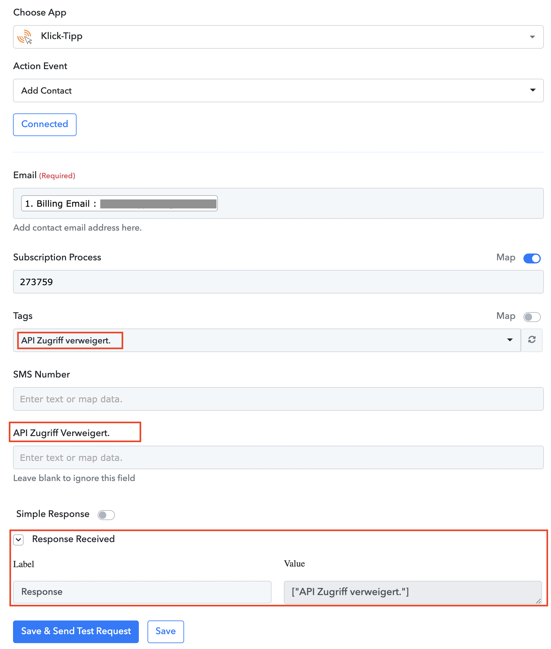

Marcus
Thanks so much for your quick reply @Supreme !
So what I'm trying to accomplish is to send customers that have purchased through Woocommerce as a new contact to Klick-Tipp, including their email, name and value of purchase. I don't really need tags for this use case, but even if I try to leave the field empty, I get an error message.
I cannot see any fields where I could map the name and value fields. And it still seems like there's a api issue since it even shows "api access denied" in the label of the lowest field.
I appreciate your help!
Thank you.
Supreme
Hey @Marcus
As per the API response, your account access is getting denied, so we would recommend you to reconnect the Kilck-Tipp again with new credentials.
And if the issue still persists, then kindly contact Klick-Tipp support team for the same.
