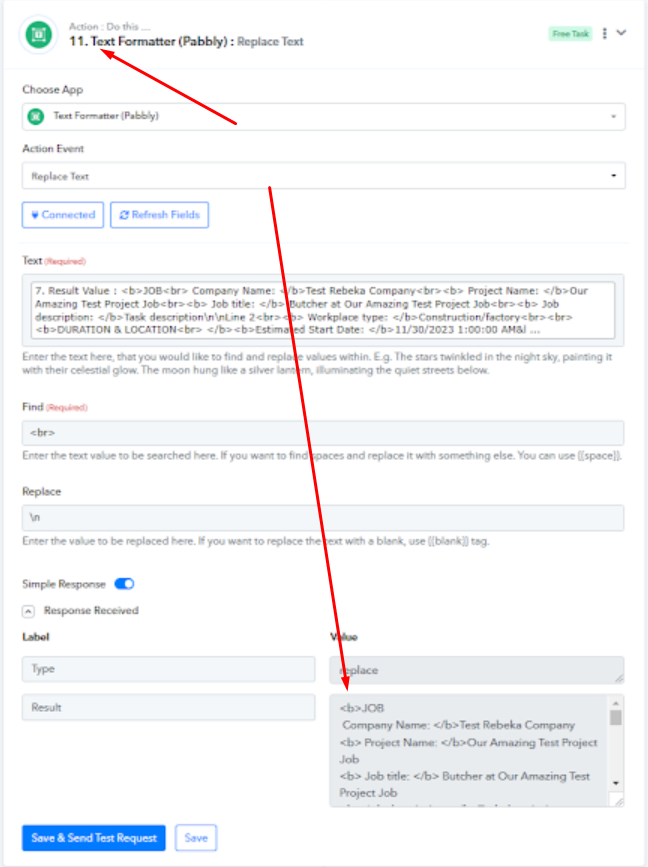

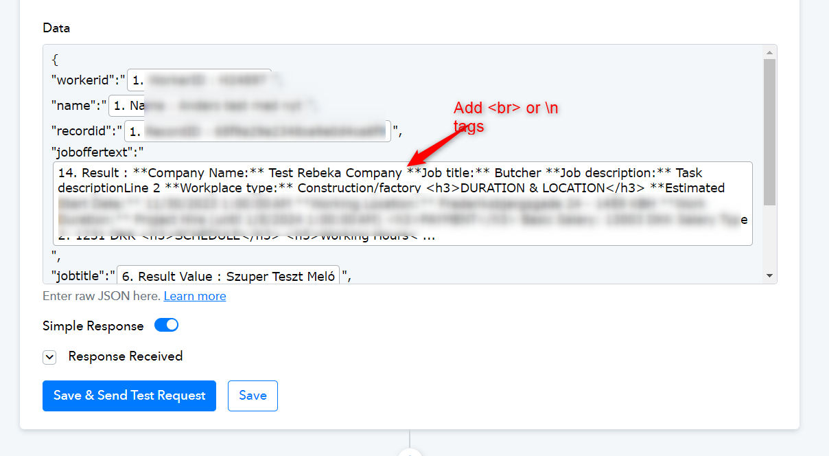

Please check this video. I have an issue with the text not being sent with linebreak. Pabbly strips them away in my markdown.
How can I fix this.

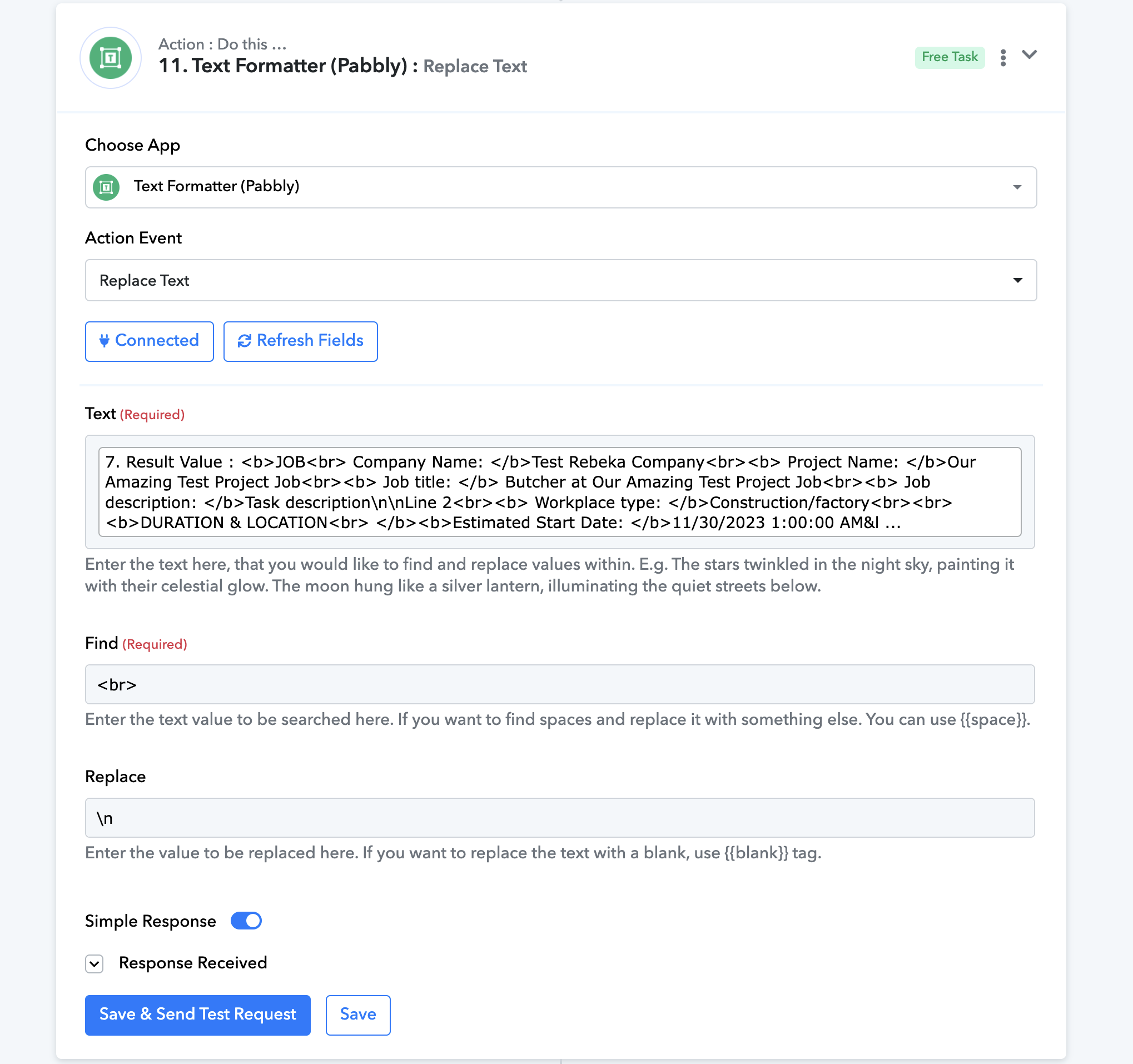

I am replacing <br> with \n in my markdown convert sequence (Pabbly's own HTML to markdown converter is broken as previously reported).
Target app (parallel). The output is fine when I insert the markdown manually but when I sent it using Pabbly alle linebreaks are removed.

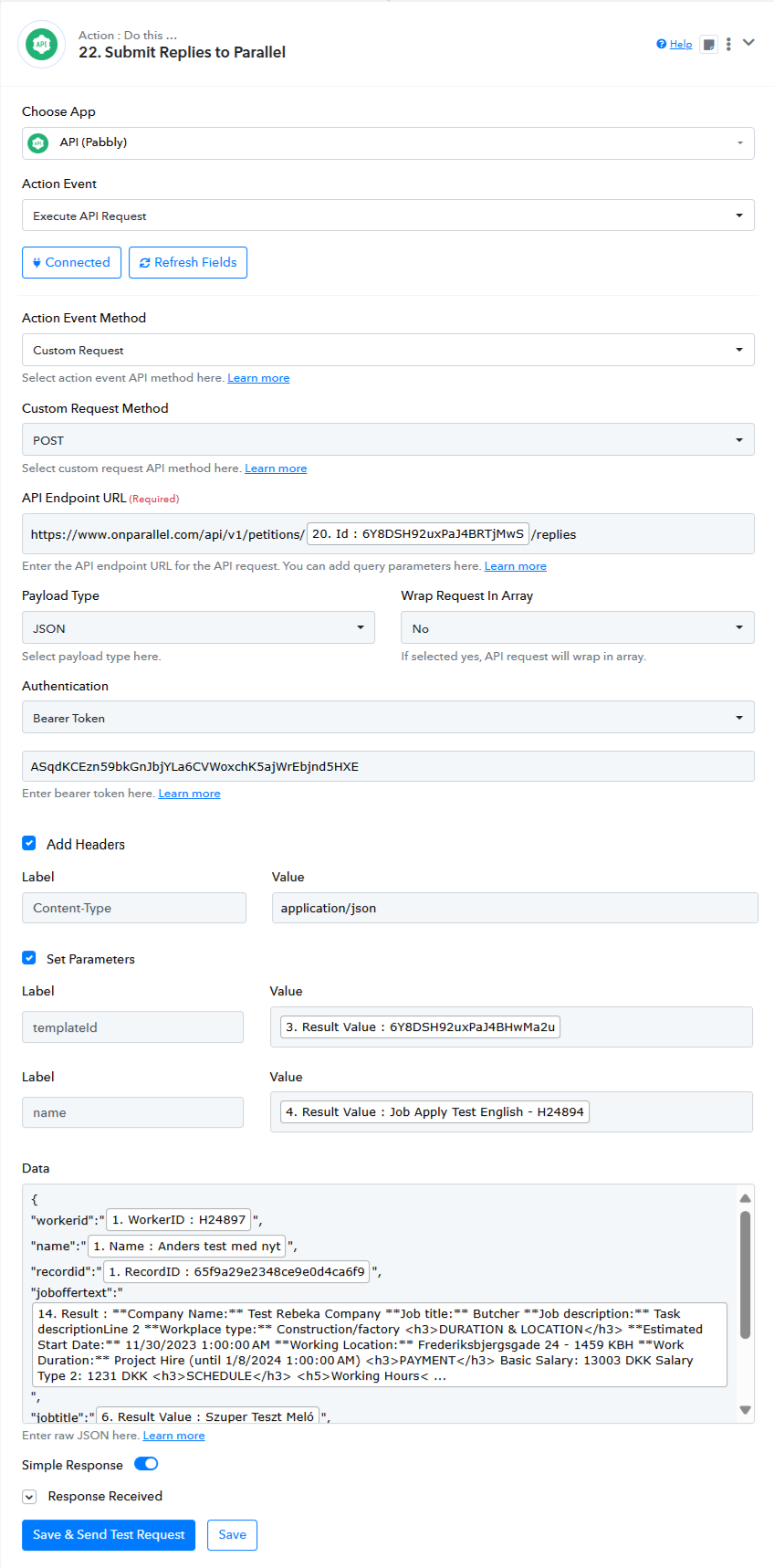

Check this flow please:
And check step 11-18 where I convert the html to markdown and 21 when I submit the output via the API.
The target app receives the data without linebreaks so it looks bad

Hi @apps,
Please try adding <br> or \n tags to your content and see if that helps you get the data to the target application with line breaks.

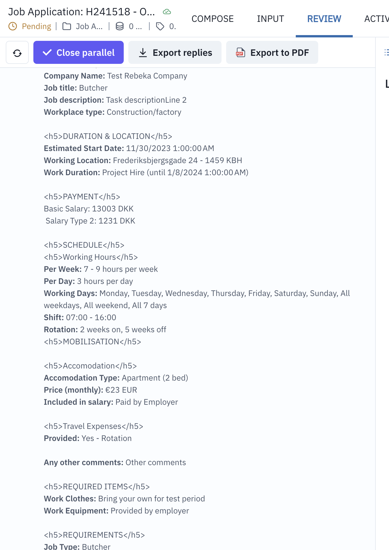

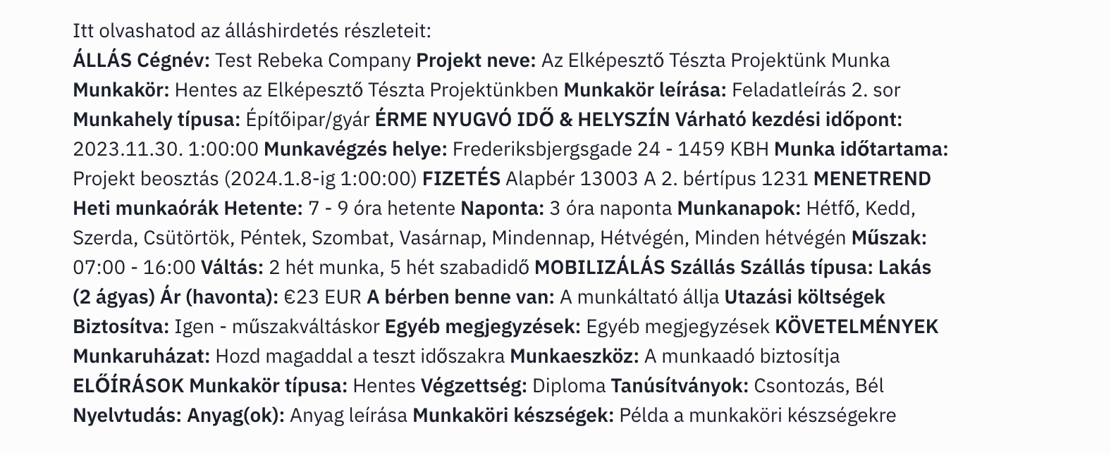

This is how it looks when i paste the result manually when the <br> have been replaced with a linebreak made using a texteditor

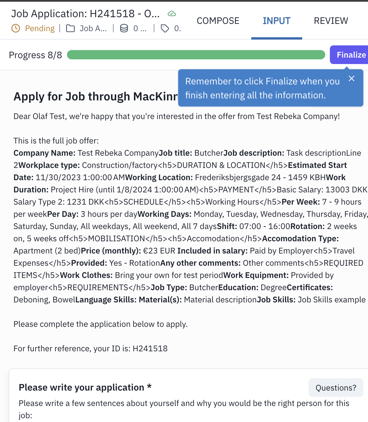

This is how the same looks when the same replacement have happened it Pabbly AND it is sent through Pabbly's API Action. The text is fine after the text replacement of <br> with a linebreak (\n) in Pabbly. It is when it is sent through your API action those linebreaks are stripped away.
It should be quite clear why this output is un-useable these linebreaks are stripped away...
P.S. Ignore the <h5> tags etc.

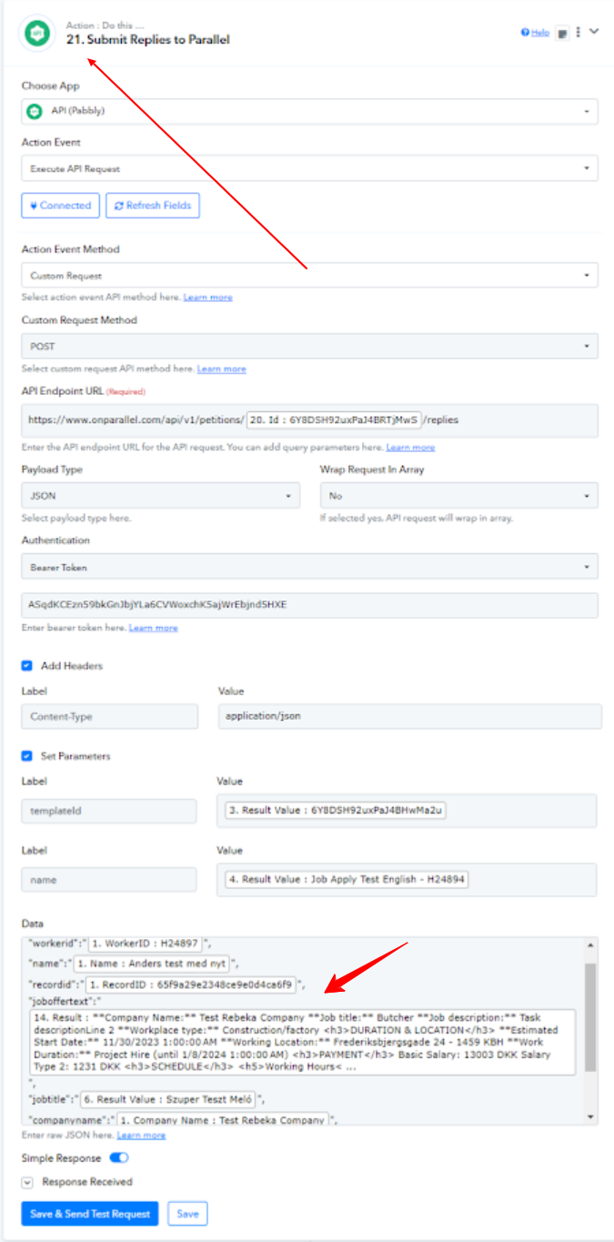

Pabbly13
Hey @apps !
Checking upon your whole workflow, we cannot see that you have used the response of step 11 in step 21 to pass the correct data to your Parellel applications-
Do use the response from 11th step in 21st step and check if you are getting the correct structure or not.
