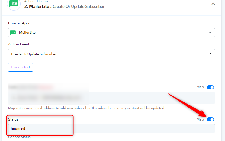

Hey @Sophieja23
Regarding your concern to pass the Status from the Mailerlites' action step then you may map the states statically by toggling the map button.
but if I activate the map button I will have to select a corresponding field?? But there is no such field. Or does it work without selecting a field?
Thanks for your help.
You can instead manually type the status in the field which is available in your Mailerlite account.

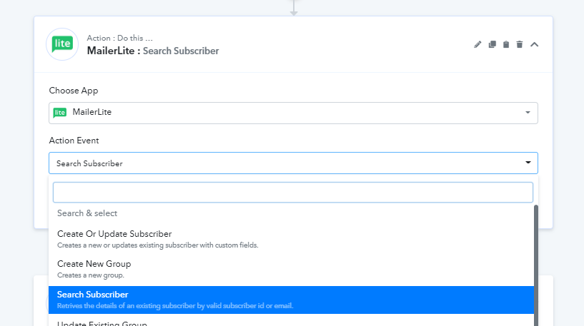

Regarding your concern to achieve such a condition, you can use the "MailerLite: Search Subscriber" action step in your workflow to check the existence of the Subscriber in your MailerLite action step.

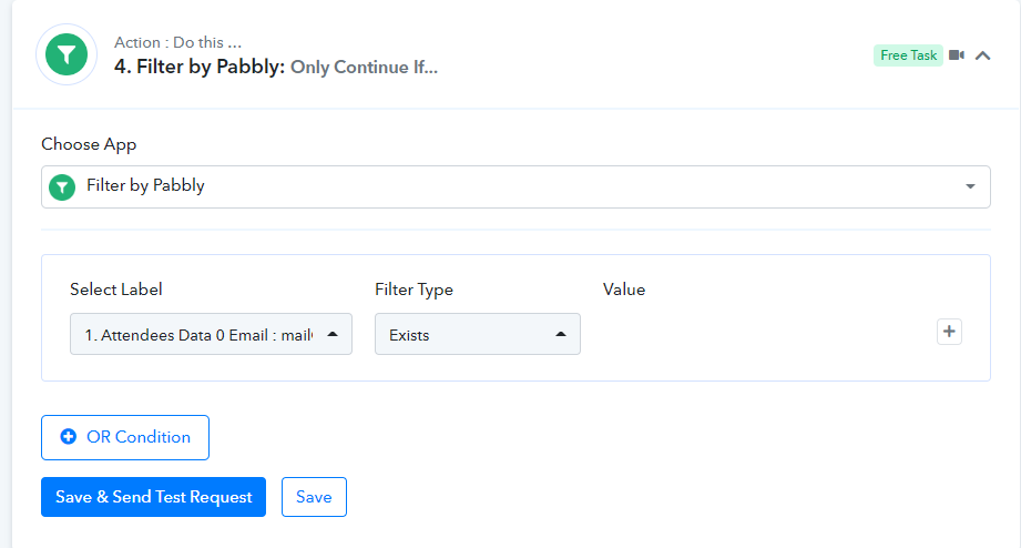

Ok, and this followed by a filter
But there is a part missing - I also need a rule or filter if an email does not exists. It must be something with if... then...
For that, you can use the Router action step for establishing the filter condition for if-else.
Kindly give it a try and let us know if you get stuck at any step.

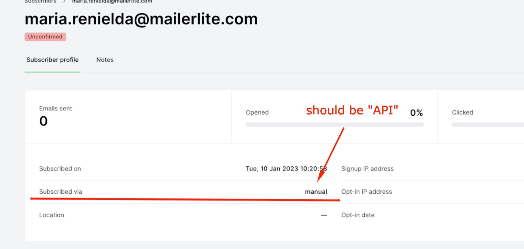

Well, I have to go back to my original problem, which is, that for new subscribers there is no double optin triggered in mailerlite. So I contacted them and they investigated the issue. Today I got this answer:
"After investigating this, it looks like the issue is with the way the Pabbly integration is adding subscribers. For example:
Since it's an integration, the "subscribed via" in the subscriber's profile should say "API", not "manual". So in this case, it's an issue with the integration and you would need to contact them directly as they are the developers of the integration."
I hope, this information is helpful and you could solve this issue as double optin is a big deal in the european area. Please let me know if you need further information from mailerlite.
Thanks a lot. Sophie
We have forwarded your response to our technical team and they are currently looking into it.
Hi, I contacted mailerlite again concerning DOI - which is not triggered. They answerd me:
"Kindly let them know it should be "Unconfirmed" however, please inform them that the main issue is how the subscribers are being added. So regardless if they set it as "unconfirmed" but if the subscribers are still being deleted as added 'manually', the DOI would still not be sent out. So the main thing they need to check is how they are being added and make sure that they indicate it's being added via "API"."
