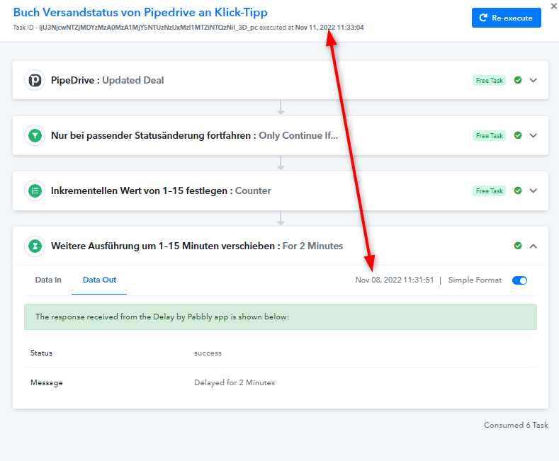

Well, I checked the task and email is not missing. When I open the task history (linked with the task history ID above) to have a look, if the email address may be empty or so, I realize that there are no more entries in the task history.
There is a delay in the workflow before the task. The delay is the last entry in the task history. So I cannot check what's wrong.
What am I doing wrong? Is there another place where I can find the "rest of the history"?

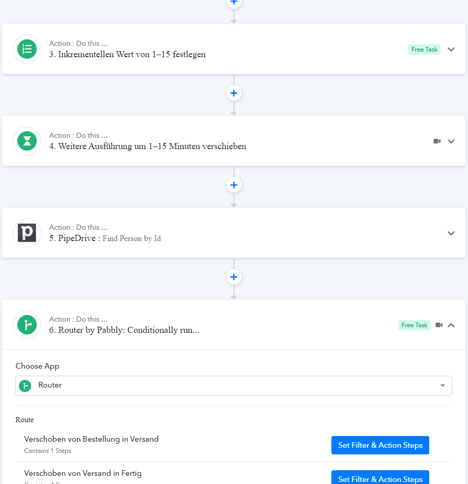

The "Delay Until" action step should have delayed all following actions for 2 minutes. This seems to happen as supposed. It ran on Nov 8 at 11:31:51 and waited for 1-2 minutes, which results in the time at the top – "11:33:04".
The date at the top, Nov 11, would be the result of a much later step. There are some steps following this 4th step, including a router. The last route contains another "Delay Until", which delays for 3 days. Therefor the result date at the top is Nov 11 / 11:33:04.
What I am missing are all steps from #5 in the history. The error, this email is talking about, occurs in one of these later steps. But I cannot check it, since I can't find this step in the history.
