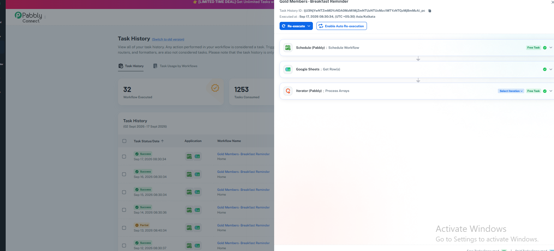

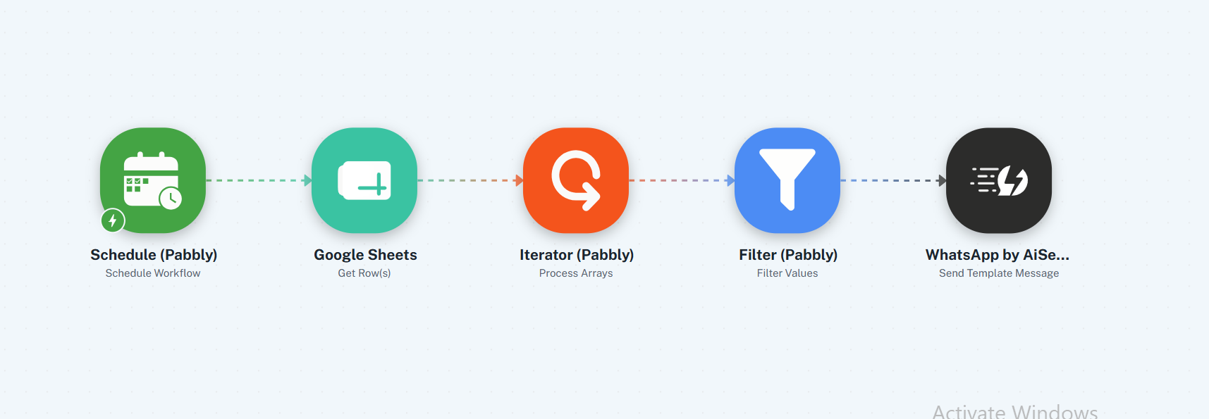

my workflows are not working as per the setup the msgs are sending in correct time msgs and some of are not working well.

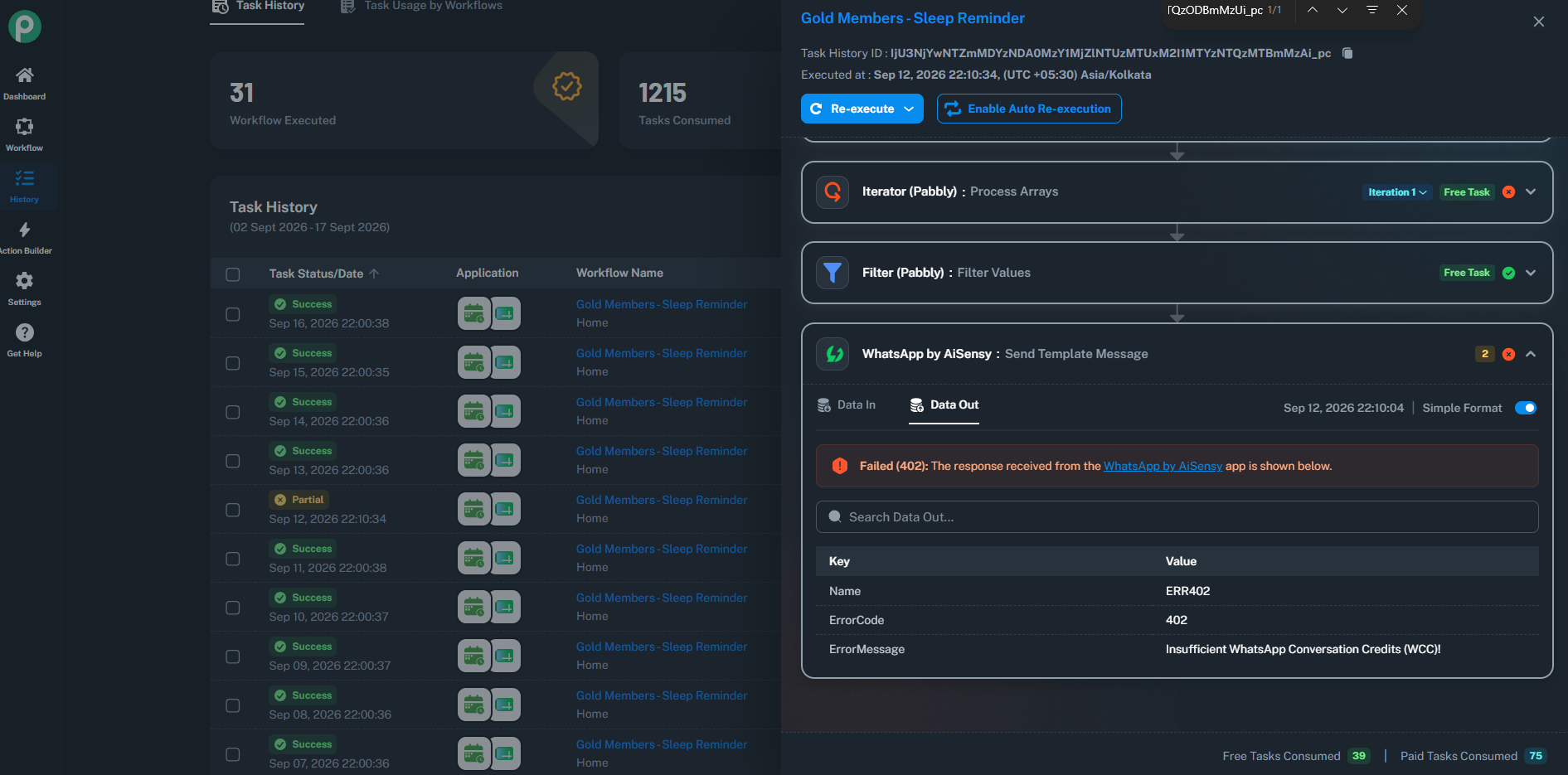

We also checked the Task History for the failed execution and found the following error:
Error Code: 402
Error: Insufficient WhatsApp Conversation Credits (WCC)
