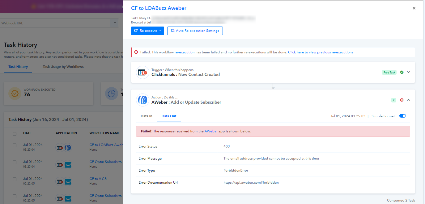

None of Aweber API Workflows are working.
Hello, I created few Aweber workflows in my pabbly connect account so that an email can be copied to my different Aweber accounts through API, but none of them are working. Earlier they were working fine, but since yesterday night they are not working. I tried without pabbly connect in my clickfunnels funnel, then it is working fine. I thought problem with Aweber API and tried to test without Pabbly in my clickfunnels and then it is working fine, so there is no issue with Aweber API. Please help me. It's urgent.

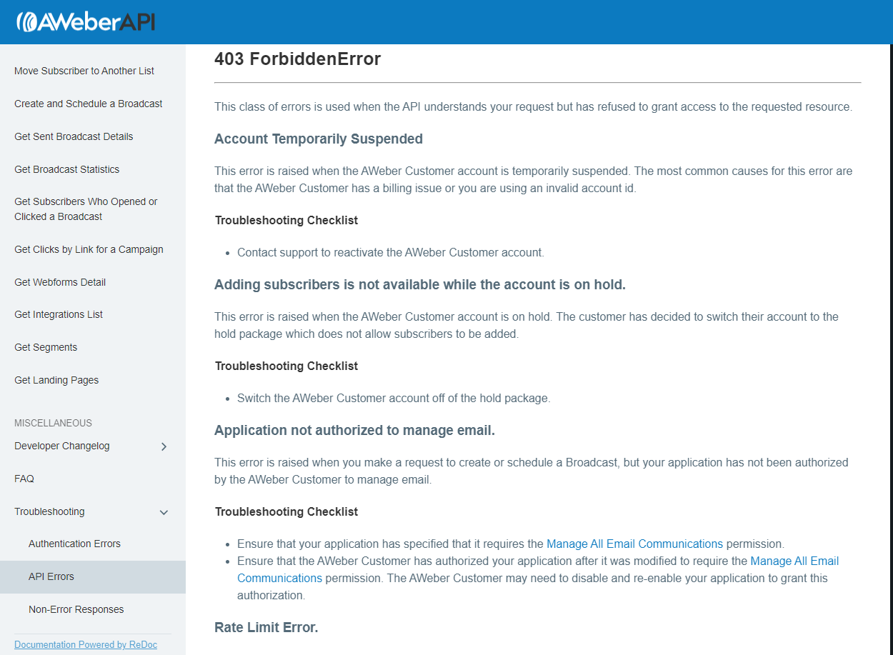

Upon looking into your issue it appears that your workflows are failing due to 403 forbidden error.
The 403 forbidden error can be due to various reasons. Please refer to this link where this error is described as per the Aweber API - https://api.aweber.com/#forbidden
Kindly refer to the instructions and take the troubleshooting measures.

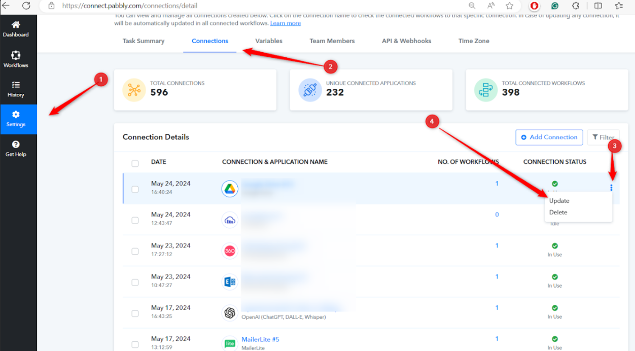

Also, after you make the changes, kindly update your Aweber connection inside Pabbly Connect. Refer to the image below for more instructions.
