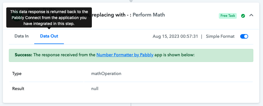

Number formatter is returning a null result when using the 'make negative' function.
this is for action step
'Removes all leading zeros, replacing with - : Perform Math'​

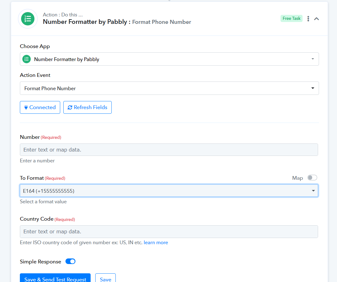

As we can see from your workflow to get the desired number you are actually using 3 steps which you could be done with the Number Formatter action step.

The workflow works really well, its just this step:
Sometimes returns a null result
All input data to this step looks fine, not sure why it's returning a null result

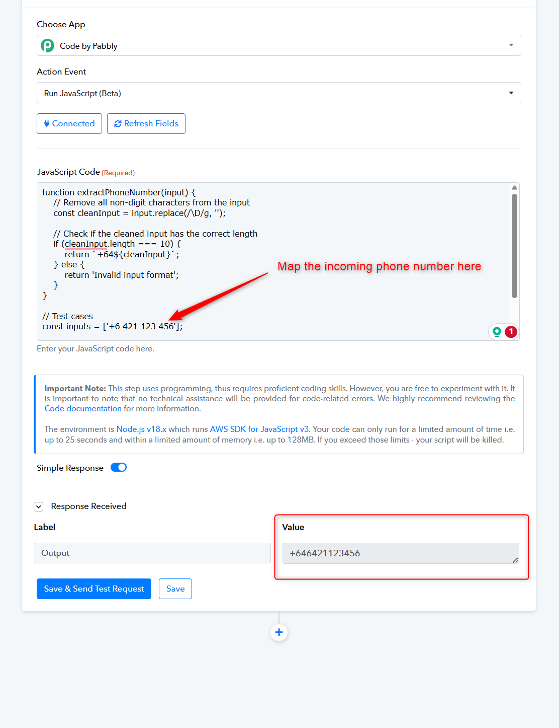

You can make use of the Code by Pabbly action step and with the help of JS code you can get the phone number in the desired format.
function extractPhoneNumber(input) { // Remove all non-digit characters from the input const cleanInput = input.replace(/\D/g, ''); // Check if the cleaned input has the correct length if (cleanInput.length === 10) { return `The number we want is +64${cleanInput}`; } else { return 'Invalid input format'; } } // Test cases const inputs = ['+6 421 123 456']; for (const input of inputs) { const result = extractPhoneNumber(input); return(result); }

You may use the Number Formatter action step which will accept all the incorrect formatted numbers which have been given.

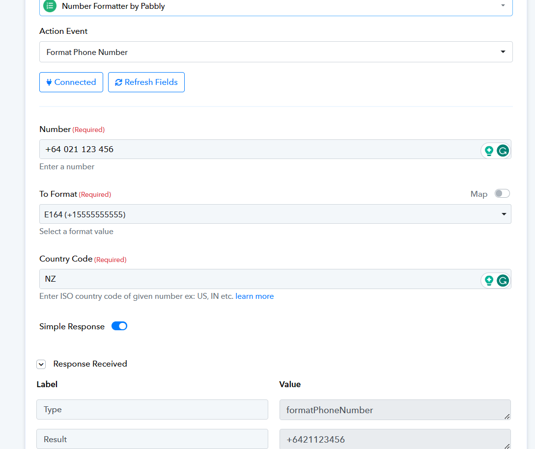

We have checked all the numbers and it is not showing a null response in the Number Formatter action step.

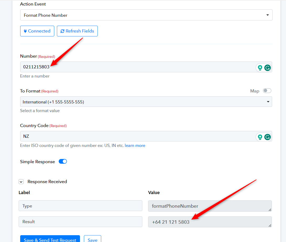

If you enter in a number starting with zero (eg 0211215803)
it returns the same number (with a zero) but with spaces
We need every number to start with +64 and contain no spaces.

The number formatter step does not work.
Can you check the following screenshot and confirm the issue?
