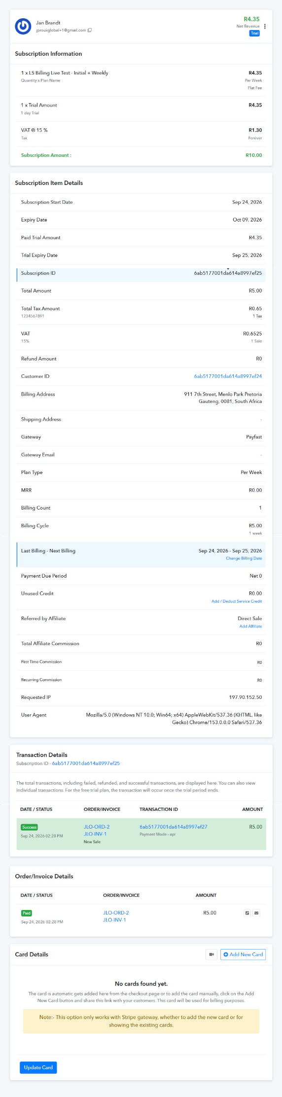

Pabbly subscription ID: 6ab5177001da614a8997ef25
Test configuration:
  • - Paid trial: R4.35 + 15% VAT = R5 for one day.
  • - Recurring payment: R5 including VAT weekly.
  • - Pabbly shows the next payment due on 25 September 2026.

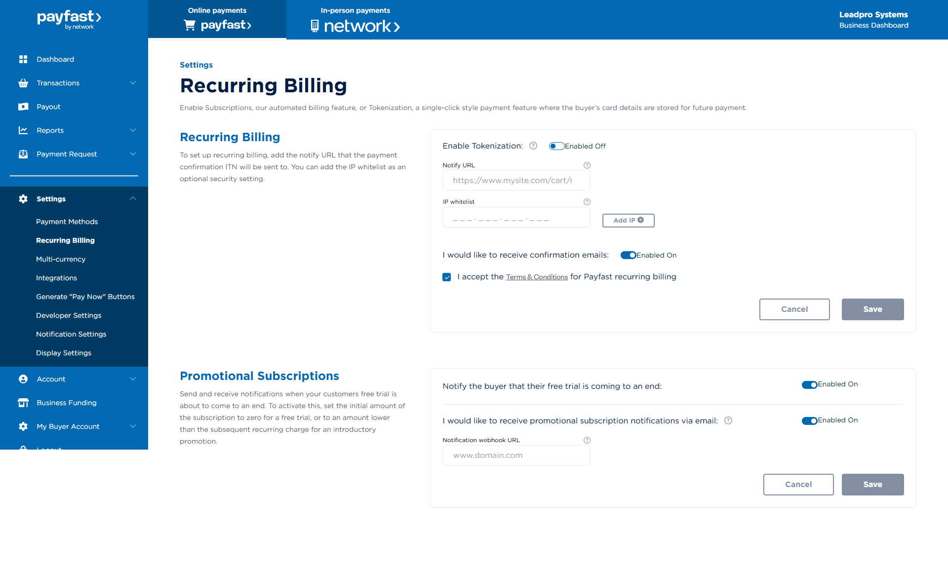

However, no matching subscription appears in Payfast’s Customer Subscriptions, and no ad hoc agreement is visible. Payfast’s “Enable Tokenization” setting is currently OFF.

Pabbly’s Payfast configuration only shows Merchant ID and Merchant Key, with no passphrase field. Please explain how any required passphrase is handled.
I’ve attached the Pabbly subscription and Payfast settings screenshots.
Please provide exact setup instructions for this integration.

An update for the specialists investigating this:
  • Subscription ID: 6ab5177001da614a8997ef25
  • Product/plan: LS Billing Live Test – Initial + Weekly
  • Initial R5.00 payment succeeded on 24 September 2026; invoice JLO-INV-1 is paid.
  • The one-day paid trial ended on 25 September. Renewal order JLO-ORD-3 for R5.00 is now Pending, and Pabbly sent overdue emails.
  • As of 26 September, the subscription shows Pending, with only the initial payment listed as successful.
  • No matching customer subscription or ad-hoc agreement appears in Payfast.

The payment appears in PayFast Online Transaction History. I checked Transactions → Customer Subscriptions with Status set to All; there is no new subscription. Reports → Customer Saved Cards says, “You do not have any tokenization agreements yet.” Under Settings → Recurring Billing, tokenization is Off and the Notify URL is blank.
Please trace payment 330608763 and confirm whether this Pabbly checkout requested a PayFast subscription or tokenization agreement. Does Pabbly’s native PayFast integration support automatic monthly card charges? If so, please give the exact settings we must change in both accounts and tell us where the agreement should appear. If renewals instead require the customer to pay each invoice manually, please confirm that explicitly.
