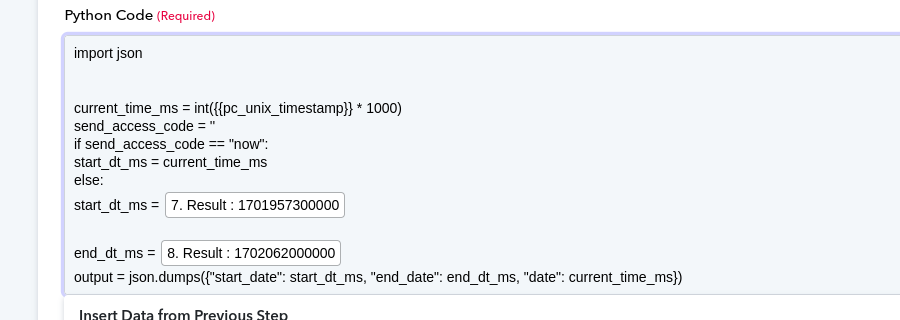

Ignore above code. I have very very small python code now. As per your recommendation, I split my python into chunks of small codes. The below given code is copied from the python text editor. I also attached screenshot of the same source code. The below code is working pretty well so we do't need need to run in the other online python editor. I still don't have answer why the Pabbly python text editor breaks source code indentation. Do you have any solution on it? I will close this ticket immediately once you provide me the solution.
Here is the recorded video for the same issue.
