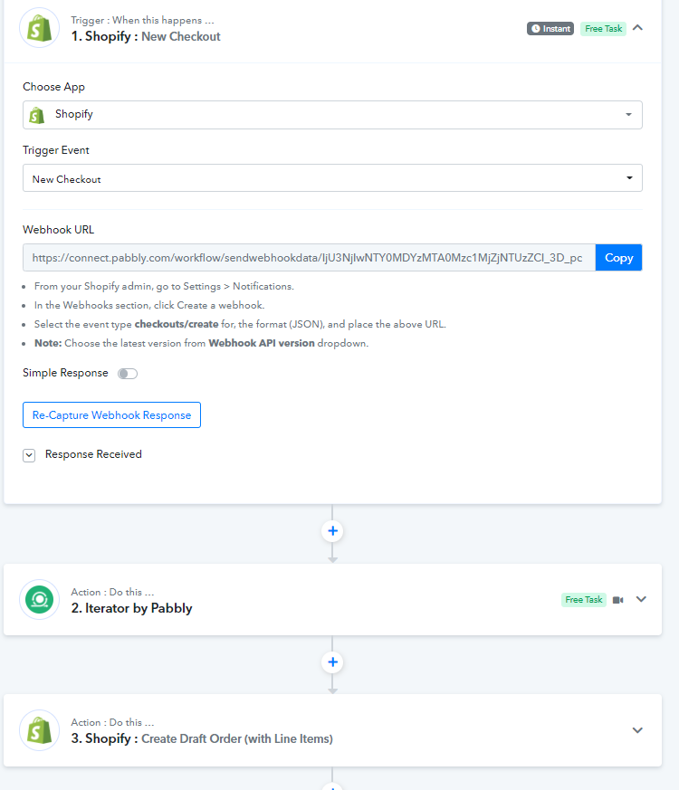

Ok Thank you. I used the Iterator and did a test with an order that has 4 items. Instead of creating a draft order with 4 line items, it created a separate draft order for each line item. Below is the flow I created:

Hey @Hani
Kindly use the "Line Itemizer" action step in place of the Iterator action step which will provide the line item in a comma-separated manner.
